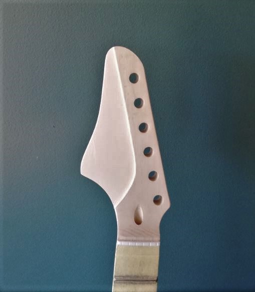

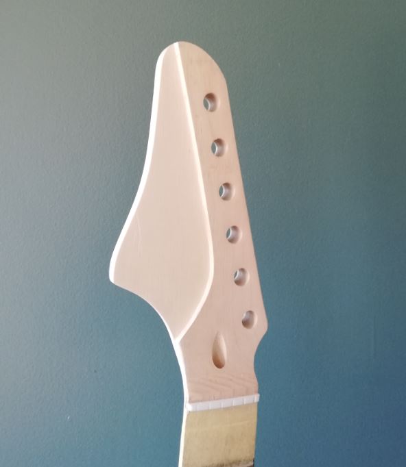

    Took some time to mentally prepare to do the headstock. I did not want it to look off... But I had this idea of lowering one part of the headstock... I thought: Nah Rolf don't be so stupid, what if you make a mistake with the router... But what if you don't?!
    I did not! Happy with the result.

    That's pretty radical Rolf! (maybe you need to change your user name! "RadicalRolf"!)
    I'm too much of a traditionalist to try something like that, but it looks cool.
    Yeah that's neat. I'm a fan of wierdo headstocks

    Haha Thank you @McCreed, to me radical would be leaving out the whole side "wing", I could never do that... Way to traditional for that.
    And Thanks @Sonic Mountain, I guess weird is good, on going topic in my life.
    I never really got the Telecaster headstock shape, but in saying that, shaping a headstock yourself, you come to realize how hard it is to not make it look funky and off.
