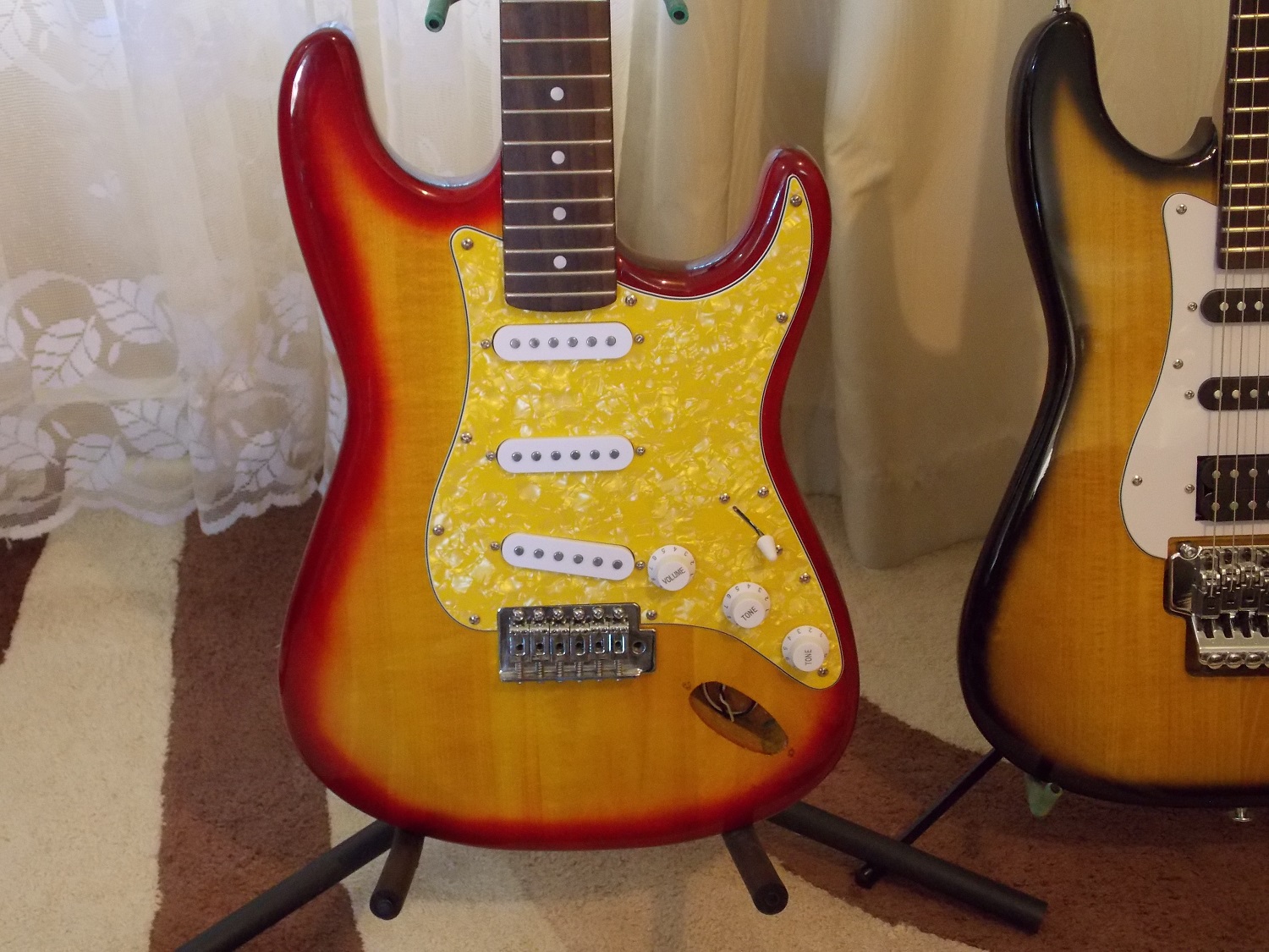

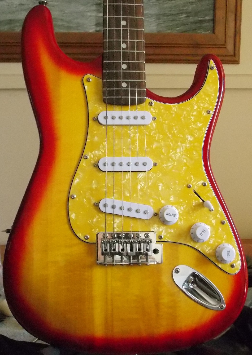

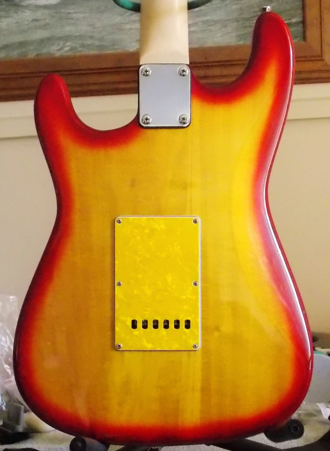

    Cheers guys did a bit of a polish and assembled it reasonably happy with it, have also done a quick video on it but i'm not great on the video thing as its the 1st video i have ever done so sorry for it being terrible

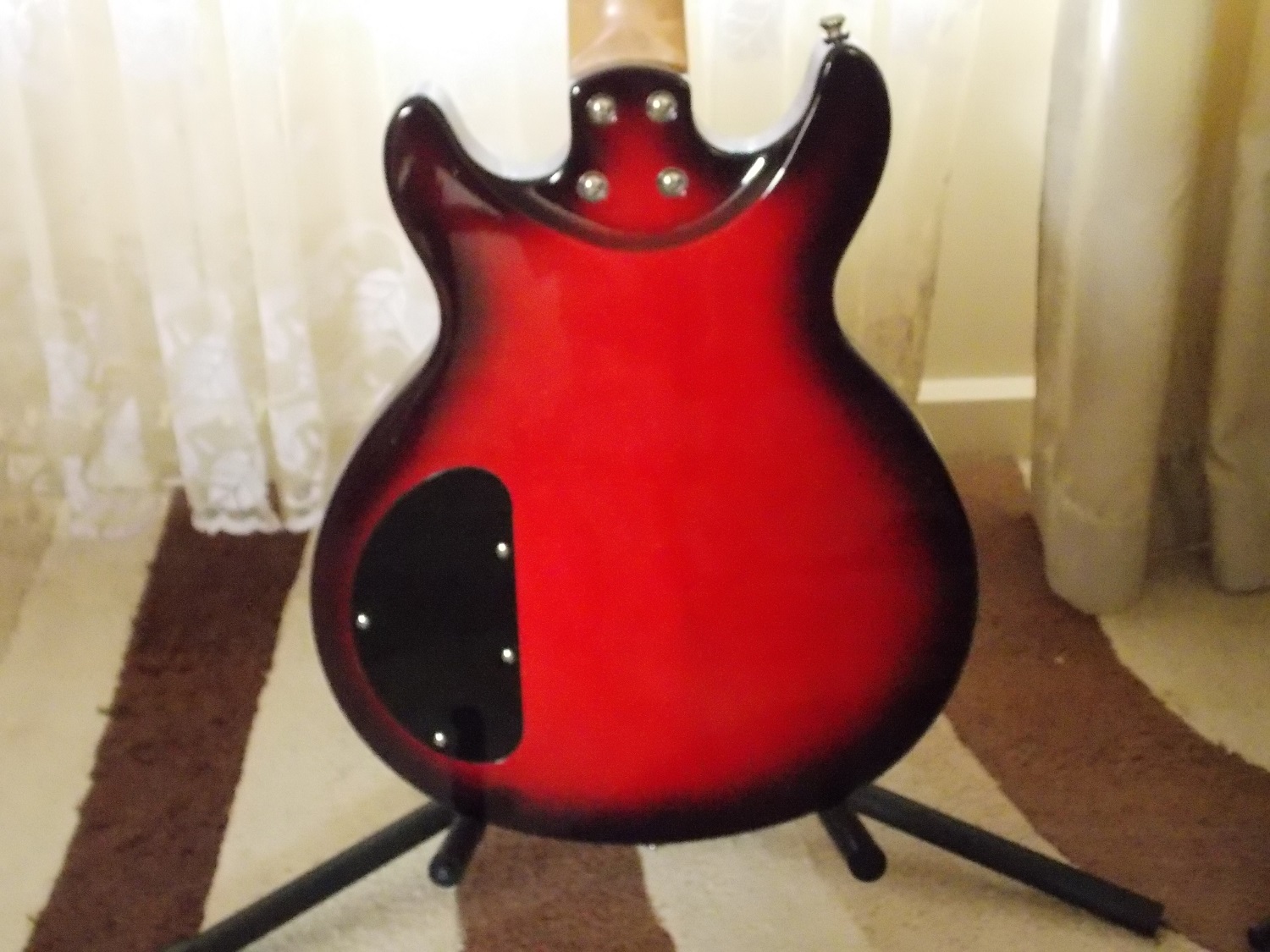

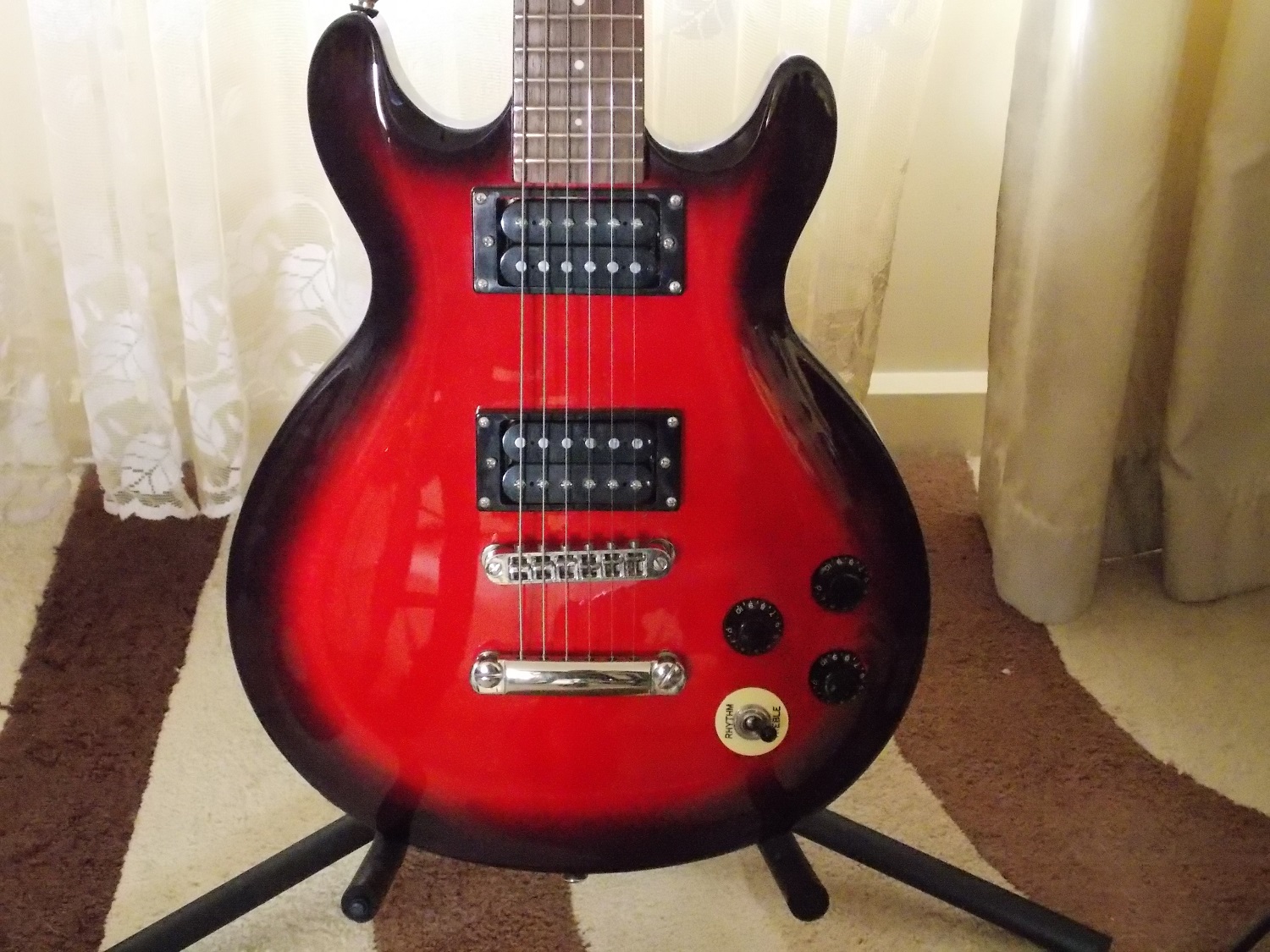

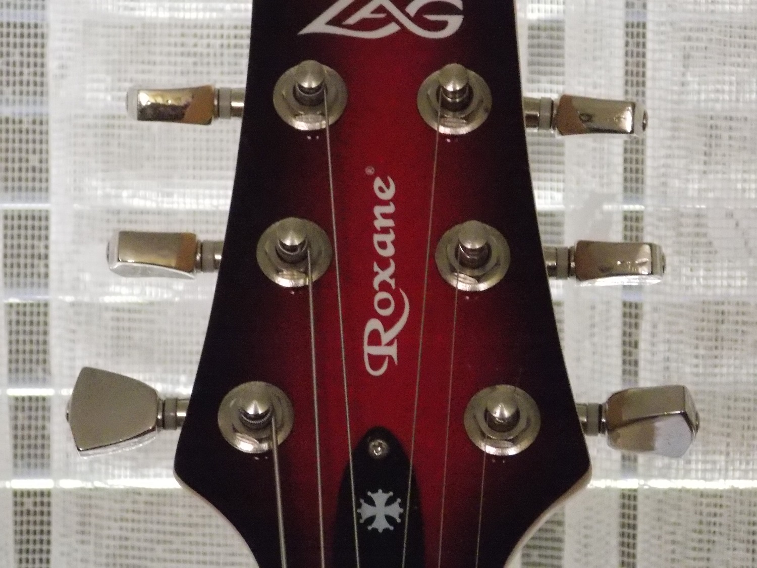

    hey guys i got a new project wile i wait for PBG to get some stock, i picked up a Lag Roxanne on gumtree its a spewie red and black paint job i didn't have any idea who lag where but apparently there a guitar company in France so i got it with peavy backstage amp and a decent gig bag for $100 all up, once i got it home and played it i fell in love with it would be the best playing guitar i have ever owed so she going to be a keeper as its got humbuckers and will replace my Les paul which is hard to get a balance with it in a chair. Here some pic's of it have started stripping the paint i will video this build so peeps can see how i paint them although this is going to be done in a stain
