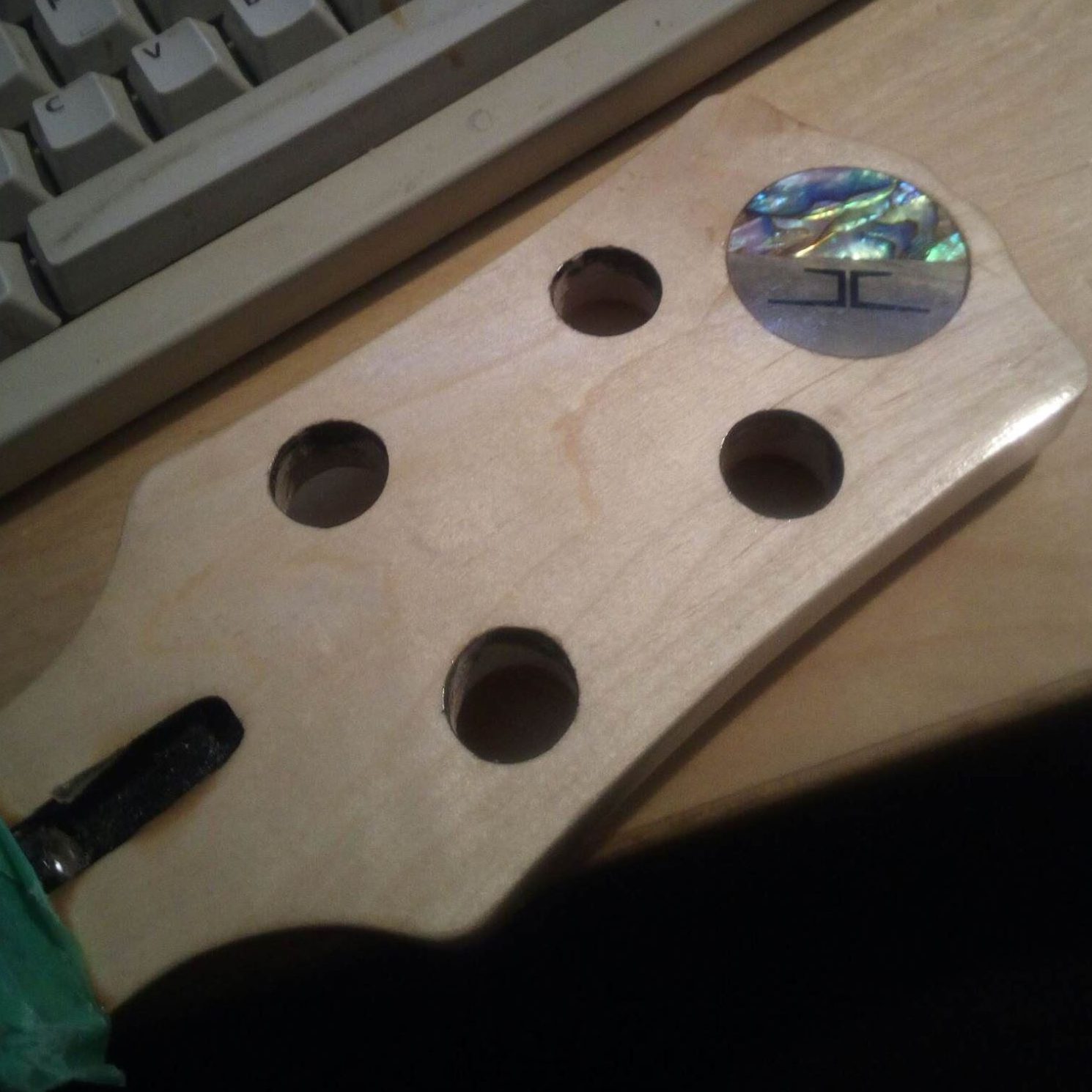

    Whilst waiting for the opportunity to go and do some pickup routing have been adding more coats of tru-oil and sealer filler where that seems indicated. My headstock decor seems to be acceptable. A recessed combination of abalone, veneer and transfer covered by more layers of sealer filler than you'd believe to bring it up level.
    Tip if doing that sort of thing, if you put the sealer filler on too thick it will wrinkle while drying. Don't worry about it. Let it cure thoroughly, and add more. The wrinkles don't seem to show once you've got it high enough to sand flat.

    That is very cool. Love the tree-of-life-J-C logo.

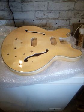

    Routing anxiety - the feeling of trepidation when first attacking a pristine piece of wood with a potentially destructive power tool...

    Crossing fingers...
    Next on the fear and loathing in southern england list is gluing the neck in place. Or shall I splash on a lot more Tru oil before I get to that?
