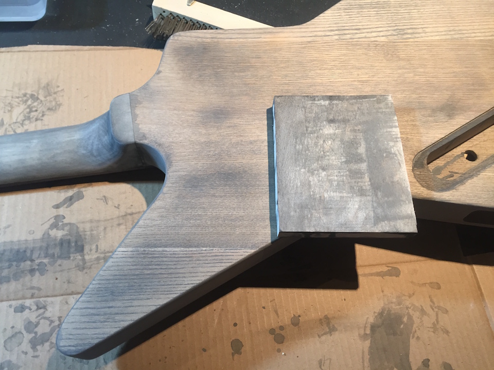

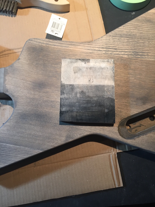

    Okay so i've not done a lot just lately mainly due to time constraints, such is working for a living.
    The Beta batch of 1/2 strength DT Black Stump turned up about a week ago, i hadn't done anything with it and was going to but then remembered the warnings of a few others that there may be a huge disparity in colour between body and neck as neck was naked white Maple and the body a more earthy toned Ash.
    With this in mind, I set about mixing up a series of varying light washes of india ink and water. (From the Bottom, Straight, 75%, 50% and then roughly 25%)

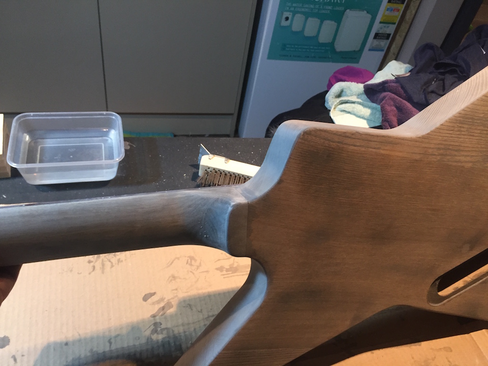

    AT this point I began to wonder if it was such a good idea, but i didn't want to end up with the neck and body being completely disparate in colour so I persisted, it ended up being a fairly loose ratio of 1 drop india ink to 2Mls water)

    What i have ended up with is a fairly close base grey colour across both the neck& head which more or less matches the timber mated body. Hopefully this gives me enough of a match to let the DT appear even across the whole unit.

    There are a couple of little glue spot issues to fix but on the whole, reasonably satisfied. At least until I get the DT on it and see what happens next!

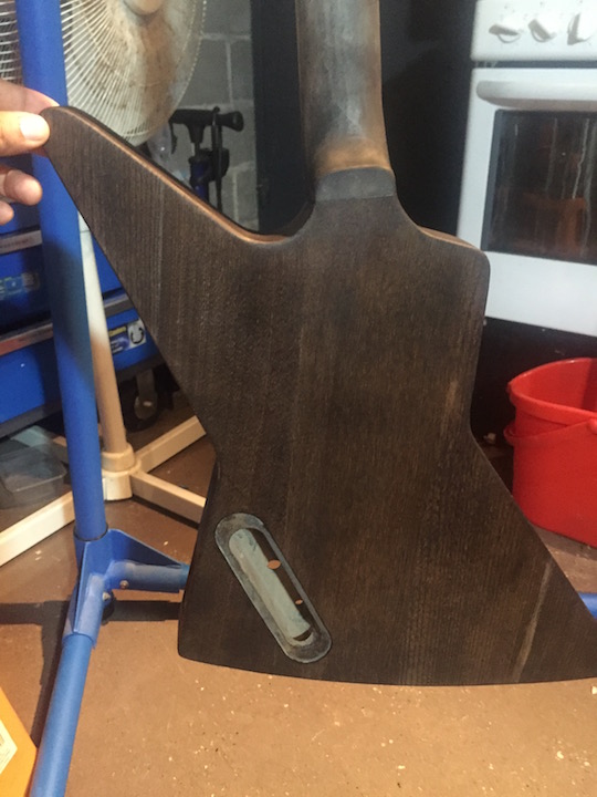

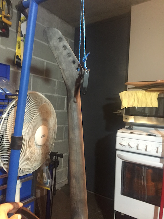

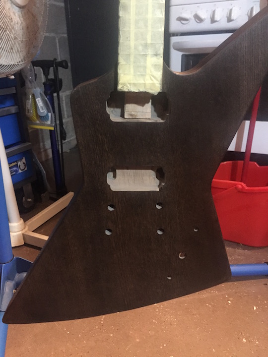

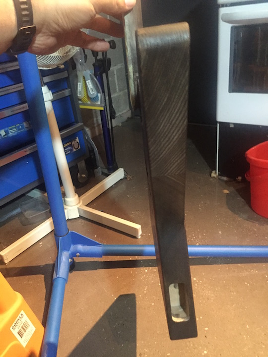

ID:	10026 Click image for larger version.
ID:	10027 Click image for larger version.
ID:	10029 Click image for larger version.
    There's a couple of odd bits I thought i'd dealt with:
    - the Glue line on the back, nope says mr DT.
    - the colour difference between maple neck and ash body, but i will hit the neck again to see if this will darken up some more.
    So I'm just letting it hang to dry out. The weather in Sydney town is not ideal but so far, so good. When i have left it the 3-4 days between coats, there are no sticky patches and not damp spots it all feels dry to touch, there are a couple of almost "Fuzzy" patches that i am guessing could use some 0000 steel wool attention, but other than that, reasonably happy with the DT. Just gotta let it dry properly and then look for a low humidity day for the first finish coat.
    Still tossing up whether to go with a spray acrylic, but I figure i'll probably stay the course with the DT for the experience.
