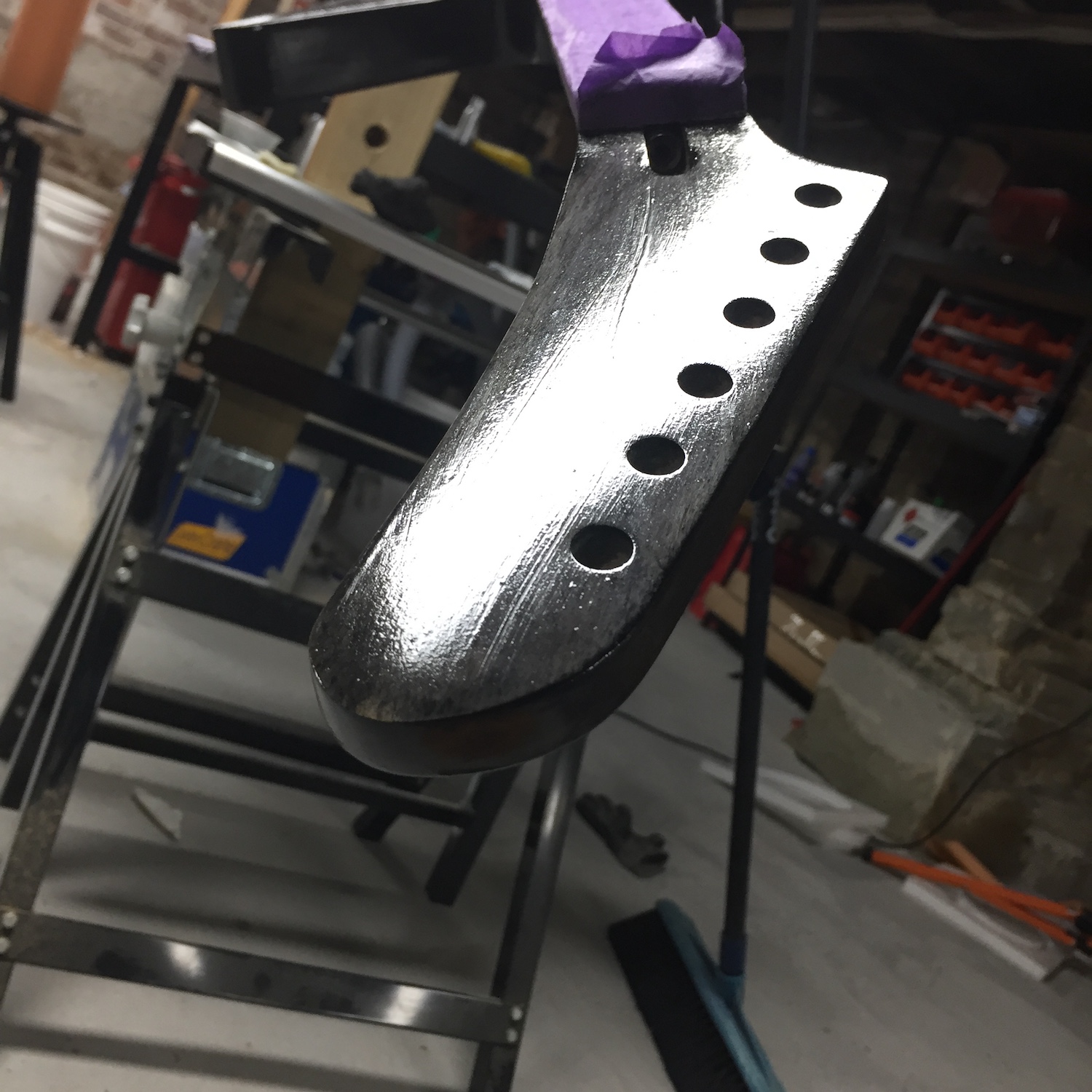

    I'm loving the way the DT is coming up!
    I know that I have already state how impressed I was with the DT finish (now that i have my application method sorted) but I cannot get over how well this has come up with no real additional treatment.
    I have a third coat that went on yesterday evening and these are the results.
ID:	15940 Click image for larger version.
    The neck already looks like its coated in glass, and the body is coming up beautifully (to my eye) as well.
