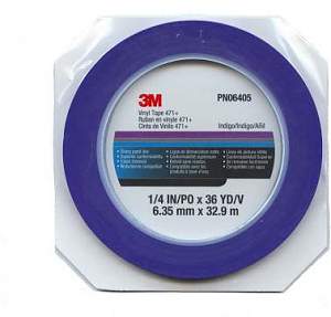

    It's time consuming, yes, but I got so I could do the top binding in about 1/2 hour. I used 1/4" 3M Fine Line tape. Use it carefully and it does an amazingly good job. Best stuff I have ever used by far.
    I use it for color only. I took the tape off for the clear coat, which I put on both color and binding. Mine came from eBay, but you can sometimes get it at auto parts stores.Click image for larger version.
