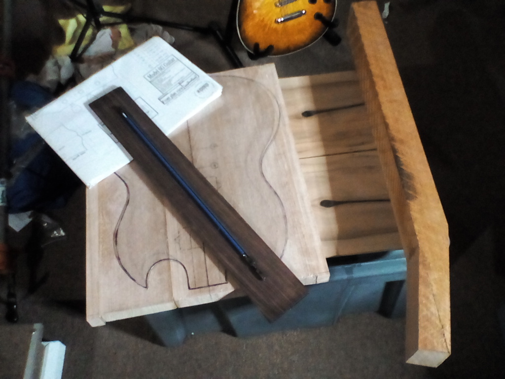

    Well covid lockdown and post painfully slow from WA, has finally prompted me to get started with this build.
    The neck is QLD maple, I've done a scarf joint to accommodate the 14 degree head angle. 2 way truss rod, rosewood fretboard, set neck.
    The body is laminated quarter sawn Tassie Oak courtesy of Bunnings. I've got a book matched 4mm Blackheart sassafras laminate for the top.
    I'm thinking it will have a tunomatic and stop tail but that's not set in stone as I have been toying with the idea of a Floyd rose.

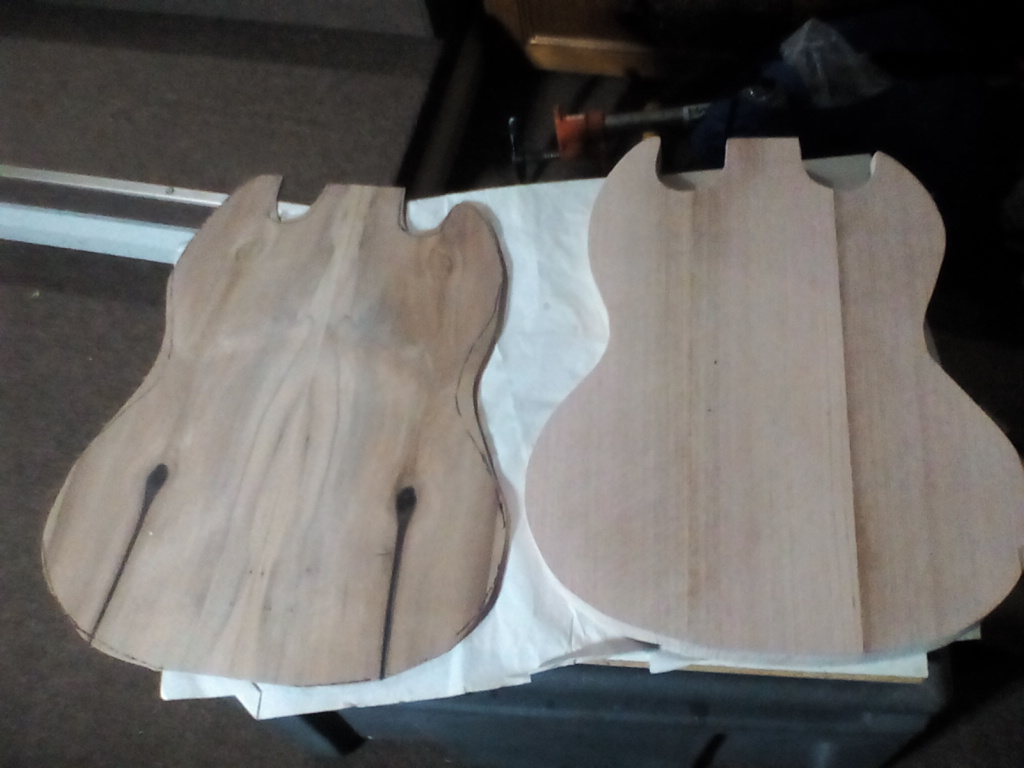

    Ok, got my body cut out and my Blackheart sassafras laminate joined and roughed out.
    Next step is to jury rig a press to glue them up.
    Hoping my 4 mm laminate will prevent any tas oak blow outs when I rout the top!

    That would be me that had the large tear out and broken guitar body with Tas Oak haha. Never again will I use that timber.
    Power tools also leave burn marks easily in it.
