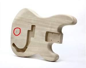

    Hi. Am new at this. Any instruction on getting the grounding wire from the pot to the bridge? It seems it needs a hole drilled from the pots to where the bridge sits, but that doesn't seem right. Much thanks. Corbs
    There is normally a pre-drilled hole for this purpose. Highlighted here in red.

    Can you post a pic? https://www.buildyourownguitar.com.a...ead.php?t=8108
    If you haven't got one, then you'll need to first locate your bridge position, then get a long drill bit (300mm is a good size so you can really angle the bit down low without the drill body getting in the way) and drill from near the centre of the area into the control cavity. You can drill into the pickup rout area if that's an easier route to take.
    Work out the drill angle beforehand and use a bit of card and a scrap block of wood or plastic to set up the initial drill angle. It helps to drill a wider vertical hole a few mm deep in the starting position, then you can start drilling from the side of the hole, rather than have the drill bit slide around on the top of the body. Better to drill at a shallow angle than risk drilling through the back of the guitar.
    You can get sets of long drills quite cheaply. Some typical examples here:
    https://www.amazon.com.au/s?k=300mm+...ref=nb_sb_noss
    Much thanks Simon. That's sounds good. There's no hole so I'll go by your advice. Can I ask do I solder the wire or just let the bridge sit on it? Cheers, Corbs
    Make a fair length of bare wire and just sit the bridge on it. If you use a fairly thin bit of wire for the ground wire here, you can probably knot it first, so that the knot sits in the vertical hole you drilled first, which then stops the wire from being pulled too far into the cavity. Just have the exposed wire sitting on the body and you can spread the strands out so that it doesn't add any real thickness.
