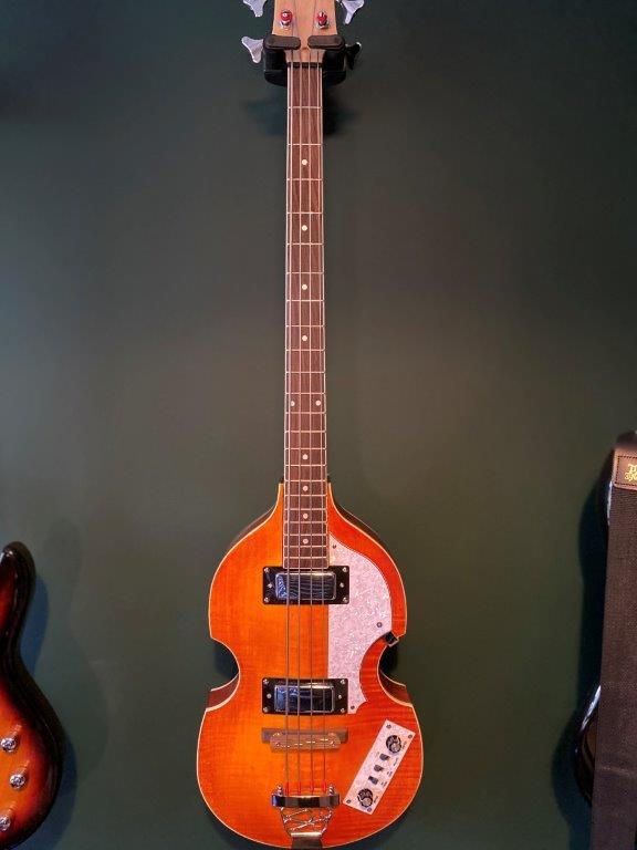

    This is my second guitar build but my first Pit Bull. I'm building a Hofner style HB4 which will have a sunburst finish. My first guitar build was a Chinese Strat that was given to me by someone who got it as a gift but wasn't up to building it. Although I didn't spend too much time on the finish, it went together well, setup perfectly and played really nice. It looked great and I gave it away to a student.
    I play bass in a Classic Soul Covers band called Georgie and the Tonics... a.k.a the G&Ts, (www.gandts.net), so I'm always after the muted tones of Motown, Atlantic and Stax. I normally play a G&L JB2 with flatwounds with the tone knob wound right back. I also love Paul McCartney's bass lines and have all the Beatles bass transcriptions. This seemed like the right way to get me some MCartney magic and it will look interesting on stage too.
    Here is my Chinese Strat that I built.
    I really like the finish that @bass_guy gave on his Gollum HB4, so I'm going for something similar but with darker edges to the sun-burst. COOLANGATTA GOLD & OUTBACK SUNSET.
    Because sanding and polishing are not really my thing, I'll be dressing this bass with the help of my good friend Brain, who has just finished his first Pit Bull JB 4, (which looks pro!), as he builds two more PB guitars. (C'mon Brian, hurry-up and get your build diary started.
    Here is my trial build to make sure everything was supplied. (I'm already in love with the tiger-stripes on the top!)
    One concern I have is that the neck is a loose fit in the pocket. Does this look like a problem?
    Wish me luck... I'm waiting on some Dingotone to be delivered.
    Cheers - Damian

    It's finally fininshed. Plays great and sounds great. I had to put the tuning pegs on an angle to allow it to fit into the case.
