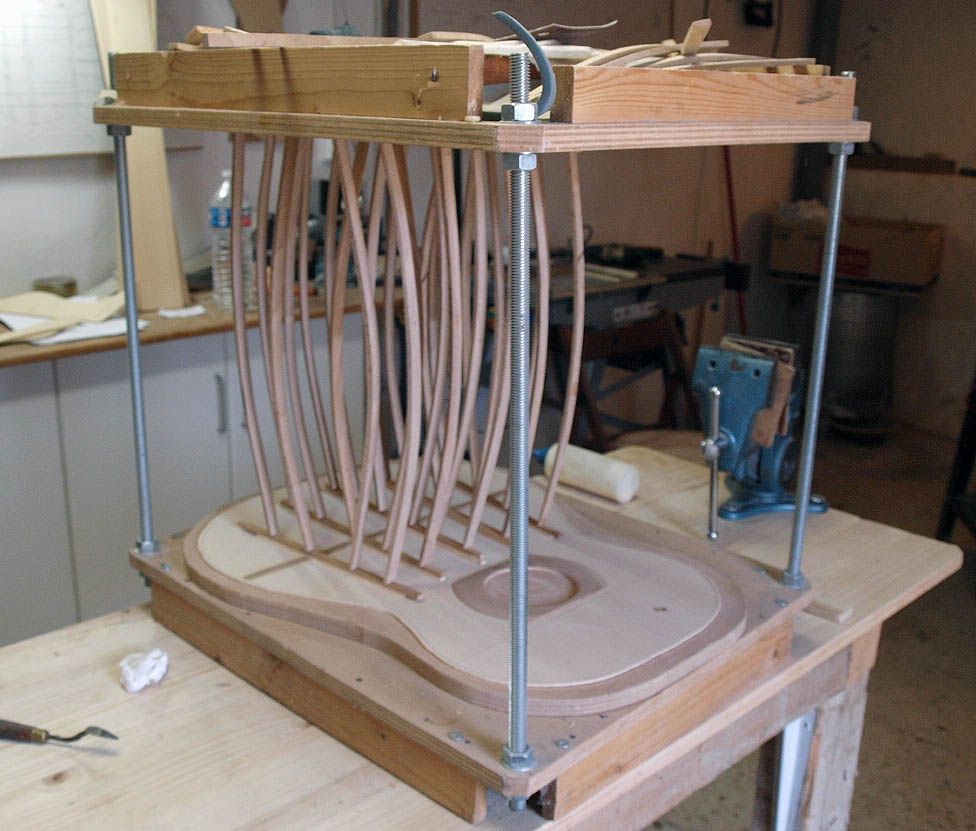

    Well I've ordered a couple of syringes with bendy thin nozzles for glue application. The two top braces are very close to the soundholes, so I will probably be able to glue and then clamp them from the soundhole.
    As I said, my first thought is that I need to get some flexible wood or plastic rods to act like 'go bars', which I'll bend into position so they push outwards between the underneath of the top and the bottom brace.
    Standard 'go bars':
    I'll need to find something that's reasonably flexible because there's not a lot of distance between the two surfaces. I can then put some heavy books on the top of the guitar to counter the upward thrust of the 'bars'.

    For internal bracing you could maybe use a threaded tube and bolt or something like a small turnbuckle to expand in the hole similar to a brace repair jack
    https://www.stewmac.com/Luthier_Tool...pair_Jack.html
    Tony
    I was thinking along those lines as a 2nd option. Well, a more DIY version, as buying those would get rather expensive. I'd need at least three for the brace that's almost completely loose. Unlike most other tools, it's not like I'd really get more use from them afterwards.
    Maybe I can find some screw-height adjustable kitchen cabinet legs or similar...
    I've found some simple plastic cabinet legs; 4 for about AUS $8. A bit more affordable, even if I need to file some notches in the feet myself for the braces to fit into. Not bottle screws, but something I think I can still adjust. I now need to do some measuring to get ones with the right range of height adjustment.

    You could probably make mini "go bars" from glass fibre sheet. I think I'd mould them with a built in curve, rather than flat, they'd be a lot easier to get in place. Use a plastic bottle or bucket or something to mould them round - something about double the diameter of the height inside the guitar at a guess. And yes, a bit of mdf with some weight on to keep the body flat.
    Well I've ordered a cheap set of adjustable legs. That's good, as mine no longer reach the ground.
    All the old plans went out the window as after watching various guitar restoration videos on YouTube I decided to do it properly, remove the back and re-glue each bracee fully from scratch.
    So in the the past week I've made a whole load of spindle clamps so I can glue the back of the guitar on again:
    Then with a mixture of knife and chisel, I prised the back off. The old hide glue was pretty brittle, so most of the back came off easily. It was only the heel and rear block area which gave me any real difficulty, even after heating up the wood with an iron. But brute force prevailed.
    All four of the rear braces were only held on by the smallest amount of remaining glue, whilst the two front top braces were only half-attached.
    And there's that small crack in the top that needs repairing as well. So that's something for me to do over the next few days.
