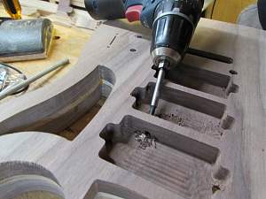

    I need help figuring out how to drill the holes in my humbucker guitar

    You mean like the holes that allow the pickup wires to connect to the controls in the cavity? And the hole that allows you to earth your bridge? What type of kit do you have?
    Yes. I have a gs-2q.

    Ok so you’ll need a hole that connects all pickup wires to the one area, a path basically. Like this.

    And then you’ll need a hole that goes from the bridge insert hole to the bridge humbucker cavity. Like this.
    Then, you’ll need to to drill a hole that goes from bridge humbucker cavity to your control cavity, like the second hole in the image above.
    This can all be achieved using standard size drill bits, just as long as you position the drill at the appropriate angle. The holes don’t need to be massive, just enough for the wires to feed through.
    Hopefully this helps, if not, YouTube is a great online resource.
