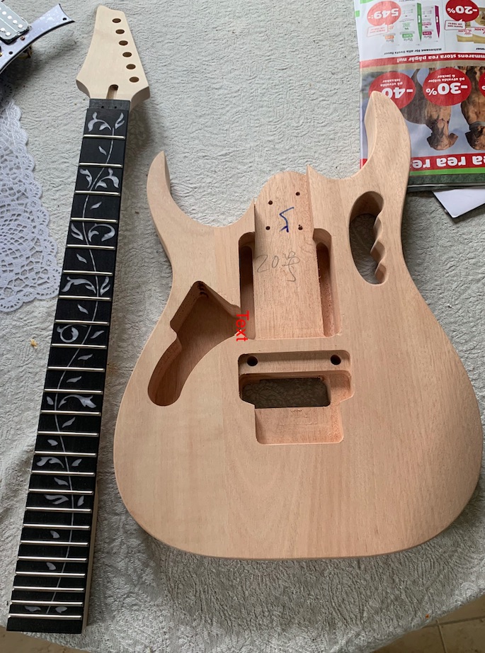

    It took a good while before delivery as it was some custom changes done.
    Missed some parts while unpacking but they were shipped asap from Pit Bull, fantastic service i must say.
    Anyway, mock build done, and painting will be next step as i still await a new pick guard.
    Would be happy with some input in how to set neck correct as there is no stop in the neck pocket.

    You’ll need to mount the bridge hardware and do a scale length measurement to the bridge saddles. That will tell you how far into the body you need to go.
    i think from memory the body edge at the top cutaway joins at around the 17th fret. I can check on mine tonight and let you know.
    Easiest way to do this is to measure the scale length from the nut to the bridge saddles. It should be around 648mm with the saddles in a midpoint position. There will be a certain amount o& adjustment backwards or forwards from that due to intonation on each string.
    EDIT: to get this right, you need to mount the bridge, but don’t set the metal anchor pieces until after you’ve done your finish. Instead wrap the individual post ends with masking tape until they sit firmly in the mounting holes, then you can set the bridge against them, clamp your neck on and take measurements from the nut back to the bridge.

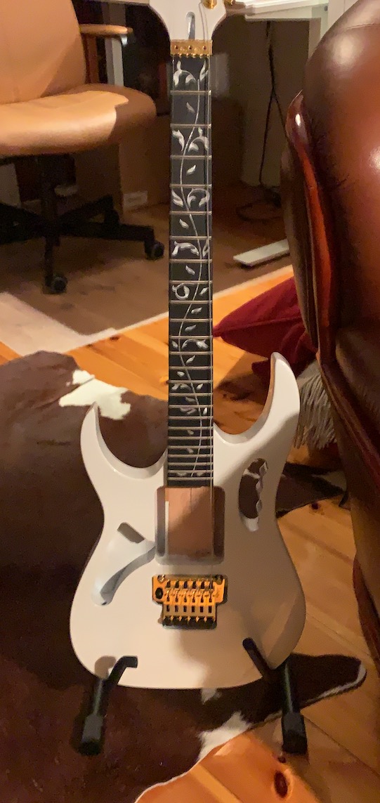

    Slowly making some progress here, vill fit bridge next and then try to get the neck in the right spot.

    Hi piece,
    I measured up mine as below tonight.
    The neck joins the body at the 18th fret at the upper cutaway and at the 20th/ 21st at the bottom.
    As near as I can measure it with steel rules, the end of fretboard is 139mm from the centre of the bridge anchors.
    I’ve not done a huge amount of work on intonation with this one but it all plays pretty well and rings true.
    A word of caution, I notice you have the I company logo on your headstock. Your finish looks great, but if you don’t want admins to delete your photos, edit out the logo, or cover it for your build diary shots.
    PBG are very supportive of the build community, but trademark logos etc are a no no for the posts.
    Hope this all helps,
    FrankenLab

    Thanks for the help, neck set in correct position now

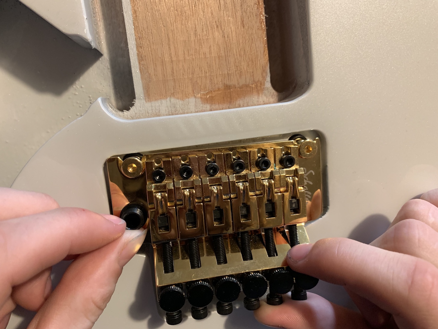

    This is kind of bad, missaligned holes for the brige make it look... Hrm not so good. Annoying i would say.
    Any ideas if something can be done to make it look better?

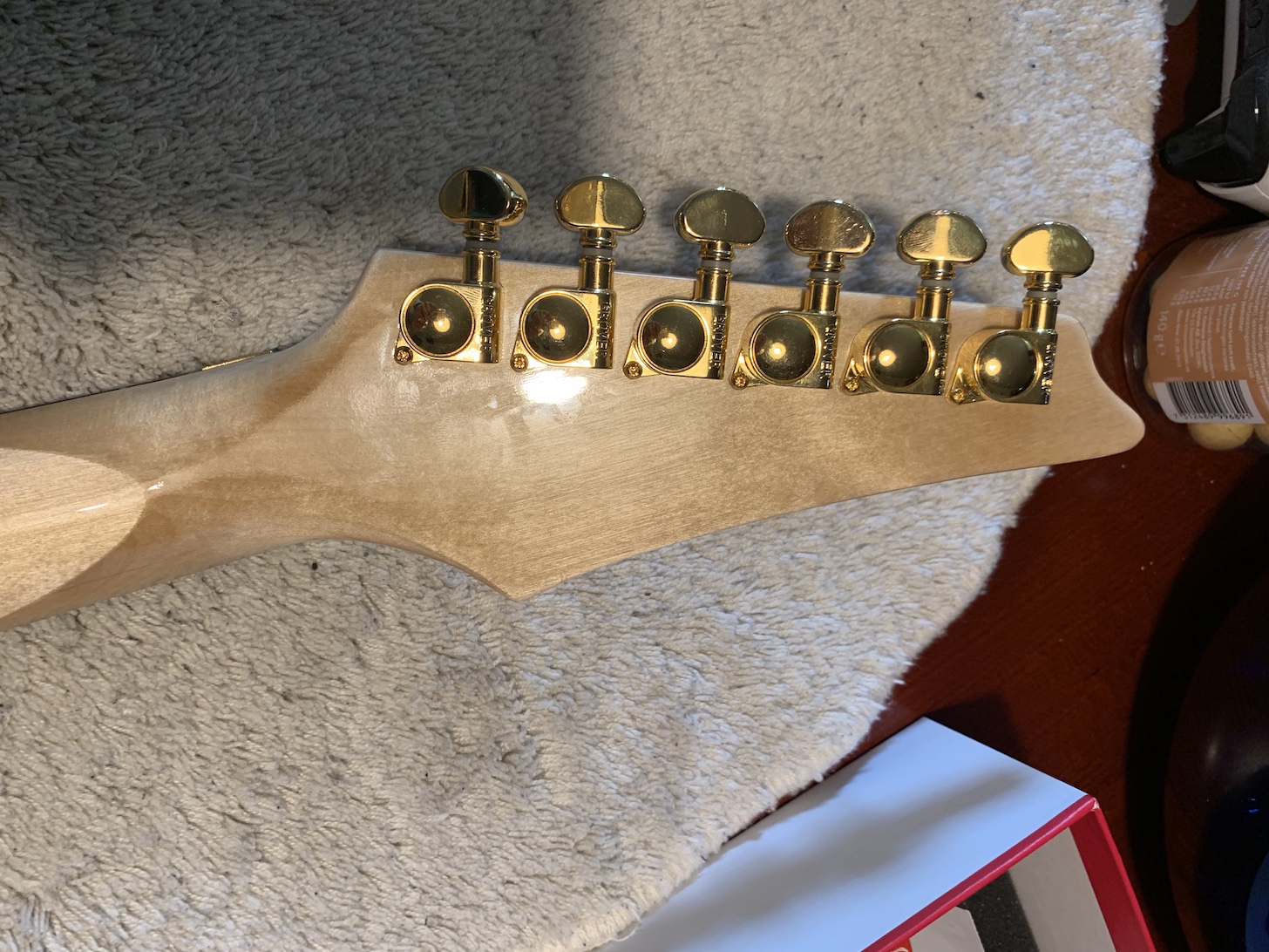

    Head come togeter nice.

    Not a lot you can do with that now the finish is on.
    The fix would have been to plug these and mark out for re-drill based on a standard length, see the attached link to the stew Mac calculator, it will give you the required distance from nut for these stud positions.
    https://www.stewmac.com/FretCalculator
    Enter the values for 647.7mm scale length and 24 Frets and you can check how far out it is.
    Have you reshaped the neck profile? It looks fantastic, really excellent work mate, well done!!
