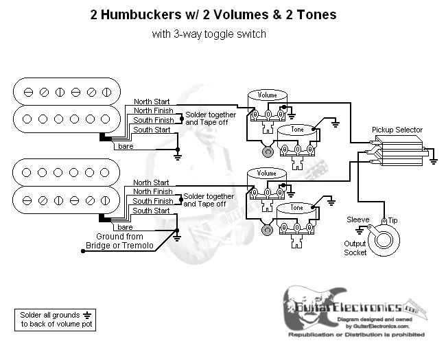

I am a bit confused by the difference in the chart at Guitar Electronics and PitBull...
In the PitBull wiring guide for 2 Humbuckers 4 pots and a 3-way switch The hot wire to the V pot is connected to the left lug of the T pot, and the cap is attached to the center lug on one side, grounded on the other.
https://www.pitbullguitars.com/wp-co...m4Pot%20v5.pdf
In the guitar electronics diagram the cap is attached to the hot lug on the V pot at one end and the center lug of the T pot on the other, and the left lug of the T pot is grounded.
I don't think I understand the difference. I there a sonic difference? Electrically, I think this just means that they are in series, but in a different order? GE has cap first, then resistor, PB has resistor first then cap. Is that right?
