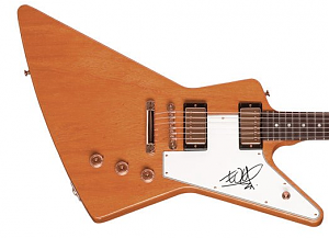

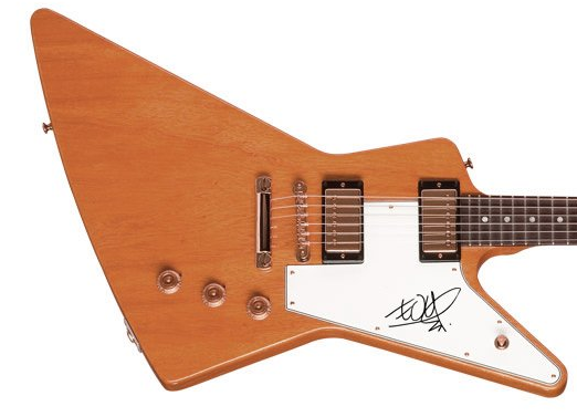

    Looking for some advice on achieving this colour finish on a Mahogany EXM-1 kit.
    I've done the grain filler and plenty of sanding to get a really smooth finish and I'm thinking that a clear coat finish straight onto the timber my bring out the colour I'm looking for?

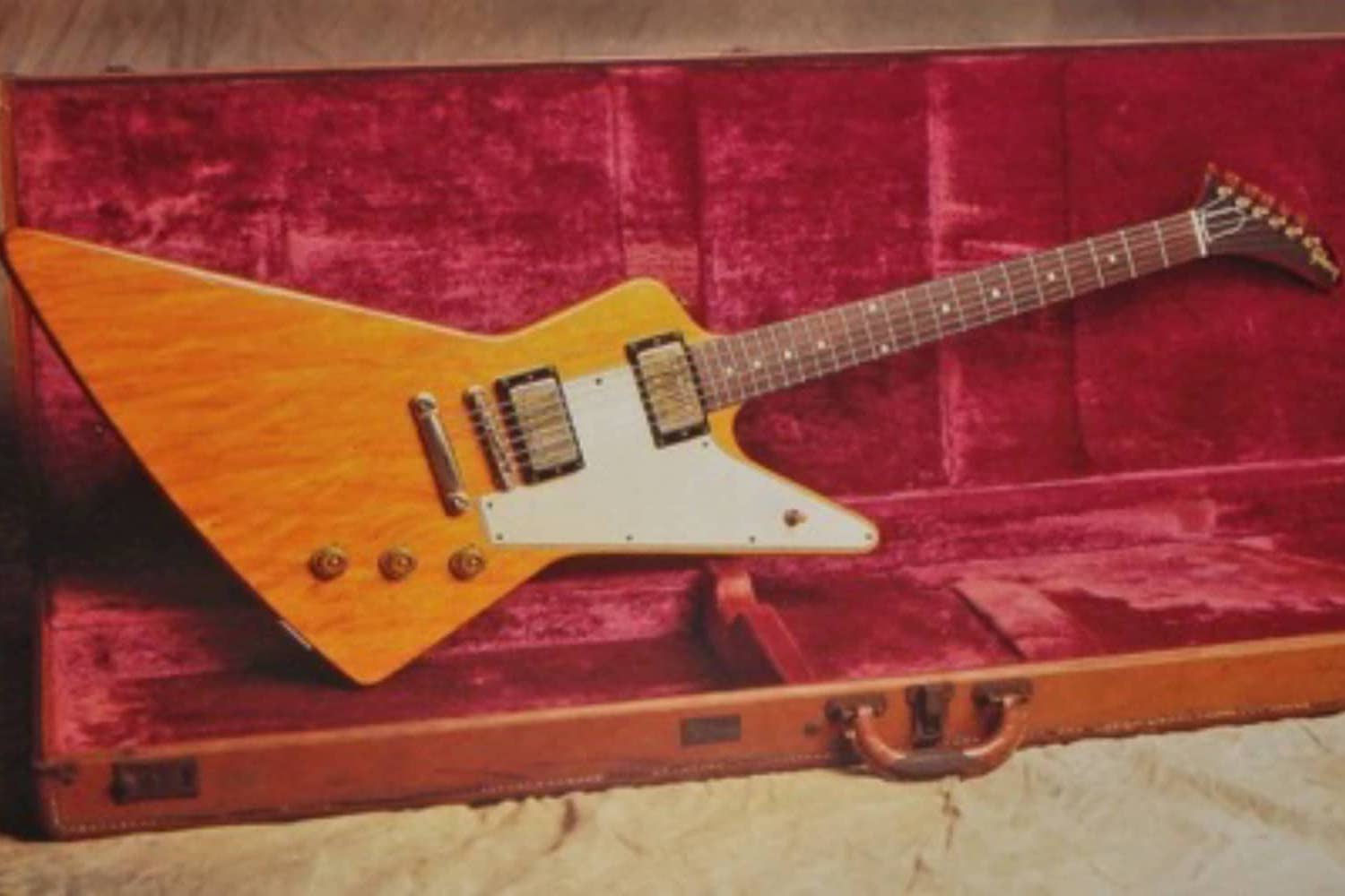

    Maybe achieved by using korina wood like the original 50s ones.

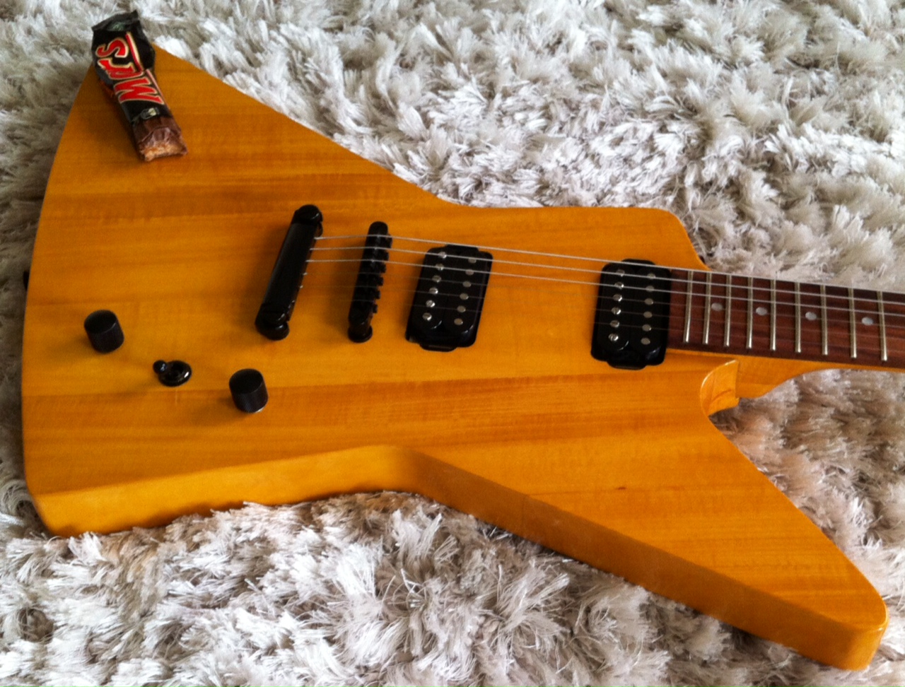

    Here's my EX-1 basswood body/maple neck done with Dingo Tone Coolangatta Gold Base & Intensifier coats and top coats done with Tru Oil. Now that it has aged a bit it looks pretty dam close to Korina which is exactly what I was aiming for.
    Mars bar in shot was only to provide a colour reference guide. Photo was taken 3 years ago and as TO ages is adds a bit more amber tint and looks more like the gooey caramel part of a Mars bar now.
    Not sure how this would go on Mahogany but from seeing Ozzies MMB5 in the flesh I was surprised how light 'hog was in its natural state. It might just work in getting close to Korina but reckon it would only need 2 or 3 base coats and same with intensifier otherwise the level of yellow may be too bright.
