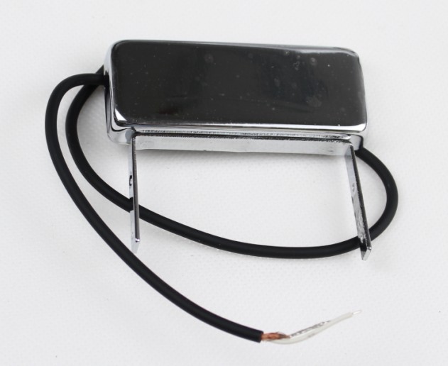

    To preserve the acoustic qualities of the kit I'm trying to mess with the body as little as possible - the fewer holes or things touching it, the better. I've asked for a kit without holes for knobs or pickups routed - just the F holes. I've ordered a humbucker which attaches to the bottom of the neck and hovers above the face of the guitar.
    I intend on mounting the tone and volume controls to a pick guard.

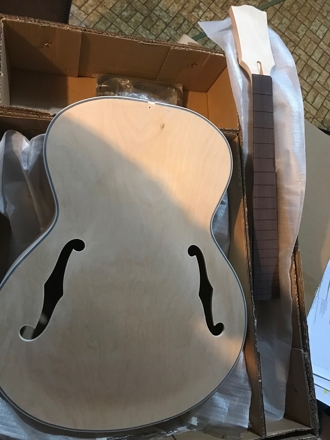

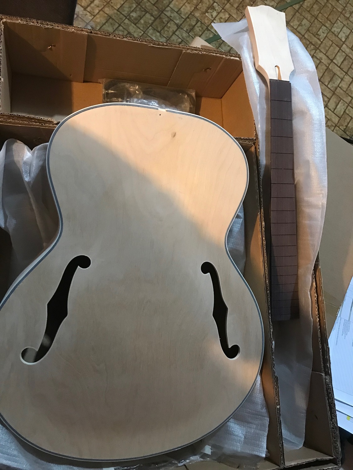

    Adam recieves my kit and sends "proof of life" photo.
    True to their word, the factory has routed only the F holes. I hadn't considered they might be so thorough with those instructions as to not route the neck pocket. After confirming with Adam that I did indeed intend on attaching the neck to the body, he came up with an excellent solution - DB will route the neck pocket.
    Awesome news! Quite likely a better outcome than if they routed it at the factory. As an aside - how awesome is this DB character? Good luck finding another luthier who would do all this for such a low price. Custom carved bone nut for $30? Get outta here! Neck pocket on the house? Forget about it! What a legend!
