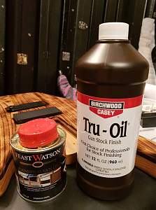

    Out of curiosity, what are you legends using to finish the back of the neck ? Not the fretboard / fingerboard, the back of the neck so its hardened and smooth and not just oiled wood. I use both Tru Oil on some necks and Scandinavian Oil on others. But not getting the hardened finish I am after. They work better on the bodies instead of the necks, in my experience anyway !

    At the moment my favourite neck treatment is Cabots Exterior Poly in satin. Very forgiving to spray. I normally do one pass as per instructions let it dry out, sand it back and do another application. It's great for getting a smooth neck that doesn't grab your hand like a gloss one might.

    I also liked the Tru Oil on the body, but didn’t like it on the neck of my first guitar. I gave the neck some steel wool treatment to make it feel better. On my second guitar I’m using wipe on poly and I liked the feel of it after two coats. Next time I’ll do two wipe on poly coats (satin) and leave it at that.

    There are various brands of wipe on poly, I certainly can’t recommend one over the other. I’m using Feast Watson.
