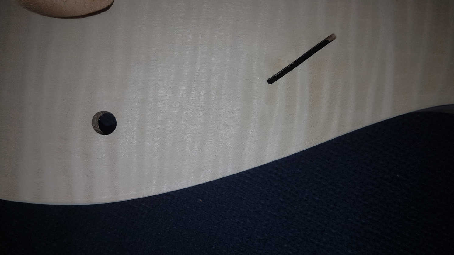

    One of the main "Problems" i have is the inconsistency of the binding thickness. for around 75% of the guitar, the binding is perfect in thickness, but at the bottom part (the part you rest the guitar on your leg) the binding is only 0,1 - 0,2 mm thick. This makes it impossible to scrape the binding after staining.
    What would you guys think would be a possible solution for this problem? i was thinking about routing out the binding and replacing it with a new one, only problem is that the body is carved both front and back, which makes it very hard to get a continuous depth with a routing tool. You guys have any idea to overcome this hurdle?

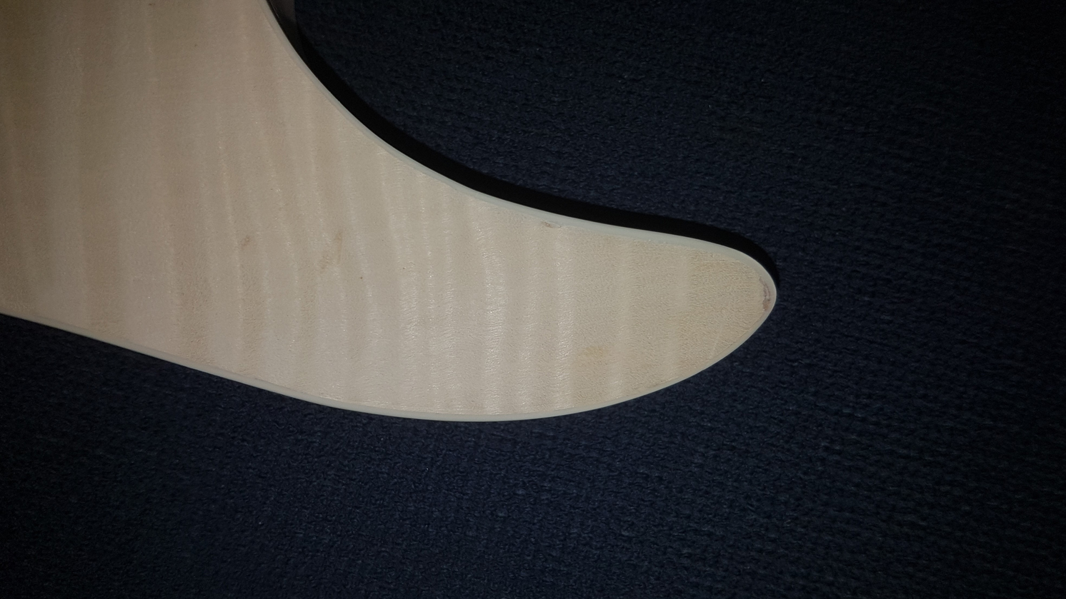

    I've attached 2 pictures, it's very hard to see but at the picture of the horn you can see the normal binding thickness and the other one the thin binding is visible. In the pictures, the binding looks wider than it really is unfortunately but it is regarding the area directly underneath the switch up untill the tone knob hole.

    I can see what you are saying with the binding at the lower bout, it really does look off, and that would annoy the hell out of me.
    The great part is that the veneer (from what we can see) looks absolutely wonderful!
    I would think that a strip off of existing binding, carefully (VERY carefully) deepening that binding rebate manually, and re applying to get an even binding band is the best way to proceed.
    The other non fiddly option is to live with it, though I'm not sure I could do that and my natural inclination is to fix these small defects (hence why there is One kit being actually built in my workshop and three being "Contemplated" for solutions to similar issues).
    Best of luck with it! If you get stuck, sing out and there are plenty here who can and do offer advice.
