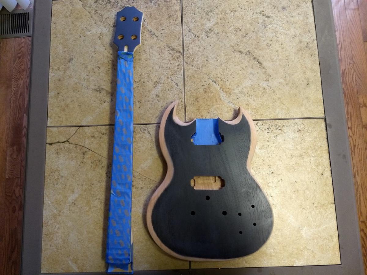

    The initial dyeing.
    dyeing the front of the neck pocket was a mistake but easily sanded off
