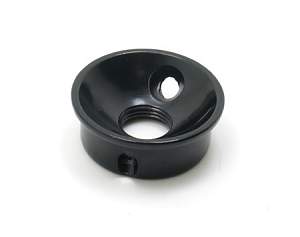

    Recessed jack cup sockets are the way to go, like this one that can be found at Real Parts.... https://www.realparts.com.au/hardwar...ack-black.html
