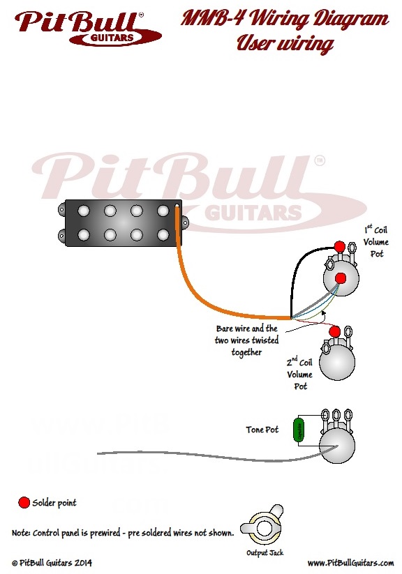

    Wiring diagram found here.... https://www.pitbullguitars.com/wp-co...MMB-4_2014.pdf

    The control plate comes pre wired and if connected like above it should work? I butchered mine and added a pre amp so not much help in that regard. The diagram is suggesting that volume controls are working independently off each of the humbucker coils and also has a master tone. Therefore, when all on '10' it should sound quite full and meaty but as you back off one volume the level would drop as well as the depth of tone, then switching the other way does the same on the other coil. The difference in sounds is very subtle between front & rear coil and when combined with drop in output level you may end up just leaving both volumes wound flat out.

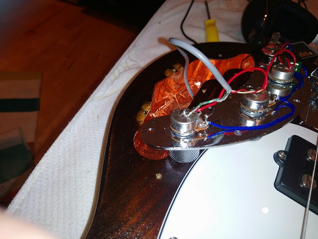

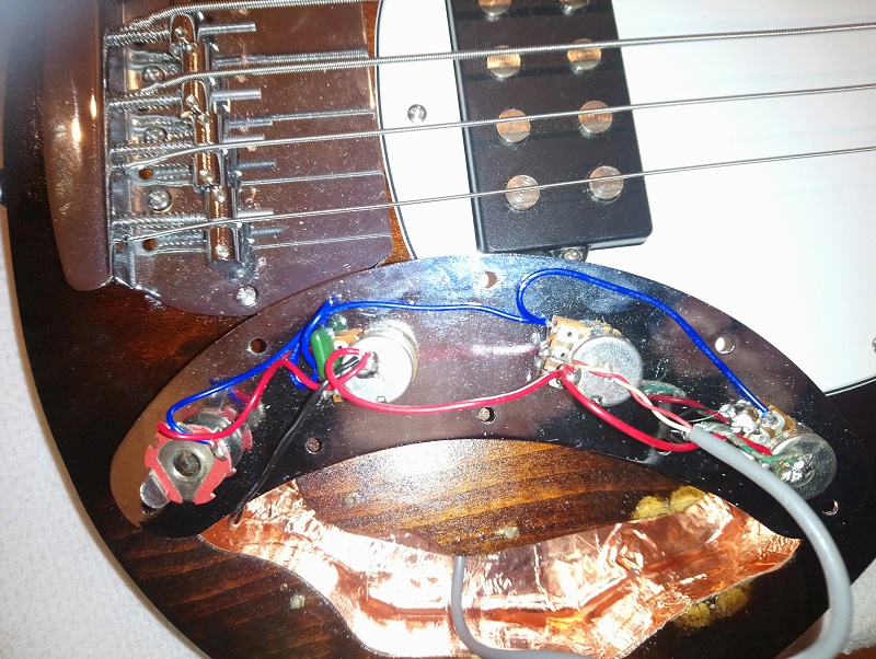

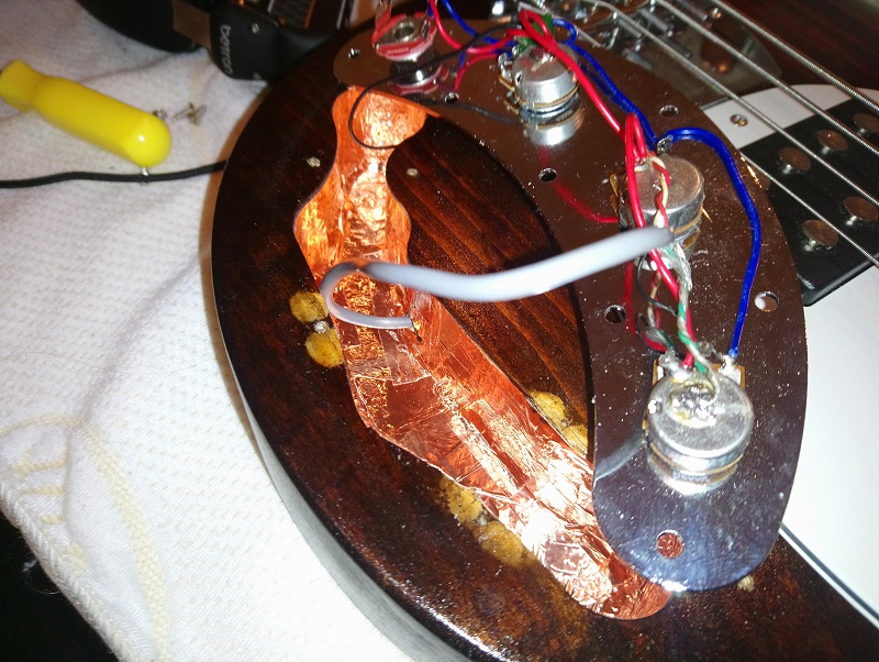

    Hi, please find attached pictures. I hope its clear for your to see. I followed the wiring diagram as closely as possible. The differences in my wires are my green twisted wire was made of 2 wires not three like the diagram, and the red wire which is one wire on the diagram is twisted consisting of two wires on my pickup.

    The green and bare twisted wire Ive soldered to the top of the pot, I butchered the soldering a bit but its attached. I did a cleaner job of the black wire to the hoop on the same pot, and the red and bare wire was reasonably cleanly attached to the hoop on the second pot.
    Ok, it's as I suspected. The factory typically ships humbucking pickups like yours with their coils linked in series, whereas the wiring diagram is designed to link them in parallel (as is traditional for a MM pickup).
    So your pickup currently has its coils linked like this:
    Bare & Green - 'Coil 1' - Red - join - White - 'Coil 2' - Black
    First, as a common point of reference, the pot with the green capacitor nearest the jack is the Tone pot, the middle pot is Volume 1 and the other pot is Volume 2.
    You currently have the pickup's Black (hot) wire connected to Volume 2, which is correct. But, you have the joined Red-White pair connected to the Volume 1 pot, which is what is causing the problem (or maybe one of the problems). With that wire pair connected to the Volume 1 pot it's working as sort of a balance/fade across the two coils, which is why it's loudest at the middle point... it starts cutting out one coil or the other as you turn it to either side.
    If you want to test what the pickup sounds like with the coils in series all you need to do is disconnect that Red-White pair from volume 1, cover the bare tips with some tape and give it a try. The pickup will be at its loudest and Volume 2 will control the volume.
    To wire it traditionally, as intended on the diagram, all you need to do is disconnect the Red-White pair from Volume 1. Unsolder the tips to separate the Red and White wires, then connect the White to the back of Volume 2 (with the Green and Bare pair), and connect the Red by itself to the middle lug on Volume 1. That should allow Volume 1 and Volume 2 to control Coil 1 and Coil 2 respectively, and all should be well in the world.
    Now, it's possible there could be some other issues. The 'all or nothing' effect you've been getting with Volume 2 could be a result of the Red-White mis-wiring, or it could be a bad/cooked pot. You'll need to correct the wiring and then see.
    The Tone pot not changing the sound could also be tied up with the mis-wiring, but it could be something else. See what it sounds like once the re-wiring is done. If it is still not changing the tone then we'll need to investigate further. In that case, check that the bare legs of the Green cap haven't been squashed onto the pot or its lugs (which could short it out), and if so, try to post some close-up pics of it before trying to 'un-squash' it as the legs are easy to break.
