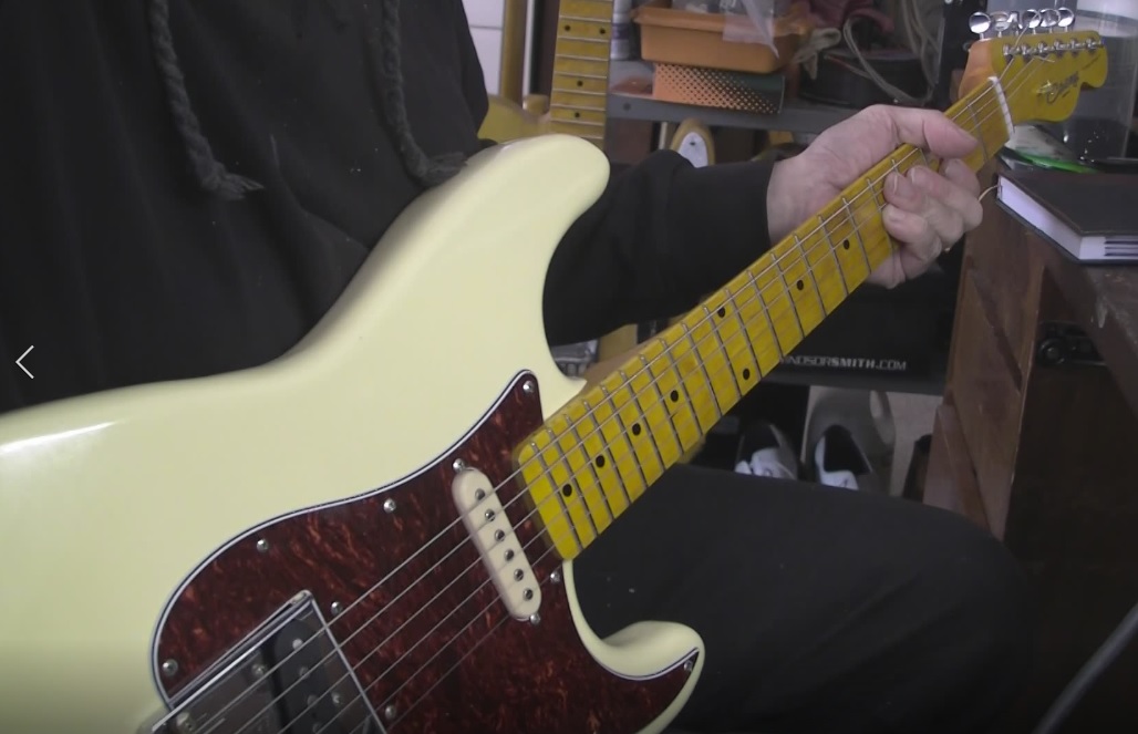

    I went all the way and stained it with F&W Golden Teak.
    Several coats of Molotov clear over the top. Dried nice and hard.
    With a fine sand and polish is holding up quite well (unlike the Tru-Oil attempt).

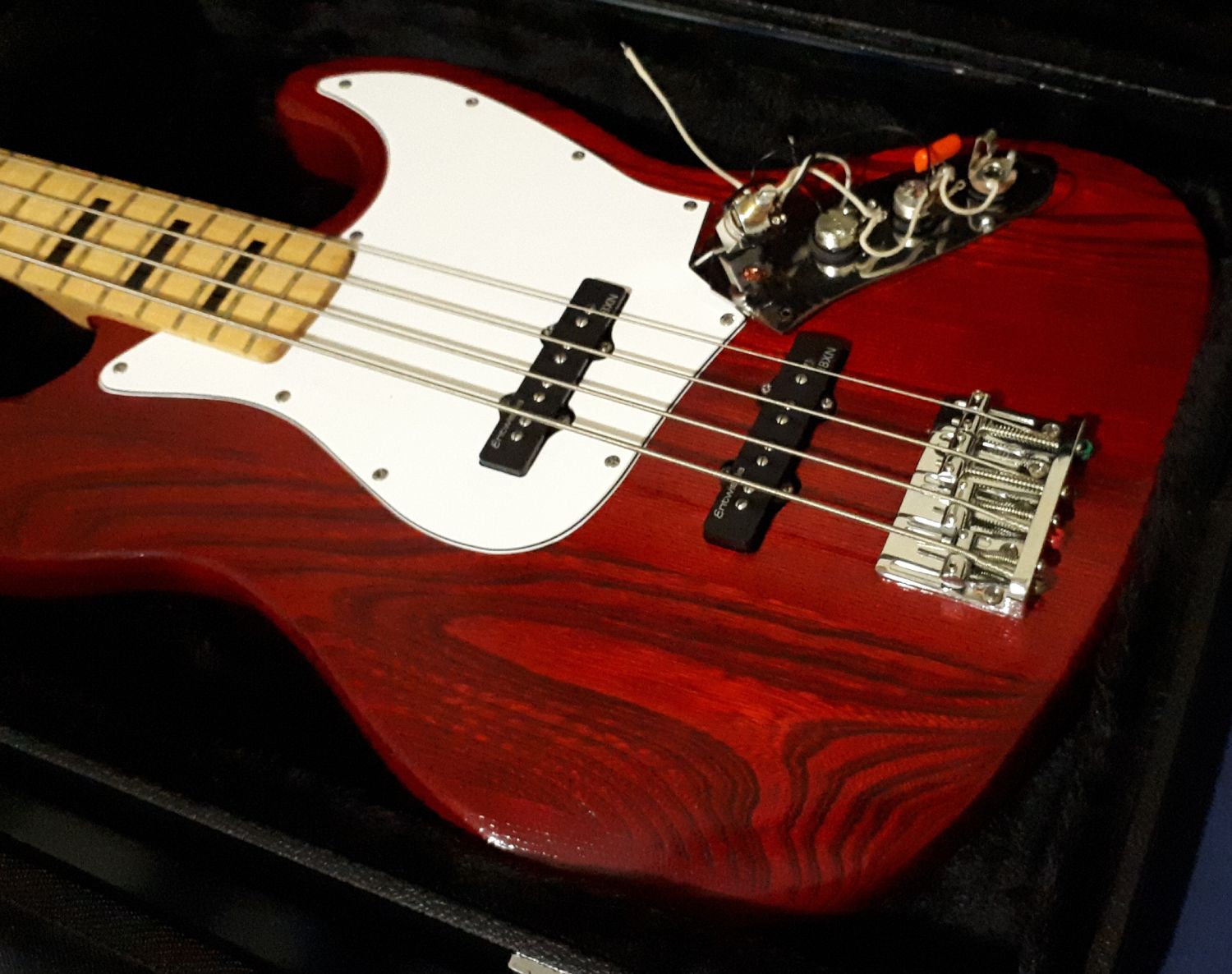

    Here is my J Bass done with just Tru Oil.....feels great.
Name:	2018-02-13 20.13.06.jpg
    Guitar is about 1 year old in this shot as when 1st done it looked almost clear however it does age up over time and takes on a vintage look.
