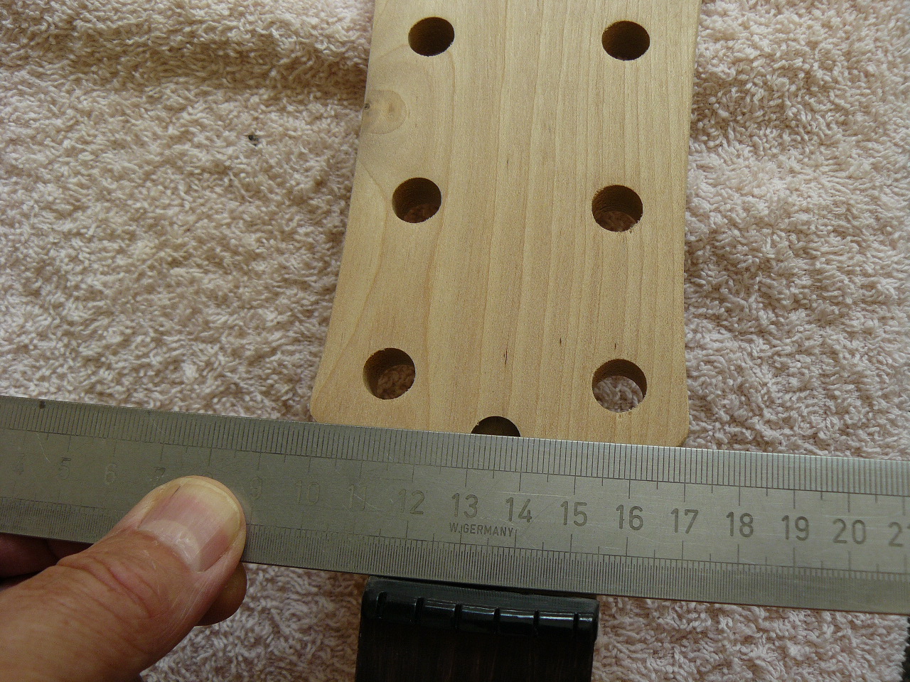

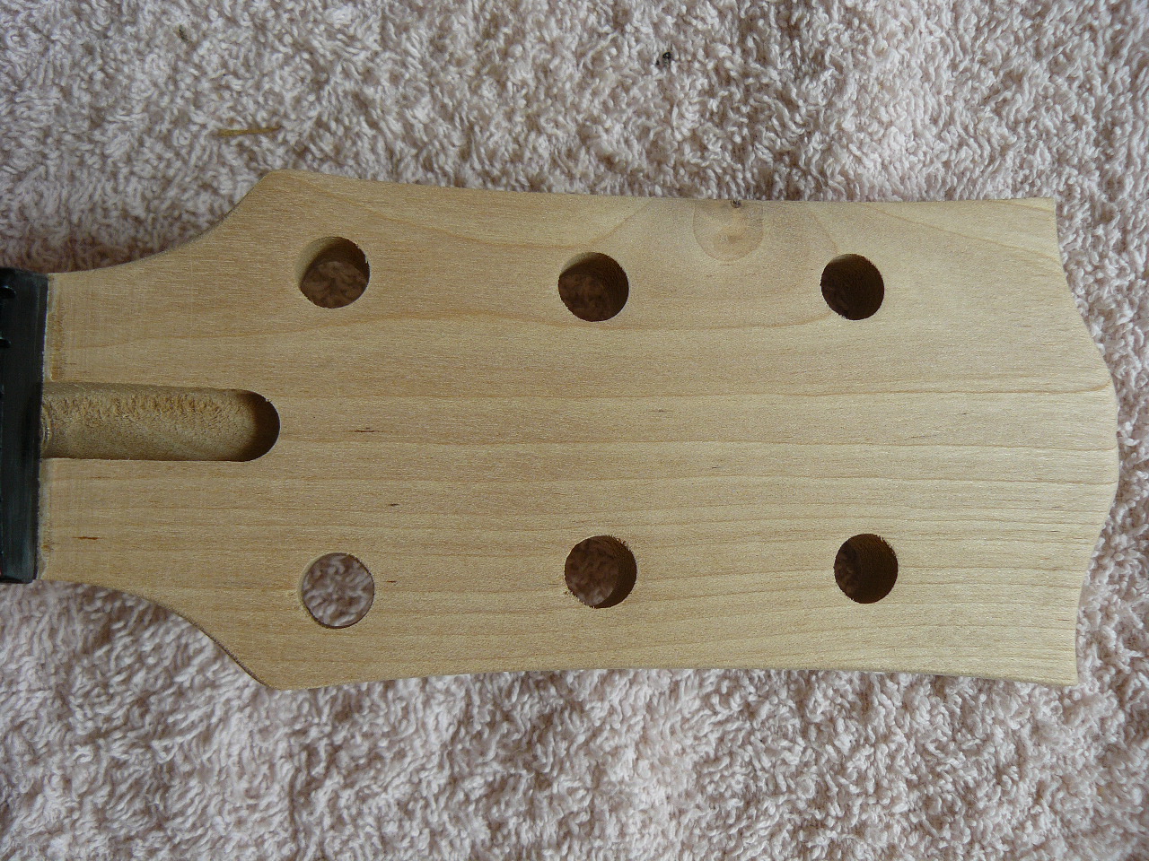

    Okay, on closer examination I can't get away with a slice off the headstock:
ID:	27585Click image for larger version.
    the holes are simply erratic. I suppose it would be possible to bush with maple plugs and re-drill (adding a veneer to the headstock if the inserts appear beyond the machinehead washers) but I think I'll leave it be. It does give a "handmade" look to the instrument (and I'd probably only mess up the fresh holes!). Incidentally, there are a number of knots on the neck, something that never bothers me unless they are really unslightly and an actual weakness. I once held a Strad' - it was made during his "golden period" and was a true work of art, yet strangely the timber chosen was not the finest tonewoods and there were several small, and unattractive, knots on the back. The sound was superb, though.

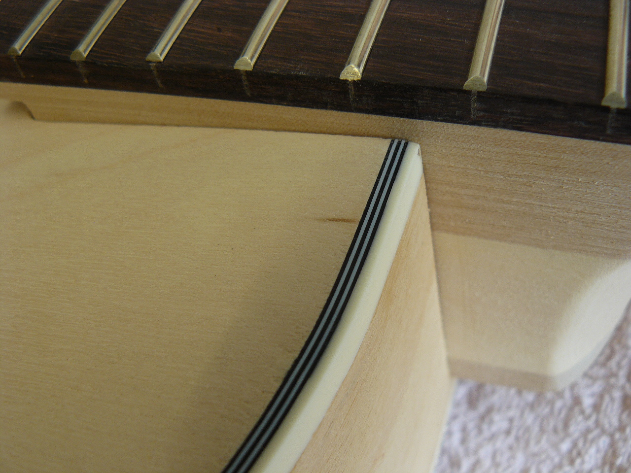

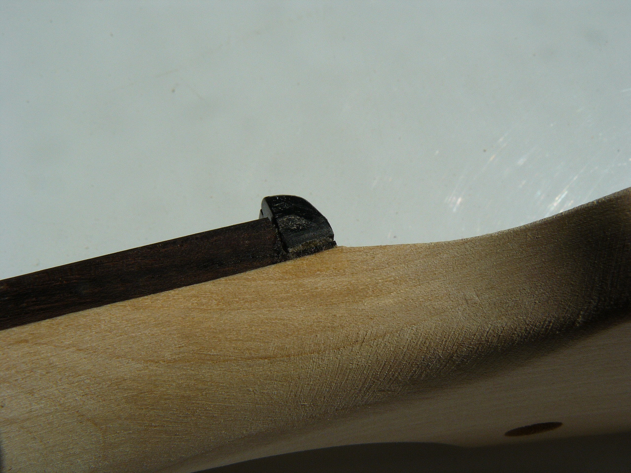

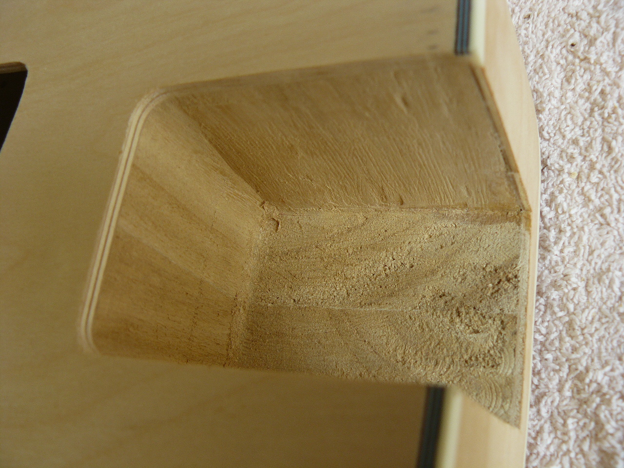

    The socket is cleaning up nicely:
    and the neck sits well:
  13. #9
    Mar 2018
    East Sussex UK
    17
    Previous post shows the top nut. My next job is to remove this and cut a decent base for the bone piece that will replace it after finishing. I think finsihing will take longer than usual - I'l be trying to put off the time when I have to fit the electrics - something I have never done before...
