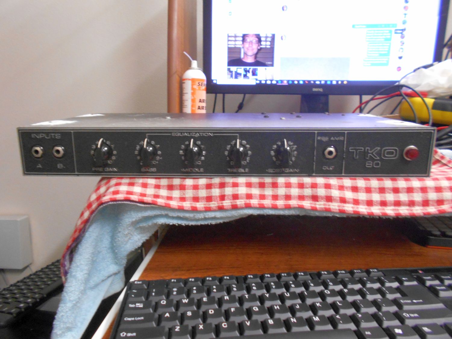

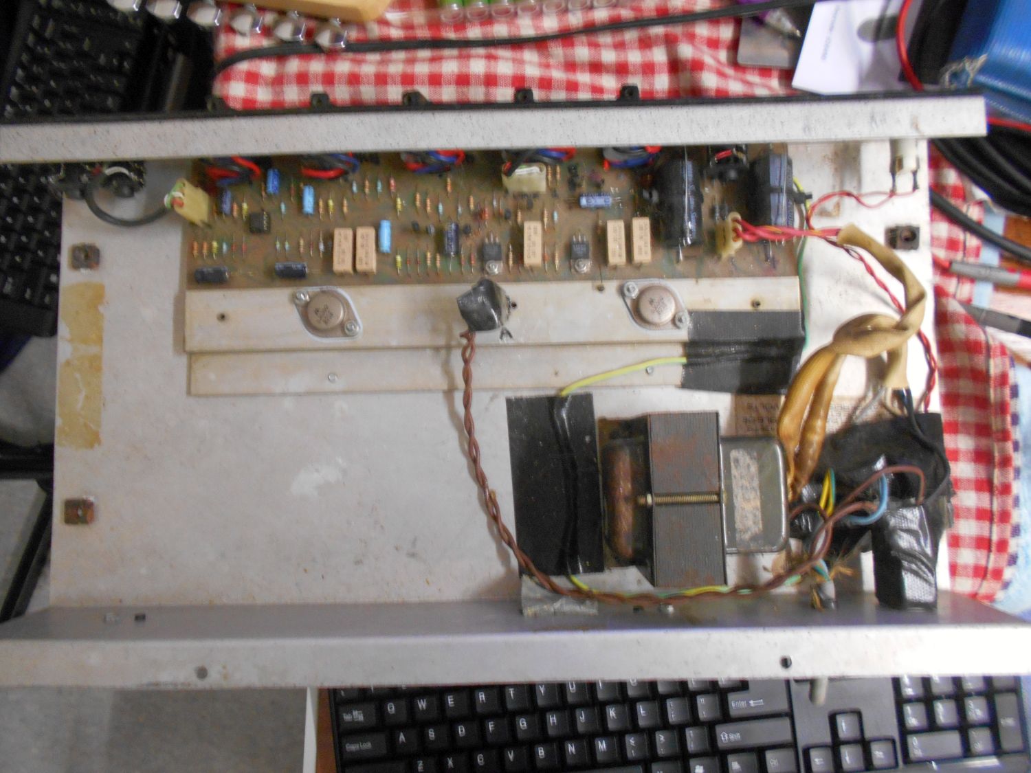

    The TKO 80 I have is actually only a 30 Watt amp, I've got the smaller practice amp version without the EQ, here's a couple of pics of the amp chassis:
Name:	TKO 80 Chassis_resized.jpg
Name:	TKO 80 Chassis 2_resized.jpg
    Note that the knobs aren't the original ones, but I reckon they look fine.

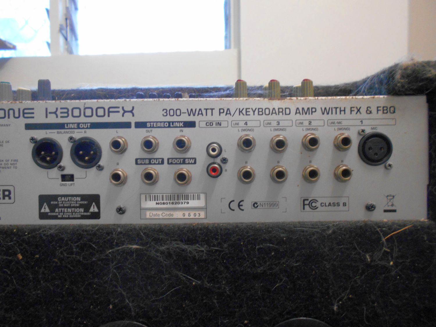

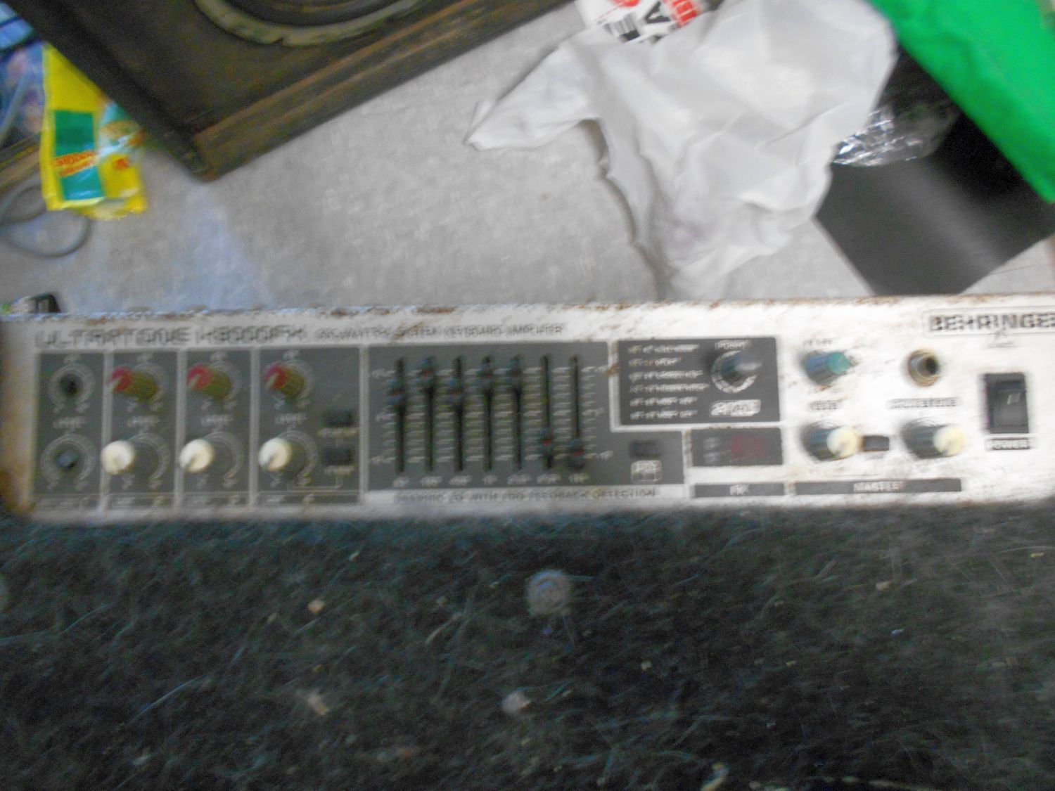

    Pics of the inputs and controlls on the K3000FX amp:
    The top pic shows the controls of the K3000FX Keyboard/PA amp and the settings on the EQ to get a sort of useable Bass guitar sound, if I wanted to plug a keyboard into the K3000FX at the same time the EQ would have to be set flat.

    I decided to do an experiment a few minutes ago, this involved connecting the pre-amp out socket on the front panel of the TKO 80 up to one of the line-inputs of the 300 Watt Behringer K3000FX Keyboard/PA amp, after plugging in my Squire P Bass, I first powered up the TKO 80 and then the K3000FX, no loud bangs or smoke occurred, so that was a good sign, with the bass, mid, and treble controls set to the 12 o clock position and turned up the pre and post-gain controls on the TKO 80, I was greeted by a nice loud and clean bass tone coming from the Behringer K3000FX when I plucked a string on the Squire P-Bass, so the idea of converting the TKO 80 into a bass preamp for use with the K3000FX is going to work perfectly.
    The Squire P-Bass sounded nice and punchy through the setup, if I turned the volume up I found that I could easily get the glass panes of my loungeroom window to rattle, I had both the line input level, and master volume of the K3000FX set to the 12 o clock position and it sounded plenty loud enough to my ears with volume to spare.
    Interestingly, the sounds I got were brighter than plugging the P Bass straight into the line input so I was correct in my thinking, the TKO 80's Bass, Mid, and Treble controls seem to give quite a useful range of tone from a deep Reggae style Bass, to a bright Rock Bass.
