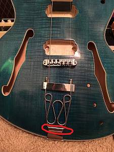

    So the plate for the tailpiece does have a hole drilled in it Simon, at least I don't have to worry about that.
    What I'm wrestling with a bit is getting the strings past the bridge to still be relatively straight - where they are held by the trapeze is slightly less wide than the bridge.
    The plate that holds the strings is in effect, adjustable with the two post nuts (not sure what their real name is)... but i'm not sure if it's supposed to be. But effectively I can use it to change the entire angle of the tailpiece... which since the body is angled is obviously a plus.
    But there's also a little bit of a challenge in getting it so the height of the trapeze off the body is consistent.
    I can't remember if in these pics (i took them last night).. if I've got those post nuts at full tightness or not.

    Looks like that tailpiece needs to go round to the right about 5mm or so. The low E looks straight across the bridge but the high E swings in at the bridge. How does it look with the tailpiece lined up with the top veneer join?

    It's all made harder because the rear of the guitar is at an angle where the trapeze has to go. I don't know how much adjustment there is with the two nuts holding the bar on, but it might be possible to loosed the high-E side nut and straighten out the angle of the bar, which may help with the arrangement and provide maximum string separation. You may then need to add a touch of thread lock or a small drop of superglue to keep the nut in place.
    If you've got a thin piece of foam, you might consider sticking some under the rear part of the trapeze to keep it from marking the finish on the top; location marked-up below.

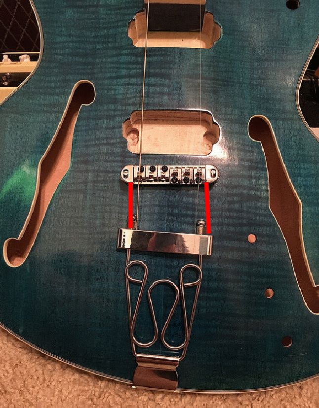

    Having done this once with a similar tailpiece, I have a couple of suggestions. Take the nuts off. You should be able to remove the bottom part of the tailpiece from the string retention bar. Use a torpedo level to make sure that that Bridge is not higher on one side than the other. If possible secure the guitar this way so it can't move from side to side.

    Now adjust the strings so that the two red lines are the same length. The middle of the bar is now the *natural* center.
    You now reattach the bottom part and adjust the nuts so that the hole at the bottom is the exact same distance from both nuts. The hole will be in the exact right place to attach.
    Hope this is clear. Writing quickly... ;-)
    P.S.: You can get a much fancier trapeze or stop tailpiece, but functionally this not a bad one. Mine is the bass version, but I have been pleasantly surprised at how good the sustain is, and how solidly it holds on. I only used it because I couldn't fit a proper stop tailpiece. But I am actually pretty happy with how it works and sounds, FWIW.

    3,051
    OOPS! I just saw my error. Looking at the bridge a little closer, I see that the bass side is a little further "south" than the treble side. So the torpedo level on the bridge idea won't work because the string should be a little longer on the treble side than the bass side to the tailpiece. You can still find the center with string length, but I think you'll need to put the torpedo level on the nut, and measure the string length from there. A bit more cumbersome, but it will still work.
