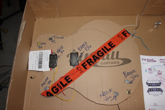

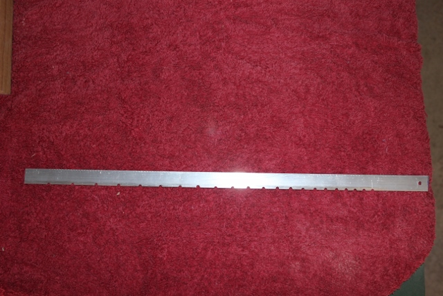

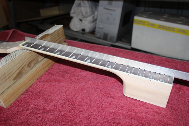

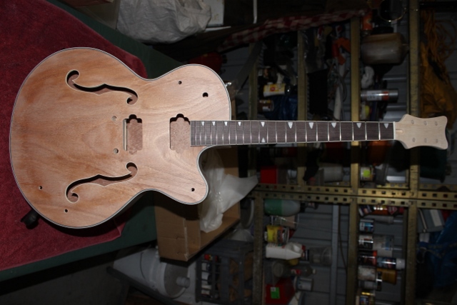

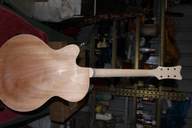

    My latest challenge arrived yesterday. A GR-1-SF with a mahogany body (apparently) as the suppliers ran out of basswood. My good fortune as the grain looks really nice on this one. I did the mock build to ensure everything was there & have laid out the electrics on a template to work out the distances of wire required to get it all into the body once I am at that stage. I also made a fret level gauge to make sure I have a perfectly straight neck before I tackle a fret levelling exercise. I was going to have a white finish on this beauty (white falcon style) but after coating it with some sanding sealer I am contemplating a natural finish to show up the grain.

    Love that grain! Sometimes the wood speaks to you, and that's definitely true in this case. What did you use to notch your level gauge?

    61
    Just a round file for a chainsaw & a samll needle file

    Have spent the day sanding. The front has a couple of slight marks which may show up. I am using very fine grade wet and dry paper 800 grit then 1200 grit and it is getting a smooth shiny finish to it. If the marks persist I might try a 'liming finish' which will still leave the grain visible. Meanwhile I got into the soldering late this afternoon & is nearly complete!! Tomorrow I will test it for buzz etc.

    looking good. It's nice to see someone tackling the same kit at the same time. be warned GO CAREFUL on that front face the veneer is really thin. I went through around one of the f holes! - im painting the front though so no biggy.. i am going to stain the back and sides and the neck though.. but the neck feels SOOOO good unfinished..

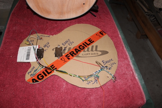

    Productive day today. Electrics all soldered & working!!! My soldering is improving with every build! I have decided to leave this beauty in natural finish & will give it clear coats when the sanding is complete. I do not go near these kits with any less than 320 grit paper for the first sanding then onto 400 grit 800 grit then 1200 grit. After soldering the electrics I have discovered that I cannot set the neck until I install them unless I want to learn to become a contortionist! I remember trying to fit the electrics to my ES 5V through the F holes so this time I am taking a different tack. A video will go up on You Tube after I finish the build. Meanwhile here are some pictures.

    Member BuffaloGhost's Avatar
    Dec 2018
    Sheffield
    172
    Looking amazing. Really exited to see this. I’ve set my neck already. Too late now - ha ha. I’m going to get all my paint coats down the. Tackle the electronics. Might be watching that video!! Nice work!!
