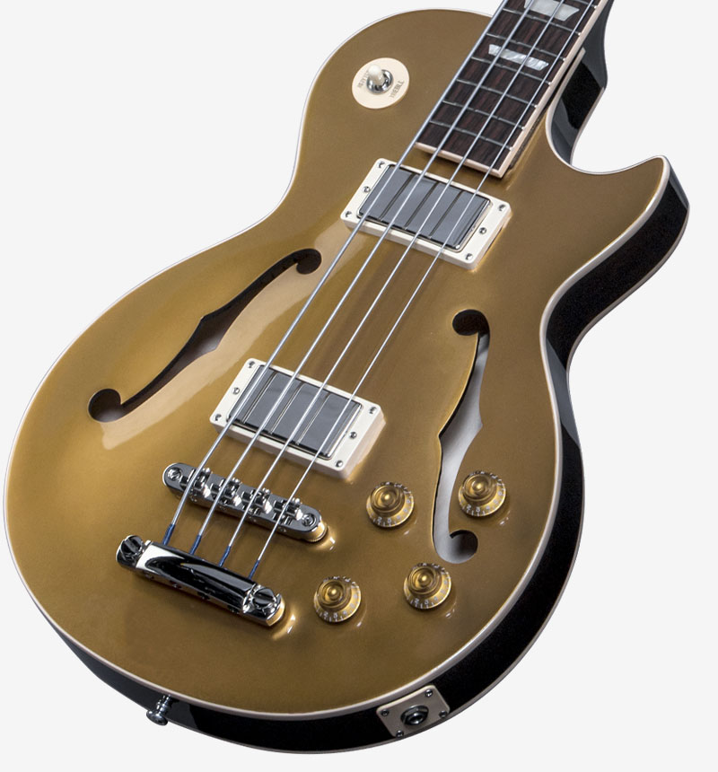

    Those ESB-4 kits look great but that 3 point bridge is not practical and agree that they should instead come with a Bass TOM, something like the one on this example....
    Cheers, Waz

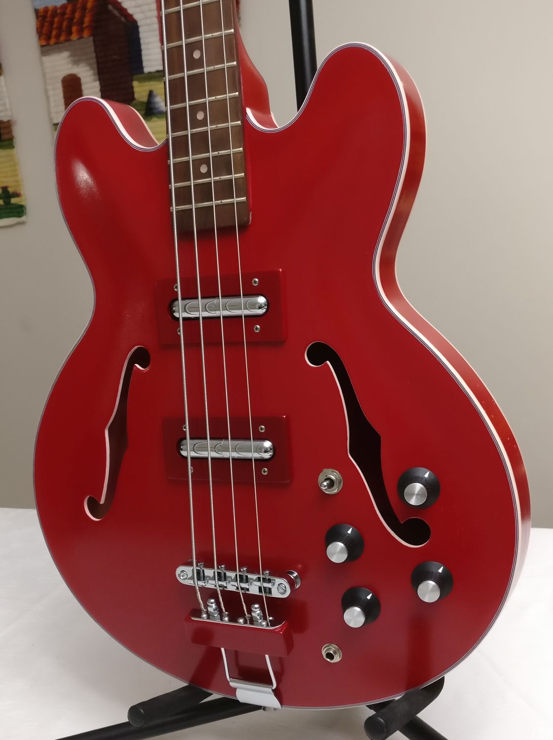

    That's a good option. I did something similar with mine, just fashioned a trapeze tail piece rather than stop tail piece.

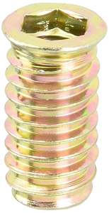

    ...Or you could use these, rather than the bushings that come with the 3 point bridge:
    This might secure the kit's bridge better, but requires a smaller hole than the the ones that come pre-drilled.

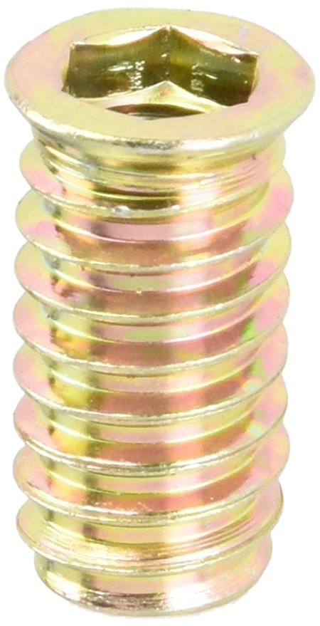

    I also think this could be done with the original hardware:
    This last one would require new drilling rather than re-drilling, but the placement of the holes is sometimes out of alignment.
