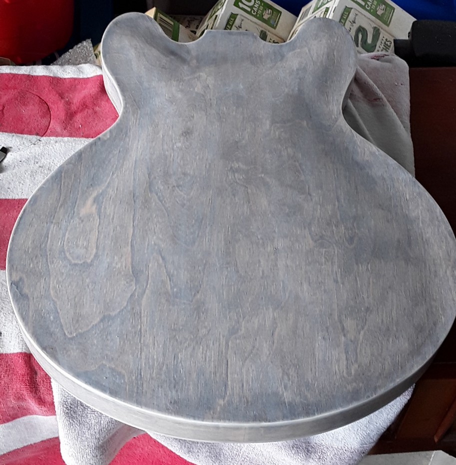

    I’ve been over the forum for a few days and can not find anything on a bleached floor board type finish?
    Does anyone know how to achieve something like this???
    MKA2 - yes, I want to be Johnny Ramone.
    Not exactly the same but this was my grain popping phase.
    Stained with jarrah and sanded it back.
    If you can find something a bit greyer then it may achieve what you want to do.
    Yours is also ash which will look a lot nicer than mine which is a basswood body

    Hey OliSam
    It sounds like you're trying to achieve a whitewash finish, here's a video that might help:
    Also, to give your grain that grey-ish colour, I suggest filling using something dark like ebony Timber Mate, sanding it back and then whitewashing overtop. Hope this helps!

    Thanks trv. That looks about right.
ID:	29569 is this the look your after olisam

    [QUOTE=Adam Barnes;is this the look your after olisam[/QUOTE]
    Hi Adam.
    That’s actually quite interesting ........and I think I will try something like that...
