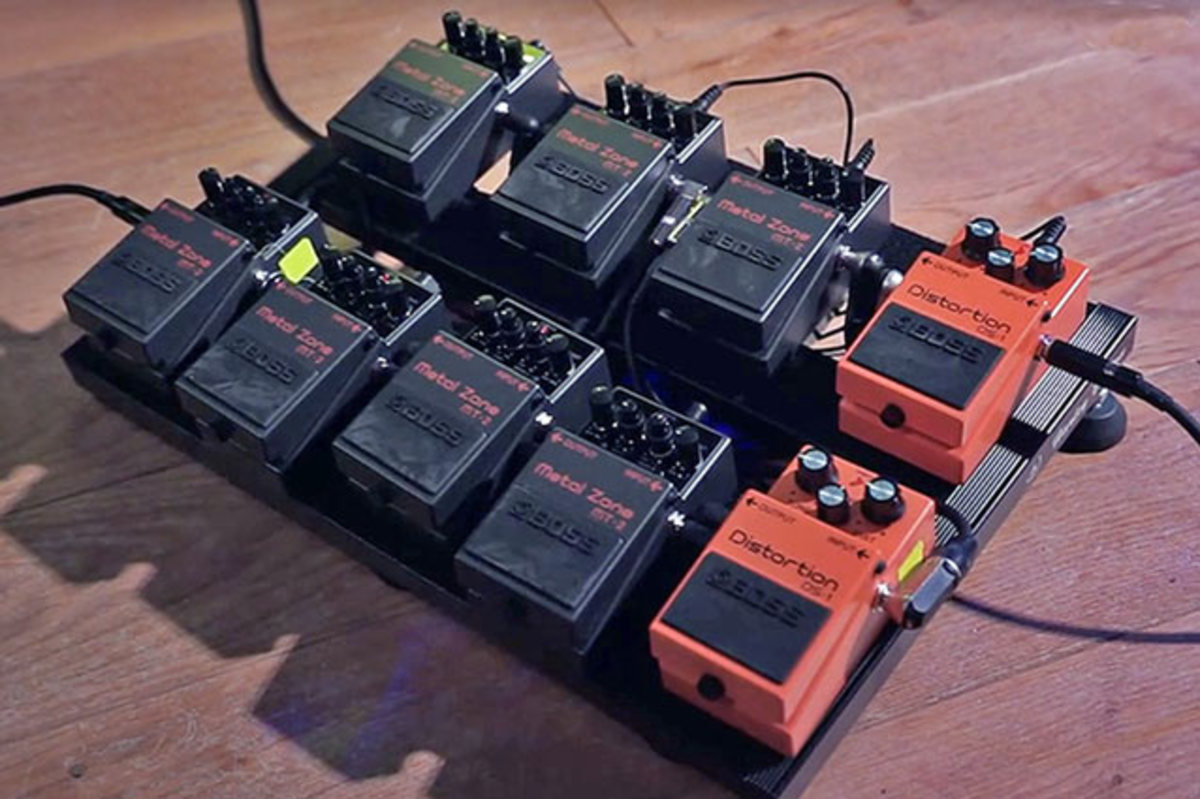

    This is the true secret to blistering metal tonez...
    If you go back and listen carefully, most metal guitar sounds aren't as distorted as you assume. They are distorted, but not enough to loose clarity. Multi-amp set ups where the cleaner amp sound is also added to the mix is often used. One of the secrets of heaviness is to get the bass to play unison riffs with the guitars to fill out the bottom end.
