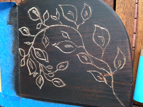

    HI all..well I did a quick free hand dremel I used a very small engrave piece rounded not pointed as I think you can get better control and use it more like a pen. I dropped a pic in my My Build..no idea if I'm updating my My Build diary correctly so holler if I"m doing updates the wrong way.
    Any way I think the dremel went okay noting I haven't done a light sand or brush down not the engrave. Click image for larger version.

    Dremel engrave (swatch only)
    Quote Originally Posted by juanitasanch View Post
    OK...I may have gone a bit out there and this is only first paint (swatch) ...but the dremel pic stained in earlier thread I have sanded back, then engraved again with slightly larger burr, diluted brown jarrah (light wipe on) when dry sanded again with a 400 over dremel, 240 and then 320 then 400 remaining body. Reason I didn't go higher is more I'm still testing effects. I then applied an oil sky blue with a tiny brush..to see effect and do love the contrast of blues and browns..thoughts? am I crazy.. Attachment 25509
    Definitely a unique look.
    Brushed on Blue may need a bit more finesse to smooth things out.
    Cheers, Waz
