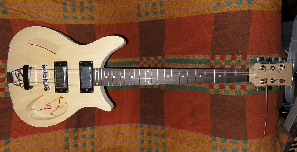

Finally I put together the basic parts of my RC1 to strum the first chords out of it (The kit received in early January)
Notions:
+ Very soft touch, even though the strings are still pretty high
+ I like the neck profile
+ Parts fit together well, careful work.
- The 1st fret is too low, all strings buzz when pressed. No problems with other frets. This I can fix.
- Bridge slightly too high at lowest position. Will sand the neck slightly to change the angle.
- The bottom of the pot cavity is only 2.5 mm (0.1 in) which I think is too thin. Light shines through.
A sharp hit from backside and it will crack. Trying to think of a smart way to reinforce it.
Same problem anyone? Solution?
