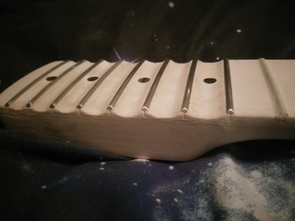

    I did scallop my bass neck (imprecision bass in my signature) above the 15th, but that was ages ago. I believe I used a half round file followed by sandpaper, the art is not scraping the frets of course!

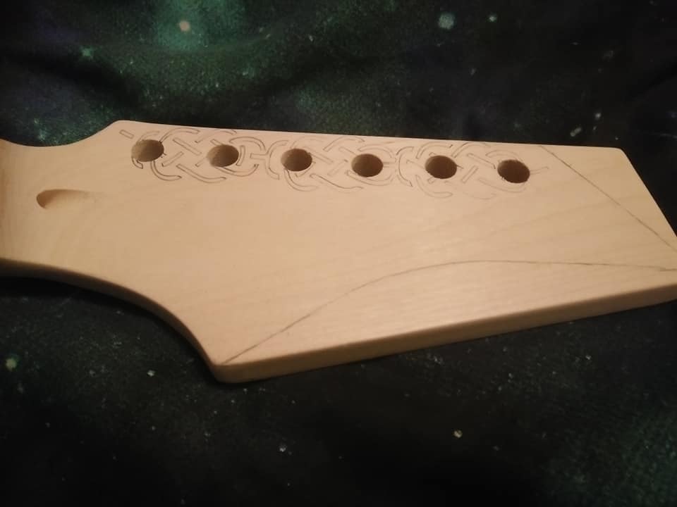

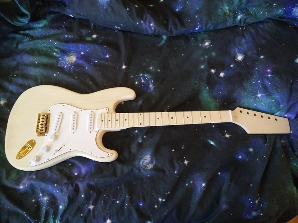

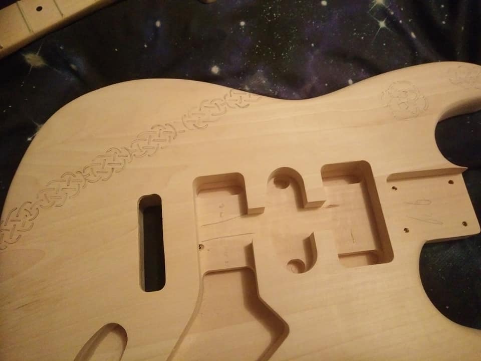

    Heres what ive done so far

    Have you played a scalloped neck, I recommend you do before you get too carried away.
    One of my mates has a collection of very nice guitars and one is a custom shop scalloped Strat and to be honest I really didn't like it, it was far too easy to bend notes out of tune when fretting particularly chords.

    nah i haven't played on a scalloped fret board yet that's why i'll only do from the 15th fret

    Just finished staining the neck and burning the design into the headstock. decided to stain the neck with a mixture of tea and coffee for an old look. what do you all suggest i do to get that clear glossy finish
