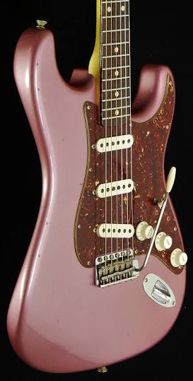

    Hey team, looking for nitro in burgundy mist.
    Available overseas, but no body will ship to Australia.
    It’s a 60’s Fender colour - a dusky metallic pink.
    Looks like this:
