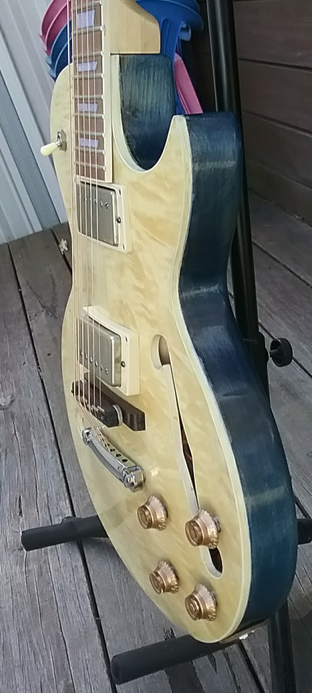

    Nice kit lucas, the one i made is great to play, id stain the quilt it will look amazing Click image for larger version.
ID:	24762you wont be sorry this is how mine burned out
