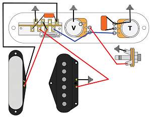

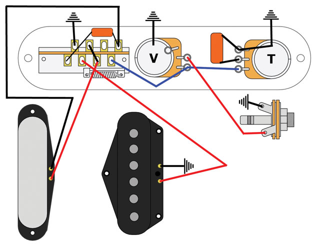

    http://www.jacksinstrumentservices.c...rol-plate.html
    It may be easier to get a 4-way Tele switch (which normally gives Bridge/Bridge + Neck in parallel/Neck/Bridge + Neck in series) and have the volume or tone pot as a switchable pot for the out-of-phase mode. (Just seen that this appears to be what the pre-wired plate Chrissyinbkk's link does). This will give the option of having both pickups in serial and parallel mode but out of phase as well as in-phase. True out of phase operation does sound really thin, so you may not like it after a while, which makes a separate switch for that mode quite useful as you can just leave the pot in the normal position without any risk of hitting a really weak thin sound if playing live.
    One of the pickups will have to be modified (it's normally the neck pickup) so that the metal cover is disconnected from the pickup's signal ground and has its own ground wire added. This is necessary for the serial mode wiring as well as any phase switching. So you'll need to be reasonably good at soldering.
    To get all the wiring on a 5-way switch, you'll probably need a 'super-switch', which normally has 4 sets of poles and is a lot chunkier than a standard switch. You may have trouble fitting one within the narrow confines of a standard Tele control cavity as they are more commonly used on Strat-style guitars where there is a bit more room in the cavity.
    I was thinking of doing something similar and found this, have not tested it so not sure if it works.
Name:	5 way tele switching diagram.jpg
