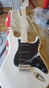

    it has arrived! im like a little boy at Christmas once again. haha

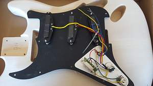

    do these guitars come already wired up?

    is there a trick to line up the bridge?

    Hi Brokin, the ST is intended to be an easy starter kit, so a lot of the wiring is presoldered, i think you only need connect earths and jack points. I see you've order PUP upgrades, so you'll need to refer the wiring diagram and sub in the upgrades for the kit ones.
    I really like the blacked out Scratchplate look BTW.
    Hey Brokin nice looking kit. Yes there are only 3 solder joins on this kit, earth wire to the tremelo spring claw and hot and earth wire to the jack.
    Lining up the bridge is easy, put both E strings on, clamp the neck and drill the bridge screw holes so the string to edge of fingerboard offsets are about the same

    thanks guys. yeah very happy with the kit. but this time im not going clear paint. im going to try and be a little trickier with the paints. lol possibly red and black. we will see how i go.
    mock build
