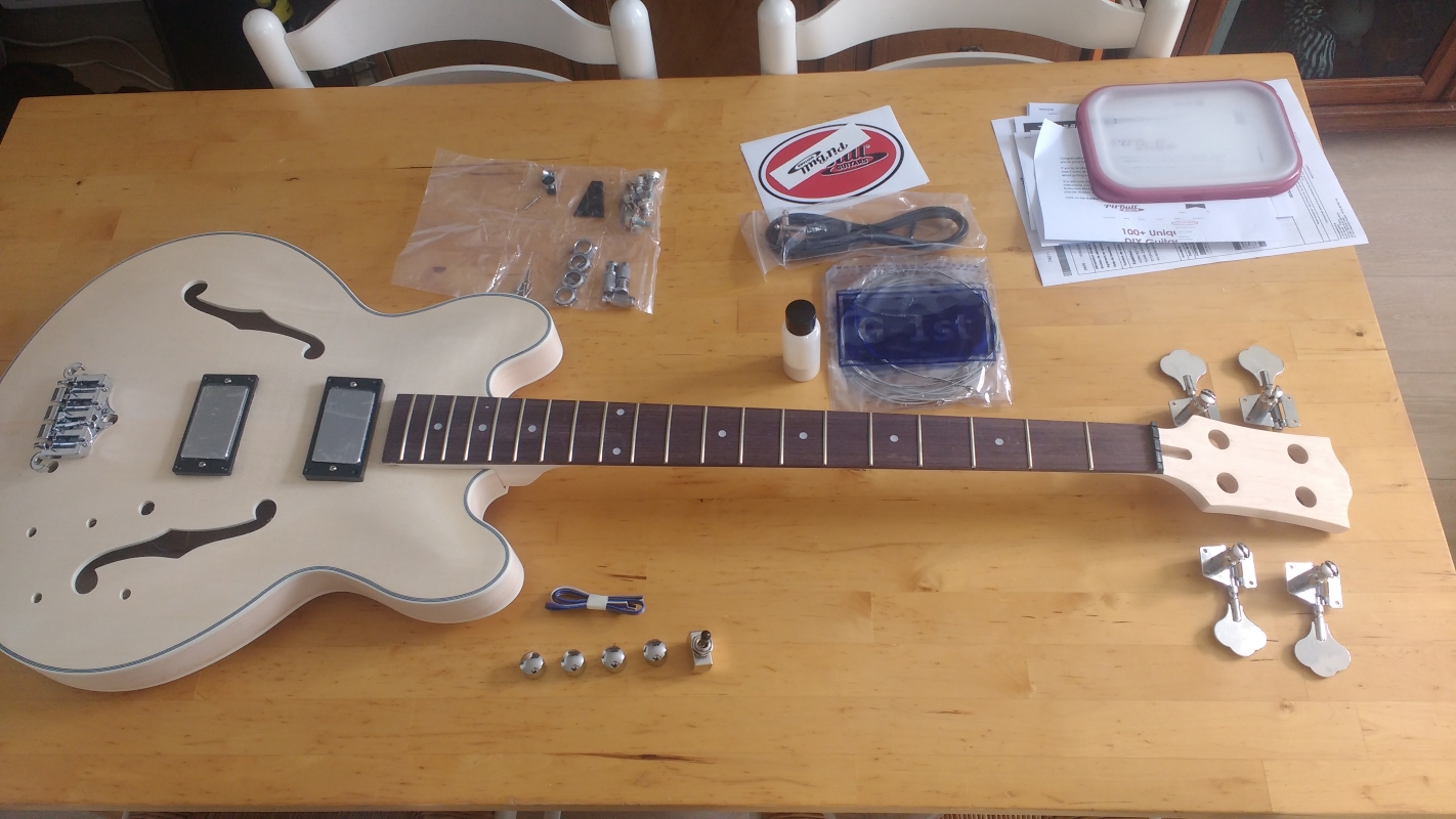

    First, I made a quick mock build and everything looks fine :

    #1 : I noticed a gap between the body and the end of the fingerboard : is this OK ? Or, will I need to do something, like lower the neck (or rise it) ?

    I'd check the neck pocket for any rough areas that are stopping the neck from sitting snugly in the pocket. You should find that with a small amount of sanding of the back of the pocket, the gap should become a lot smaller.
    There is quite a lot of intonation adjustment available on the kit bridge, so you shouldn't need to worry about that at all.

    Hi Roger,
    It is normal for the fretboard extension to sit a little bit above the top of the body. As Simon said, just make sure that the neck is fitting snug into the neck route. You shouldn't need to lower the neck.

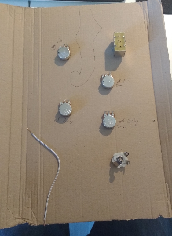

    I reproduced my bass holes :
    I will let 2-3 cm of extra wire between each pot.
    And won't forget the ground !
    Wish me luck
