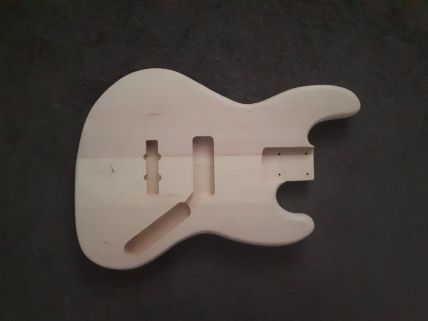

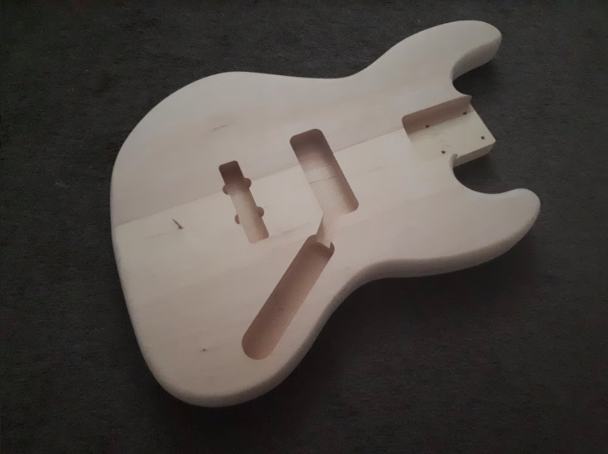

    To get things going I started with sanding. The overall body was already in pretty good shape so it didn't require too much work. Started with 120 to remove any imperfections and then moved to a much finer grit to get the body nice and smooth.

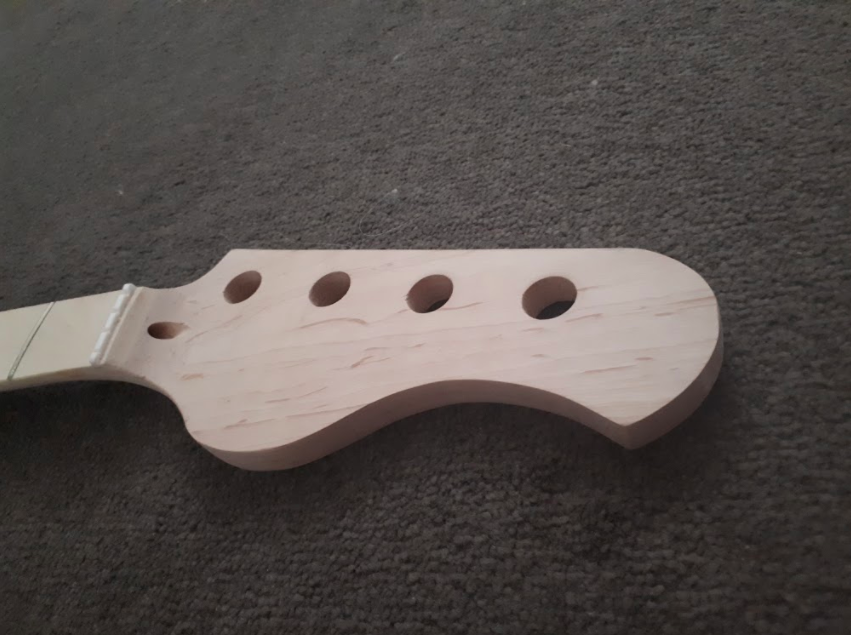

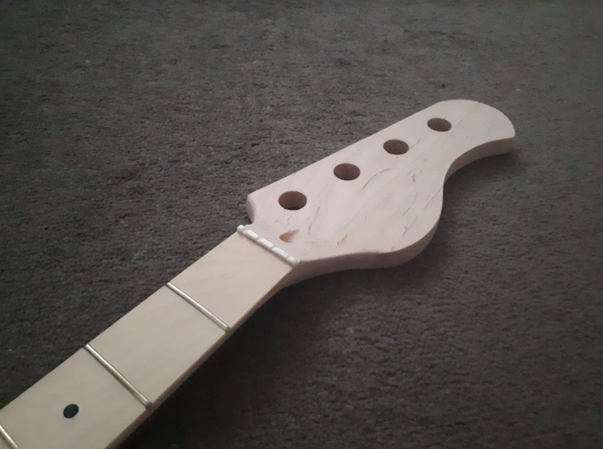

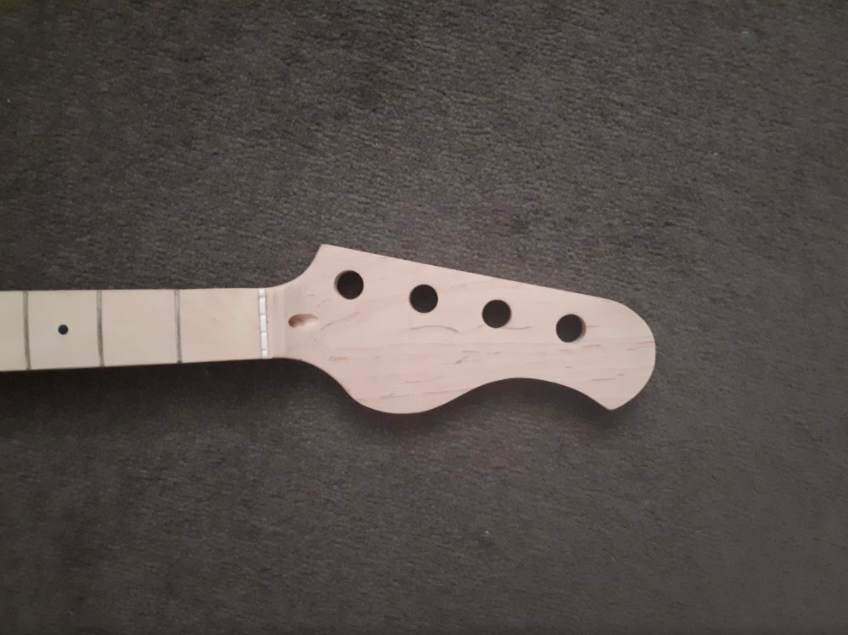

    Next I shaped the headstock. At first I did some rough sketches of ideas I had and once I was happy with the shape, I roughly drew the design on the headstock. To help get the curves right I used a random selection of circular things found around the house (measuring cups, pvc pipe etc).
    Using a jigsaw to cut out the shape started of pretty sketchy but got the hang of it eventually. One thing I was very mindful of was the tuners. I wanted to make sure that they still had plenty of spaced to be screwed on once the headstock was shaped.

    Welcome aboard Kevin! Congratulations on your choice of bass- they're great sounding basses and heaps of fun to put together. I'm loving the Sadowsky style headstock- classy as!
    I'll be interested to see what finish you run with. A black bass with a maple fingerboard would be very striking.
