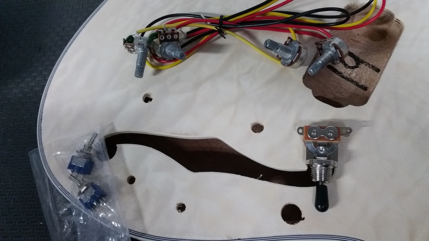

    I've just received the same kit and will put up some pics of mine to show what we are talking about if you don't mind.
    There is a bit of a mismatch with the supplied wiring and the control holes in the body.

    The biggest hole is for the selector switch, the two holes on the bridge side of the f-hole are for a volume and tone (one of each) and the smallest holes are for the coil split switches. The pickups are two wire and not able to be coil split as they are. It's up to you if you want to coil split or enlarge those holes and just have two vol and two tone, just make sure the pots have room to fit next to the side of the body (inside the f-hole) before you get the drill out. As for wiring the mini switches, not sure about that, if our resident wiring guru Weirdbits sees this he can shed some light on that for you (and me).

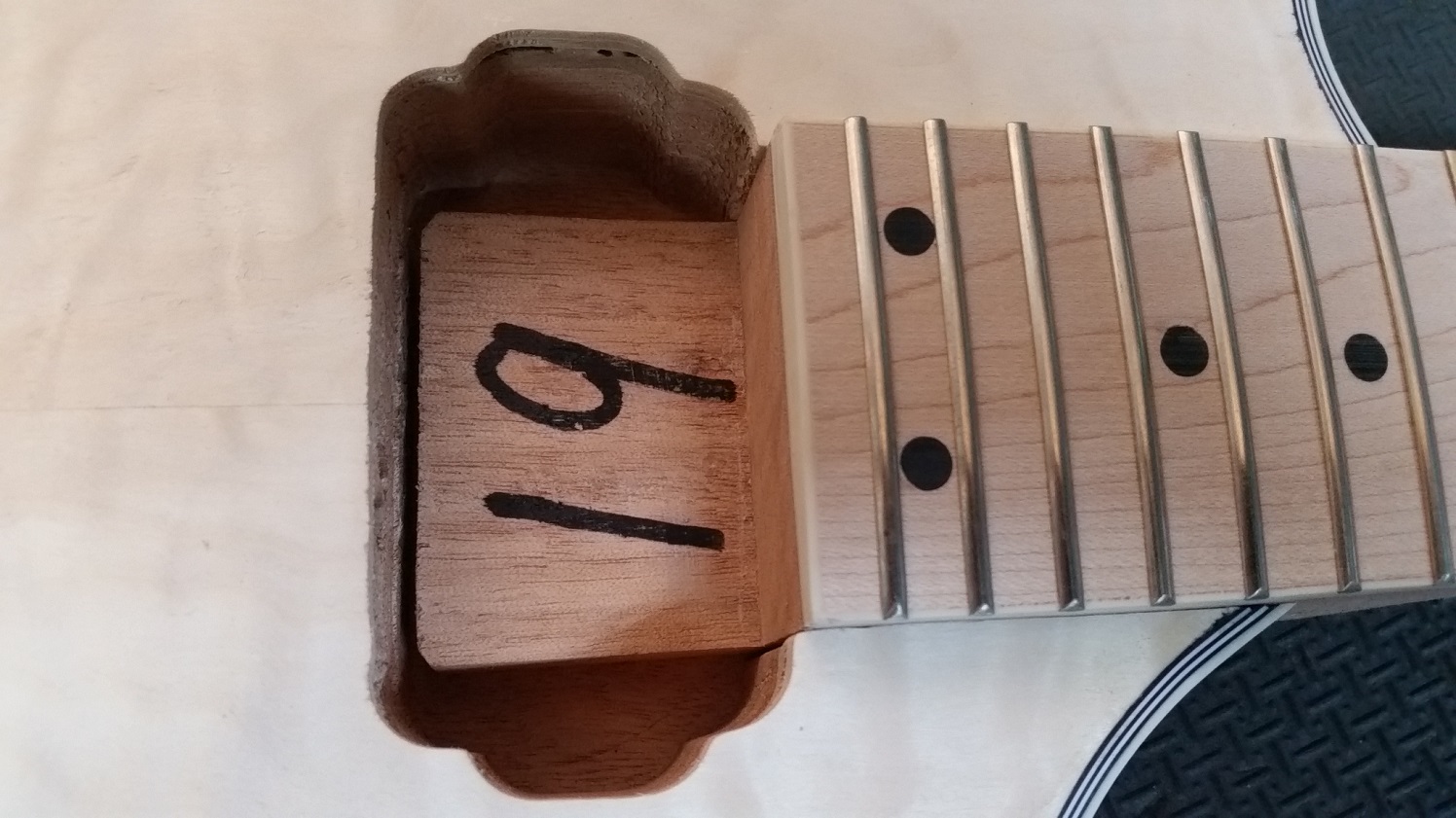

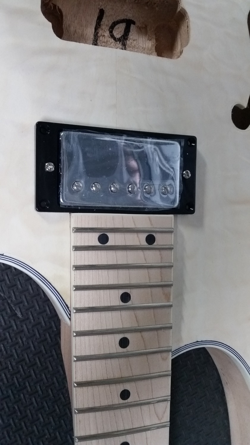

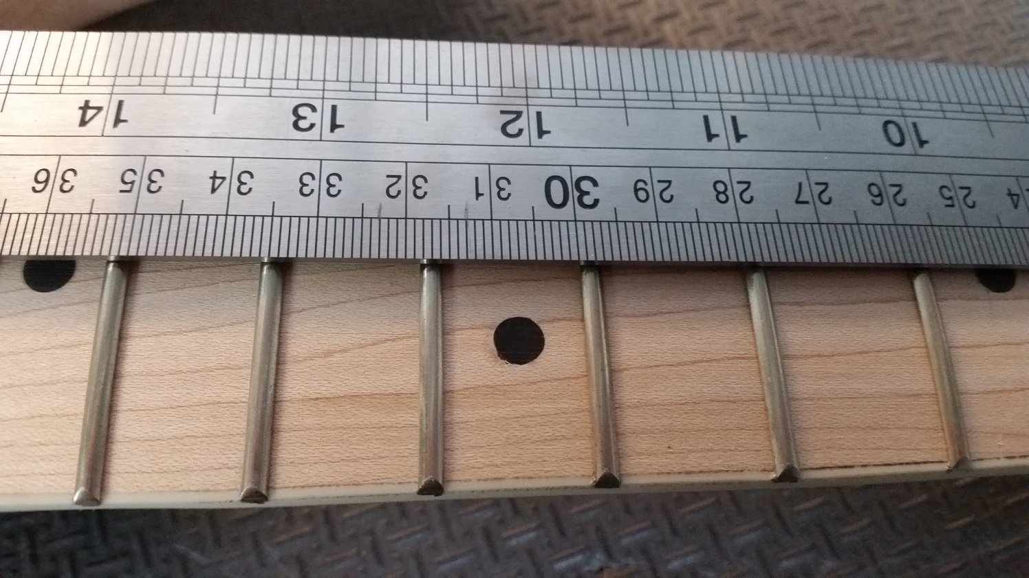

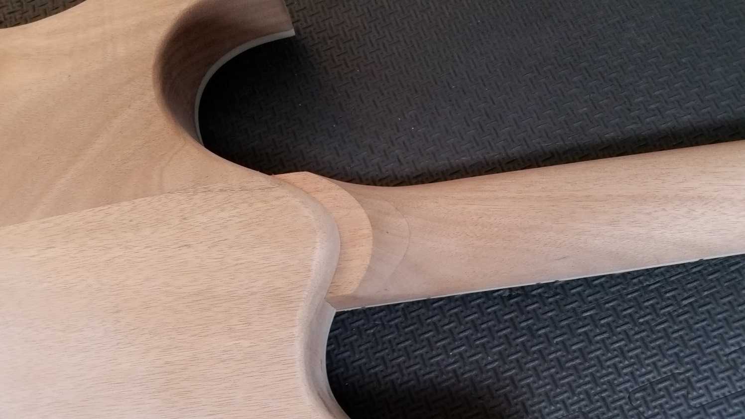

    By my measurement the scale length is 25". Did a quick mock up to give an idea where to position the bridge.
    Put the neck in the pocket and sit the neck pup in place making sure the mounting ring covers the rout and push the neck firmly against it.
    This is what it may look like with the pup removed, and from the rear.

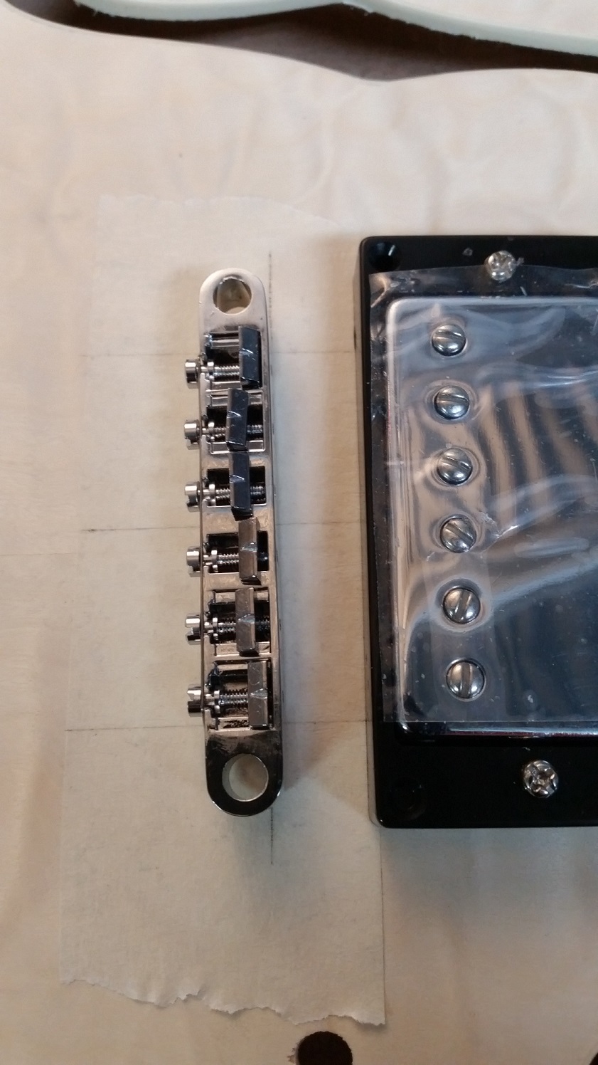

    And where the bridge will sit behind the bridge pup.
ID:	24189Click image for larger version.
    Don't take this as gospel, measure measure measure yours to be sure you get the bridge in the right place, also the low E side post hole needs to be set back slightly to allow for proper intonation. As the kit description said these are for more experienced builders because of the need to drill the bridge and fixed tailpiece post holes. You may be more than capable to do all this, just don't sand the veneer much at all, it is very thin and you can sand through surprisingly quickly.
    Oh yeah, add lots of pics when you have something you're not sure about, or just to show how it's all going.
