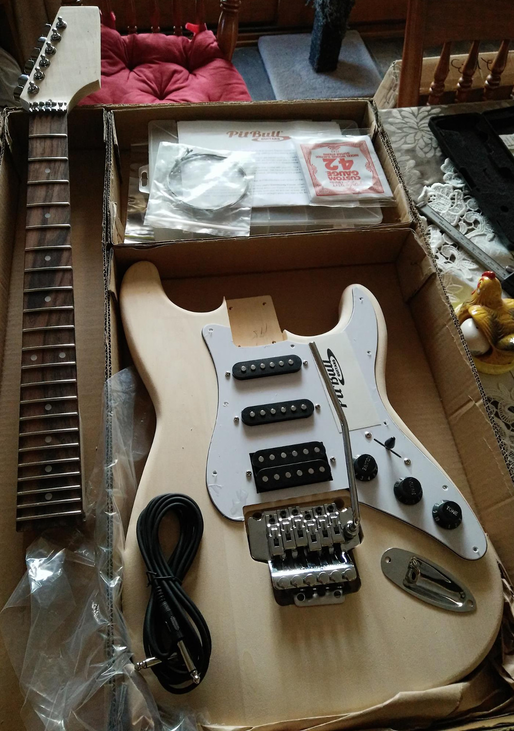

    Kit partial assembly

    On the Controls image, you can see the edge of the jack cutout thru the screw hole. I'll see if i can adjust the jack position, and do some undercut carving, to give the screw more purchase. Also, the tuner holes seem over-large, 10.3mm diameter, and the pegs are 9.6mm dia. they rattle around a bit.
