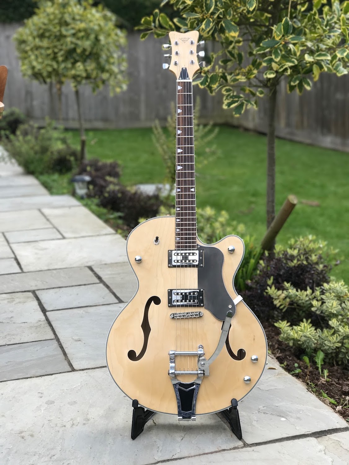

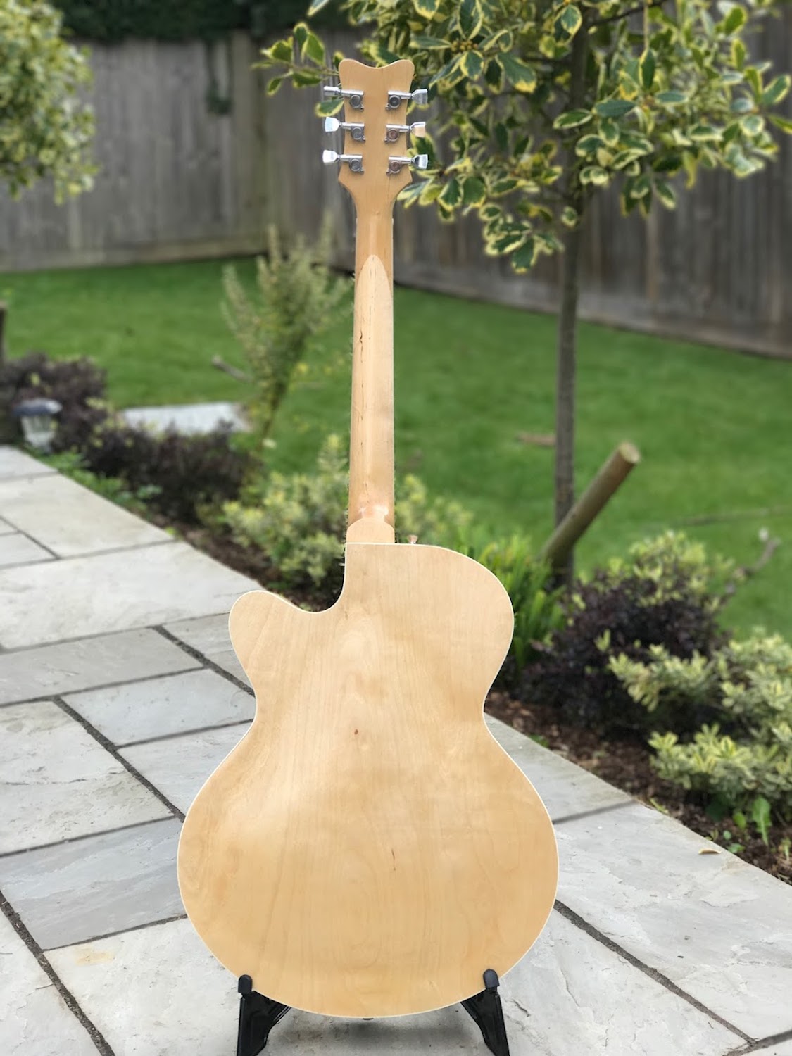

    Here's my entry - the main work was finished by the beginning of August, but I've let the guitar bed in and and have made adjustments and modifications since then.
    This is a GR-1SF, basically stock. The two modifications are a bone nut and a roller bridge. The finish is natural with just a light touch of Tru Oil - four coats each on the body and neck. I like the satin finish and that the texture of the grain is still visible. I expect to touch it up with new coats from time to time.
    I'm sticking with the stock pickups for the moment - I was pleasantly surprised at their tone. They're not as hot as some of my other guitars, but there is a simple answer to that - just turn up the amp.
    I was also pleased with the quality of the components for the most part. The pickup holes are a bit off centre, so the low strings don't land perfectly on the poles, but I haven't really noticed it affecting the sound all that much. I've noticed that on photos of some of the other builds.
    Front view:
    Back view:

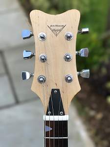

    Headstock:

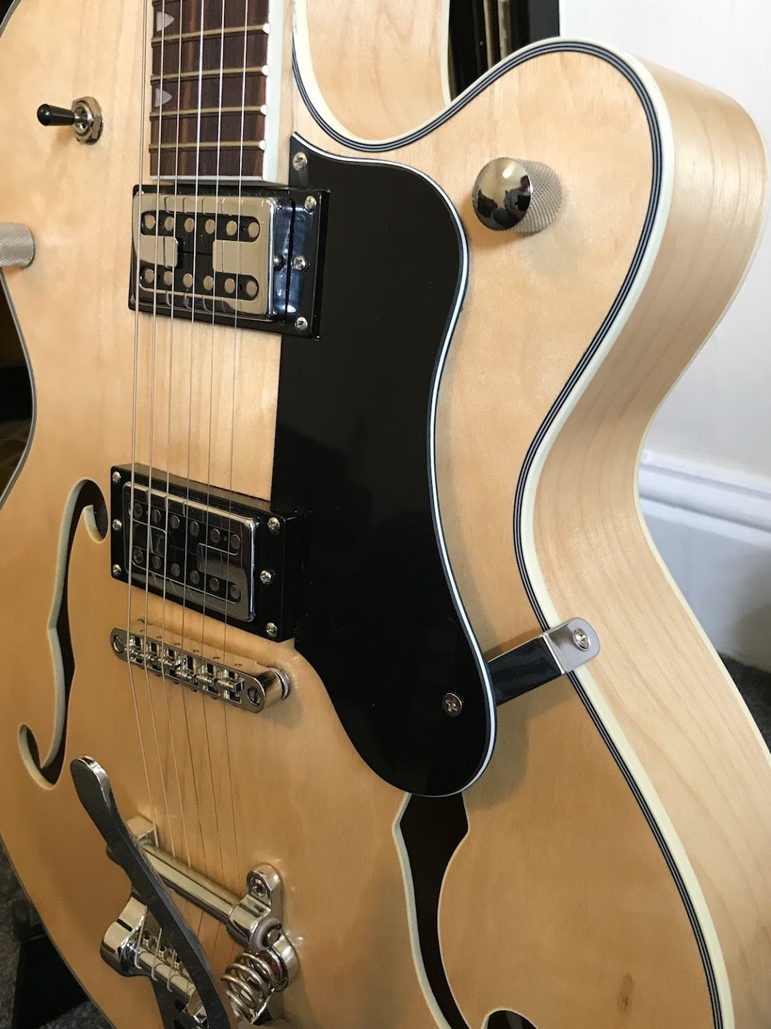

    Body finish and build:

    Great looking build Jmax! I'm yet to start my own (and first) guitar build and I like your timber finish very much. Am I correct in understanding that you have only sanded the surface of the guitar and applied try oil? Nice work!
    Member jmax's Avatar
    Oxford, UK
    106
    Thanks! Yes - the approach I took was to do a lot of sanding to get the wood nice and smooth, and then four coats of Tru Oil. I wanted the grain to show, and to allow the body to breath to really get the hollow body resonance. Originally, I only did three coats of Tru Oil on the neck because the maple is so dense, but I recent added a fourth. I think I'll be adding a fifth coat to the body the next time I replace the strings. It's been amazing to experience the process of this guitar "settling in" over a couple months after I finished the build.

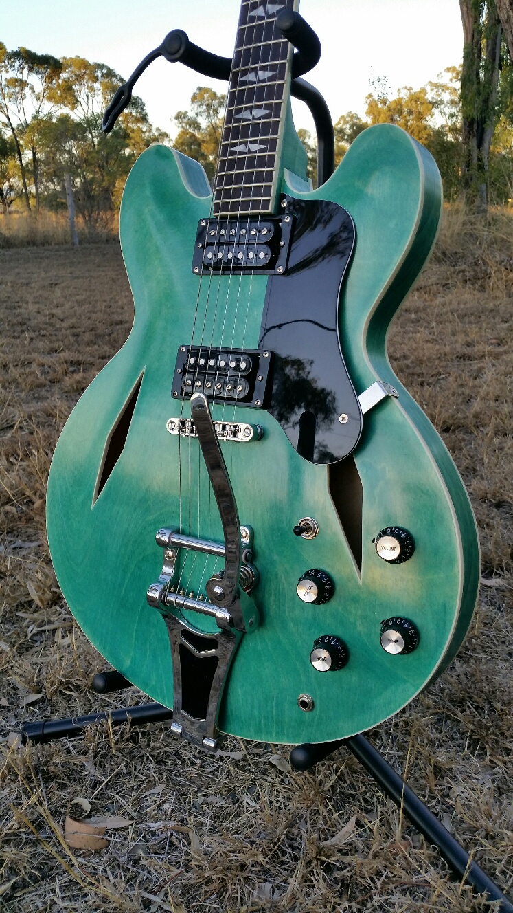

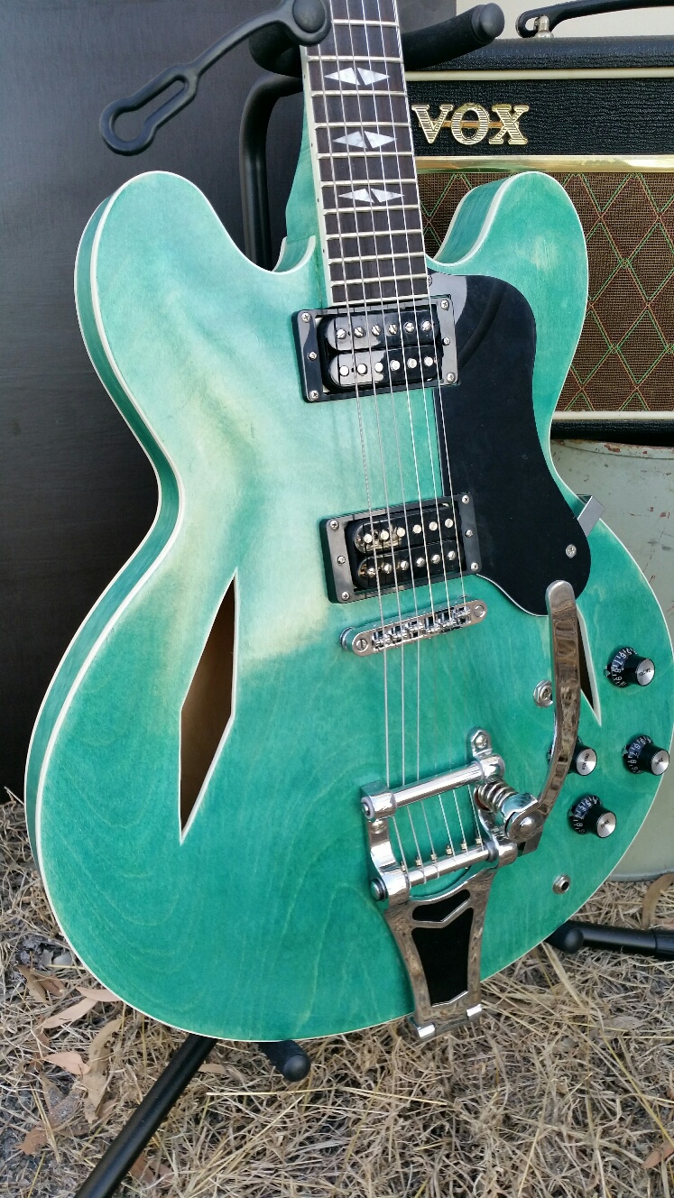

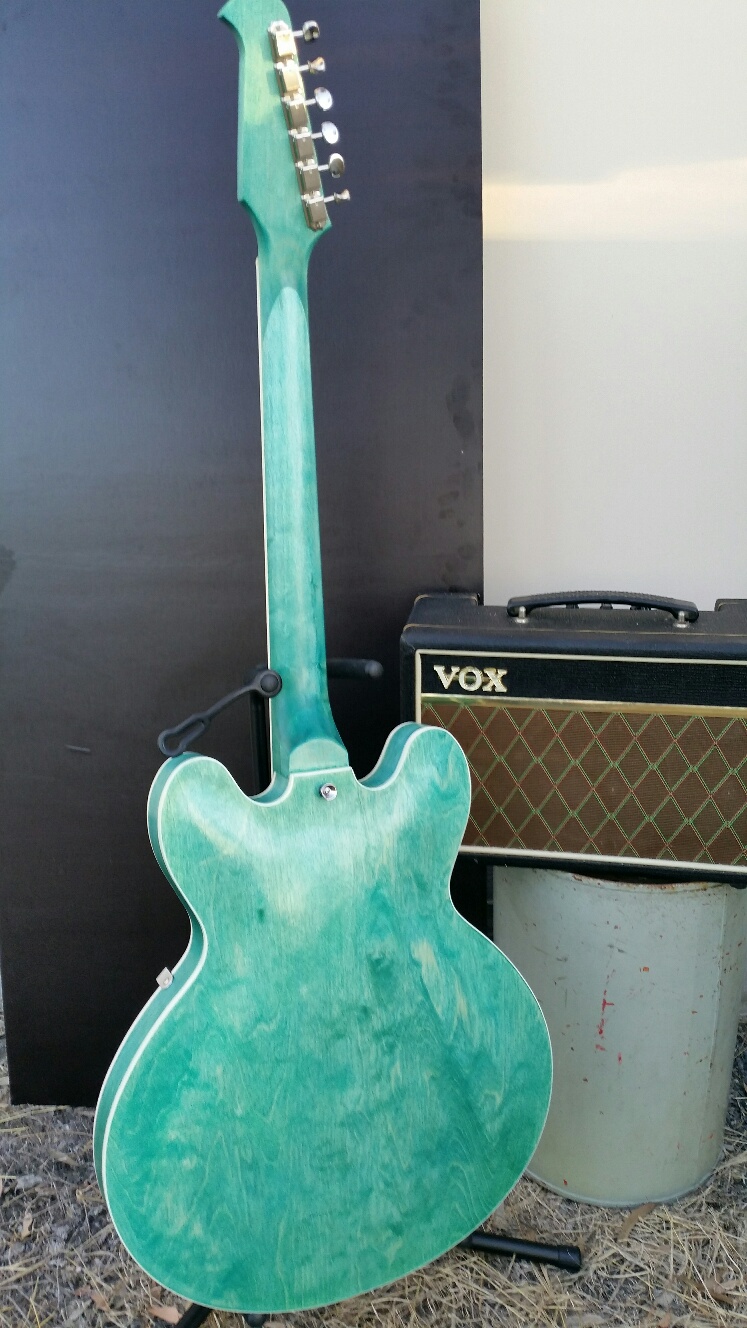

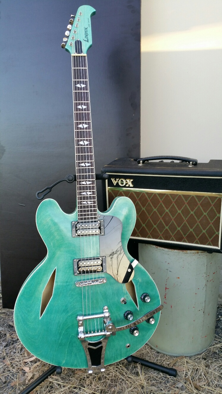

    I offer for consideration my ES-1TL build.
    Features...
    Waxed hard Shellac finish over U-beaut Green then Blue water based dyes.
    Tonerider Alnico AC2N and AC2B PU's
    Kluson vintage tuners,
    Bone nut
    Bigsby copy tremolo system
    Realtone roller bridge,
    Triangle markers on all controls
    Ernie Ball Regular Slinky strings 010/046.
    As I got my new TC electronics polytune 3 earlier in the week I decided today was the day to do all the final adjustments to this build, being intonation and nut adjustment.... and then spent the next 3 hours with it plugged into my AC15 clone build discovering for myself why a certain front man individual likes this kind of axe so much that he has his own line of them at Gibson. With the volume controls backed off the Tonerider AC2's certainly have the clarity to articulate very nicely, and when wound up will give the amp plenty of sweet meat to cook and listeners to munch on. I started with cleans, which quickly digressed with tremolo on the amp into 'House of the rising Sun', then onward with incrementally more gain and less tremolo to I'll let you guess where...
