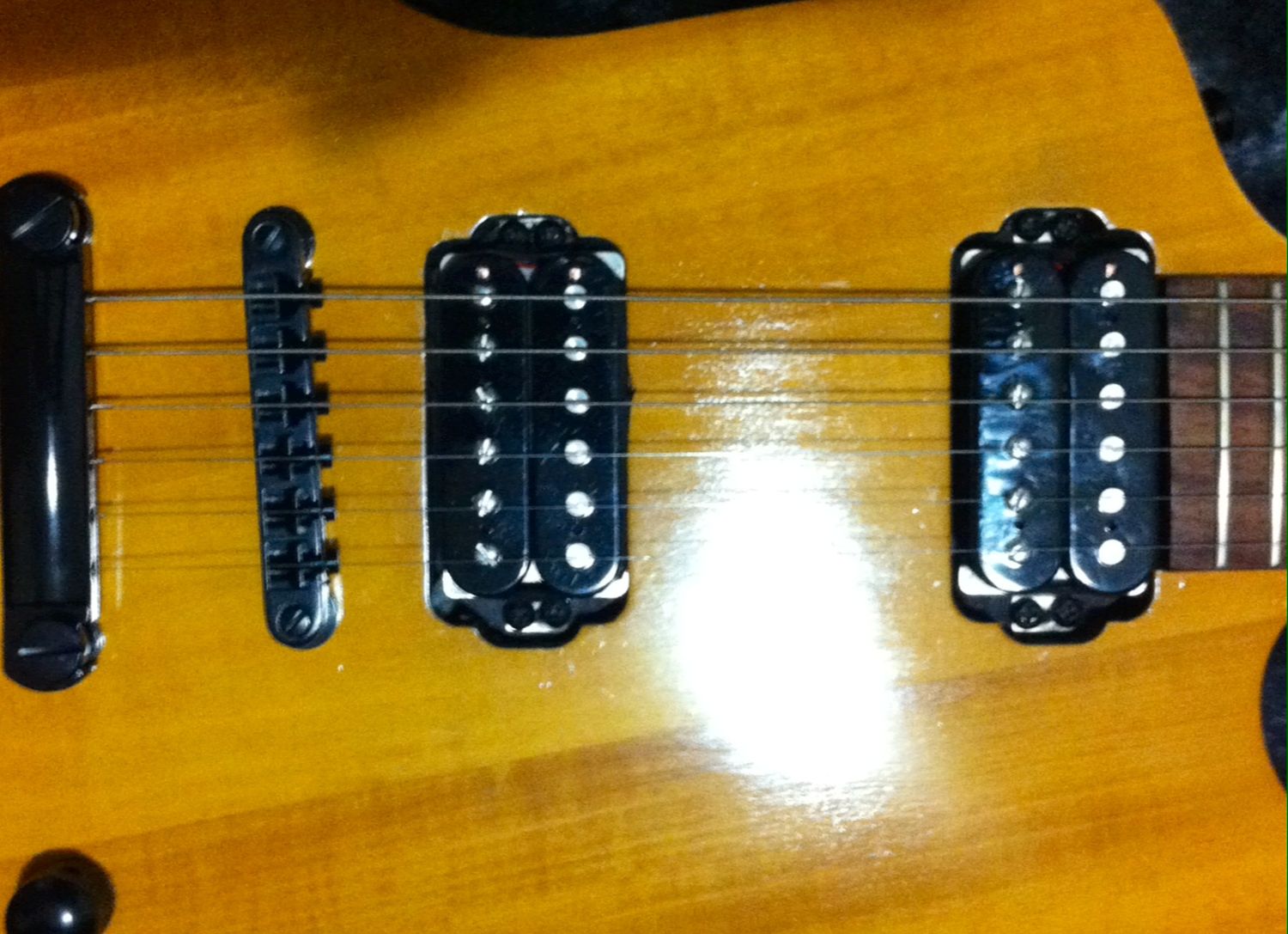

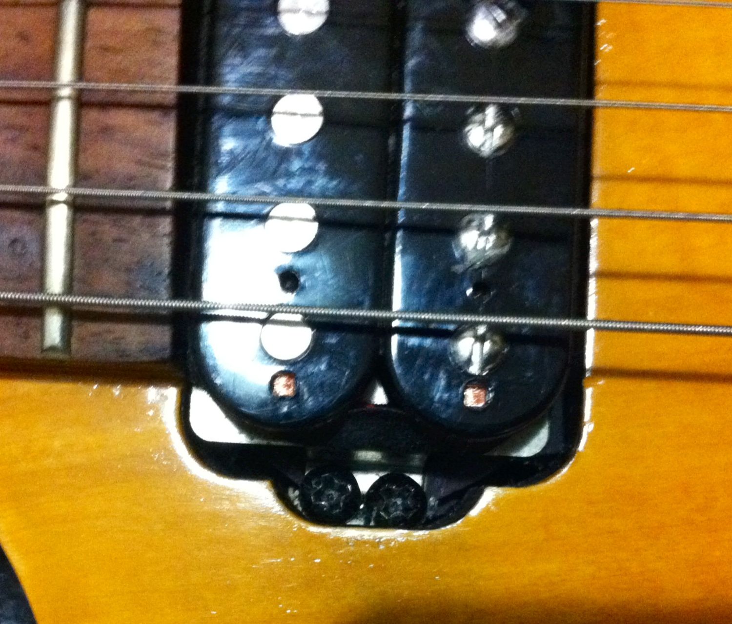

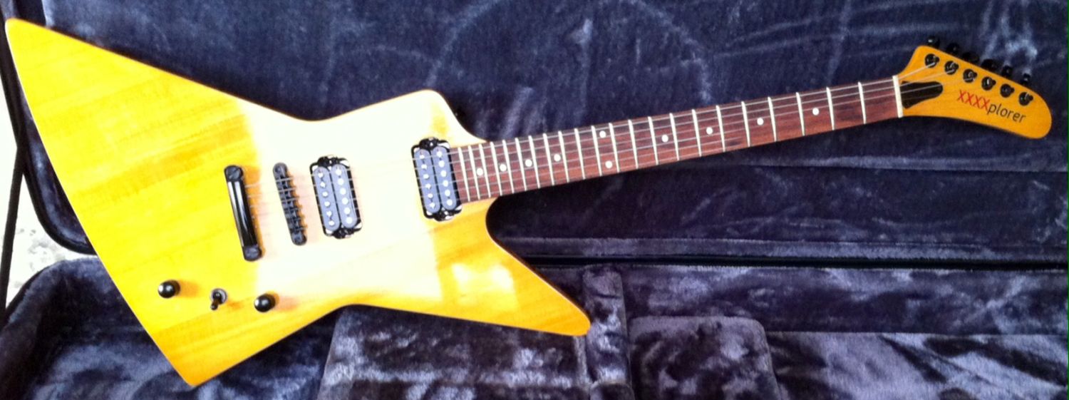

    The way I went required filling the deep side holes with rounded off timber to fit the unusual shaped holes and purchasing longer pointy nosed screws. Also delicately drilled 2 fresh holes ether side of the original mounting screw hole just in case I wanted to swap them out at a later date. No springs were used and I may have placed some high density foam underneath. Memory is a bit sketchy as this was done around 18 months ago and done 4 more builds since.

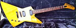

    These shots might help....
