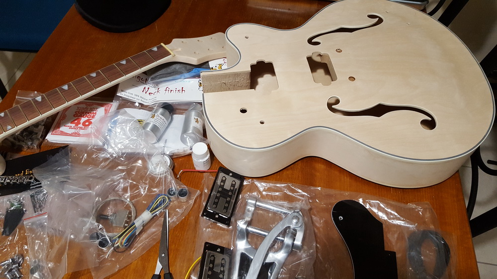

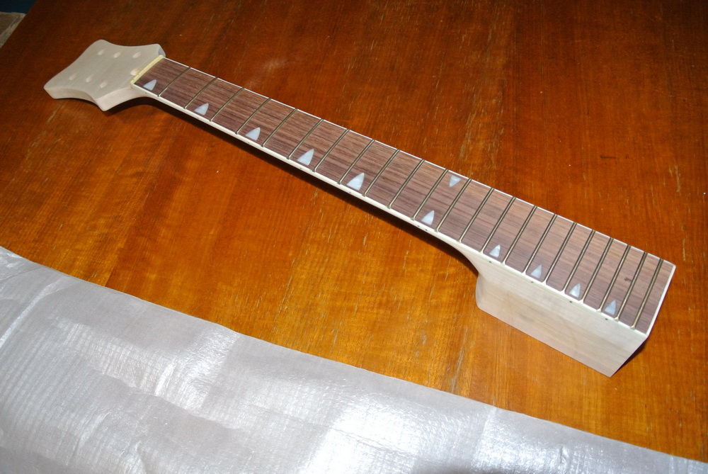

    The kit arrived on the 23rd August 2016, almost a year ago. Here's some shots of the inventory (even though you've probably seen it all before, eh):

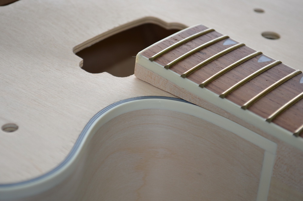

    Here's a shot of attempting to test-fit the neck. This was as far as it would go and I didn't want to force it. For the time being I left it, but I tried again a few days later and managed to get it in (more shots later on).

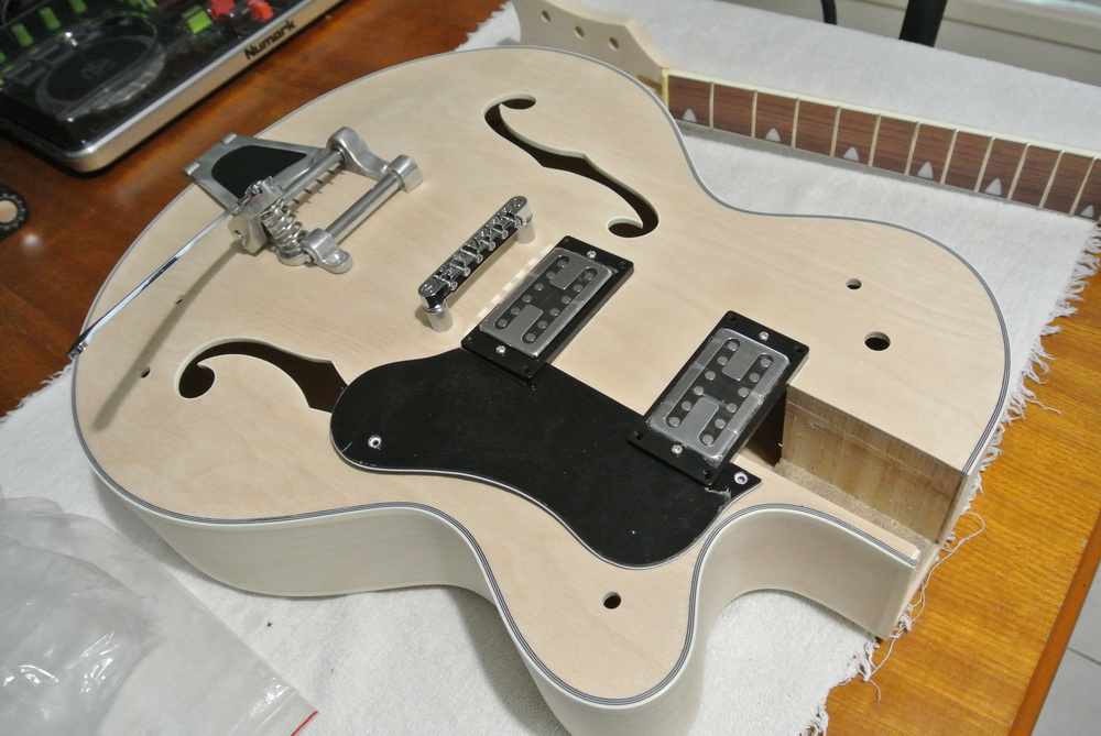

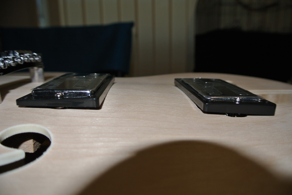

    A shot of the pickups how I would have thought they'd go - not sure which one is which. I would have assumed the one in the thicker mounting ring is the neck position, but it has the higher resistance (12.2k, red wire) which I would have thought would be the bridge pickup. The other one, in the slimmer ring, is 11.5k (yellow wire) which I would have thought would be the neck, but putting them in like that, the brige pickup is too high. Anyone know which one is which?

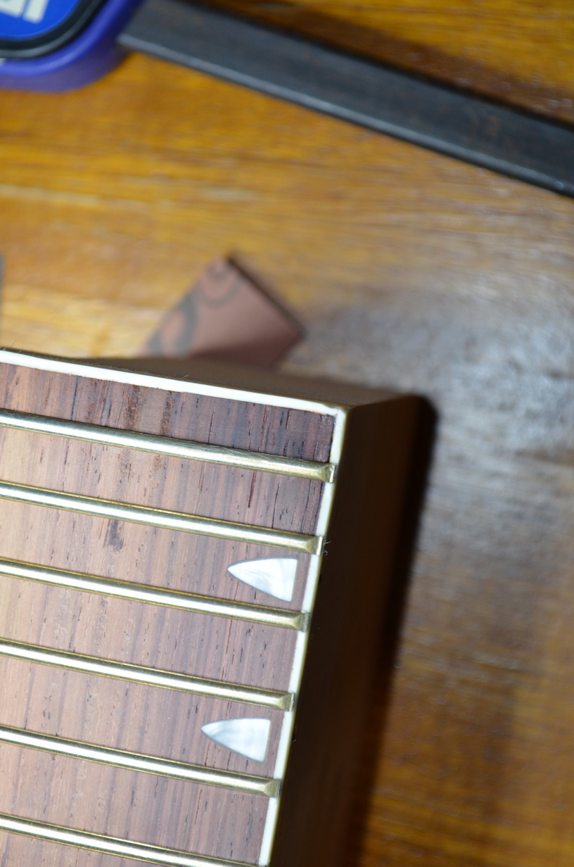

    A few days later, while I had the parts out on the table, my daughter managed to knock the neck off the table, and it fell on the top corner of the heel end. This necessitated some repair work unfortunately, and there is a small chunk missing from the binding now :-(

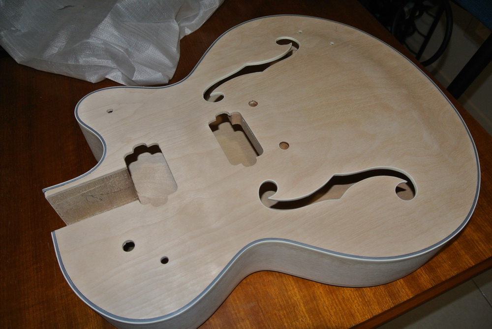

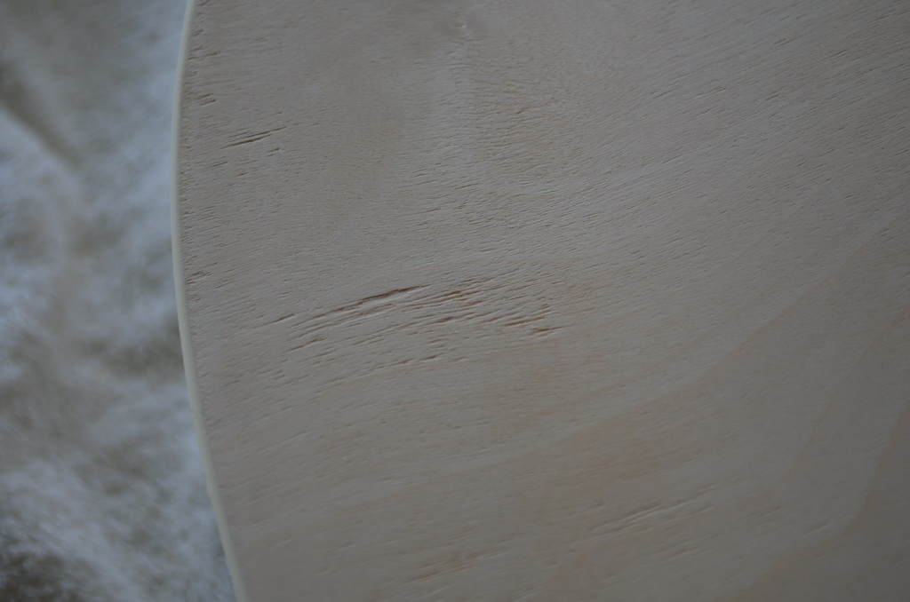

    At this point, I did a fair bit of body prep, spent a whole day sanding the body to smooth it out. After a bit of sanding, I realised there were some areas in the grain that would need filling:
    and

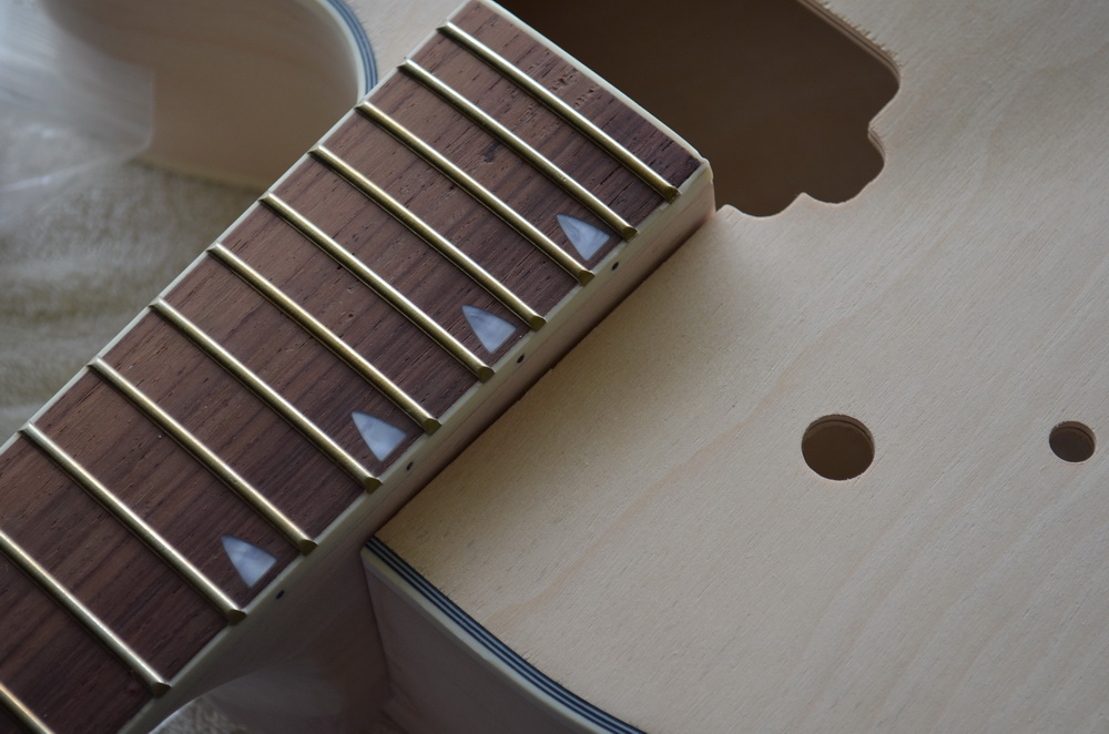

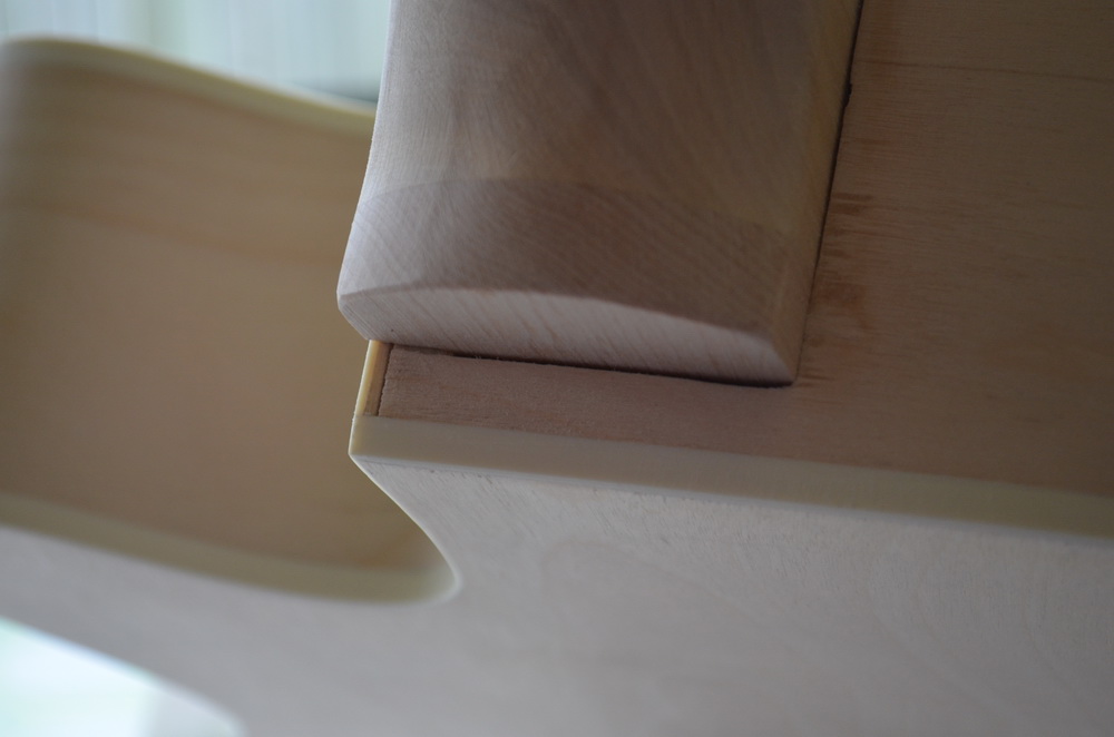

    Here's another attempt at fitting the neck. It eventually went in, but I'm not particularly happy with the fit - as you can see there are some large gaps around the heel.
    and

    ... another shot of neck fit:
    Is this typical? The gaps seem quite large to me. Happy to fill them in, but I was planning to do the body in one colour, and the neck in another, doing them separately until near the end. Was planning to basically finish the body totally and fit the electrics before gluing the neck in. Filling at that stage would mean more sanding and colouring, and it would be hard to get a nice straight line demarcation between the body and neck colours.

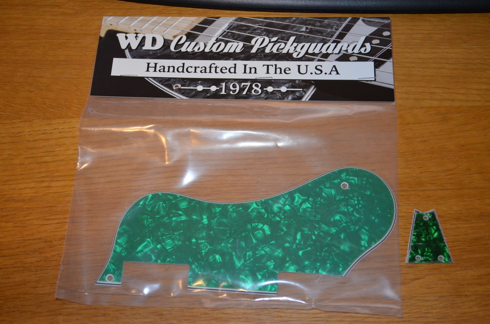

    Pickguard from WD Music and Chinese eBay truss-rod cover:

    Pickup rings slope towards the neck. Thicker ring is the bridge pup.

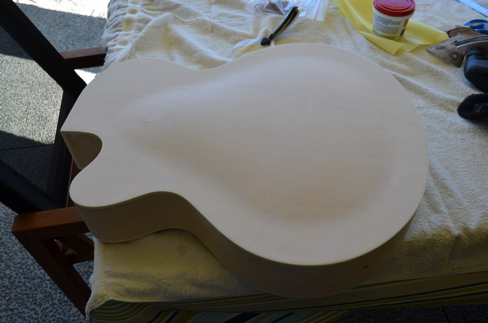

    So, after 10 months in the box, out she came again. After the amount of effort I put into sanding and smoothing back 10 months ago, I was surprised to find that the grain had lifted in a lot of places and was very rough. Waste of time by the look of it. So, started again.
    Here's a shot of the grain-filling process for the back of the guitar. Figured as I'd never done it before, it made sense to do the back first....
    I am using Timbermate, from Bunnings, in natural finish, i.e. no colouring. It's sort of sickly grey colour in the pot. I mixed it with a fair bit of water to make it into a custard-like consistency, so that it would soak in and fill the chips easily (it is way too thick and dry straight out of the pot). It took a fair bit of mixing, even though they (Timbermate) say that it can be thinned with water, it's reluctant to thin out, and difficult to remove the lumps.
