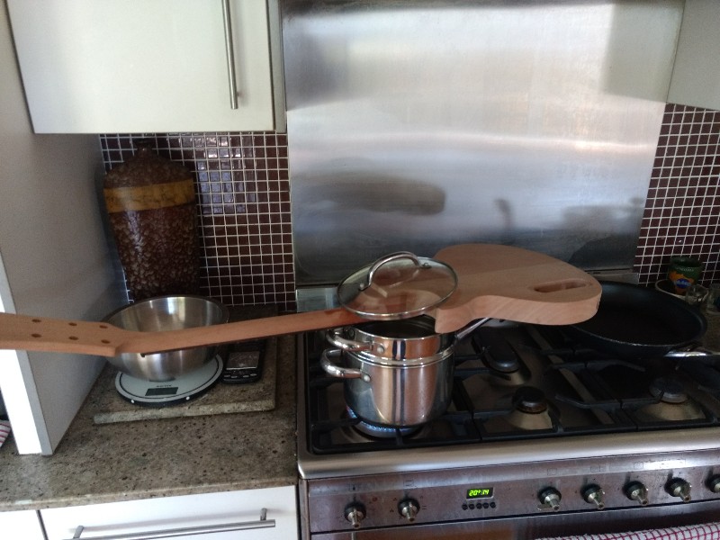

    What's cooking??

    gee that's keen Mike, hope the body/neck was well balanced and the neck didn't fall out of the pocket. You even got the gas turned on. Look forward to seeing some pics of the kit you scored !
    Member Big Mike's Avatar
    Jul 2016
    Brisbane
    30
    Lesson learnt. String up the e strings BEFORE you glue the neck, not AFTER. Luckily she prised apart with a bit of steam and a paint scraper.
    ah is that what you were doing Mike, the photo makes more sense now. Make sure you line up the string offsets take 2 !
    Big Bawls my man. great save

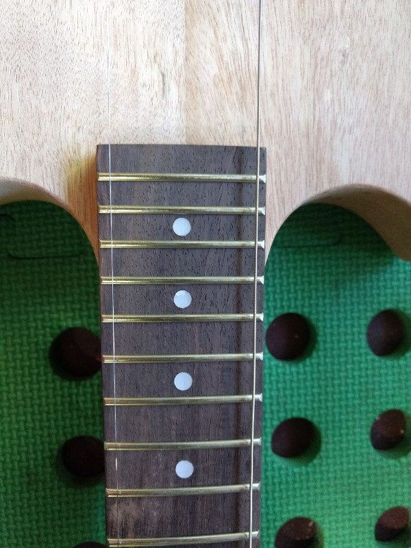

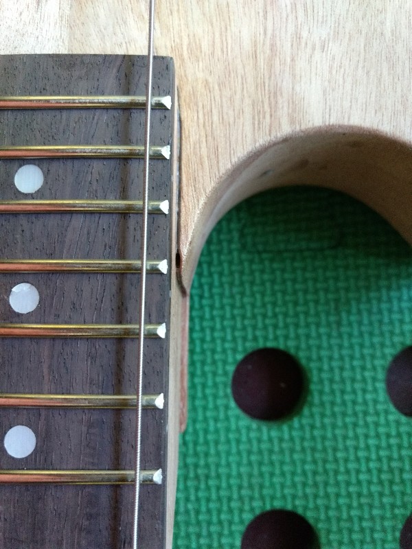

    Glued her back together, this time with the e strings attached. This is as even as I could get it. Strings still look a little too far from the edge for mine, but they are even compared too each other. There's quite a big neck pocket gap on the bass side. I'll try and fill it in with timbermate I guess. 🤔

    Mike that looks fine. The main thing is there is plenty of fret for the E strings. The small gap in the bass side of the pocket see if you can find some thin veneer you can shim the gap. Otherwise fill it with glue or timbermate. Does this kit have a wraparound bridge ?
