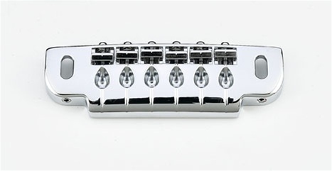

    2. It depends on the type of wrap-around bridge. You've got your basic rounded top (very original but never great for intonation), one with pre-set raised sections to give you better intonation, or one with fully adjustable saddles, such as the Gotoh 910 shown here:
    This will give you the same adjustability as a tune-o-matic would.
