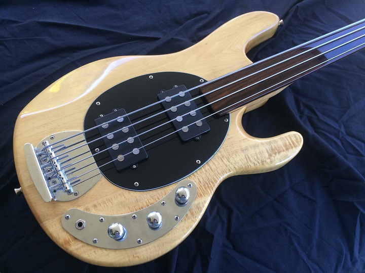

    Hi Guys, just a quick upgrade I have done to my MMB-4 fretless. I’m only posting this in case it can help someone else if they are heading down the same track.

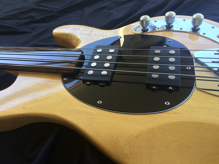

    I was never satisfied with the tone of the original pickup. I think the standard kit probably has a ceramic pickup and it sounded tad thin for my “old school” mellow approach and I wanted something closer to my Fender Jazz. I can’t afford expensive boutique type pickups so I went with 2 Guitar Fetish pickups with Alnico 5 magnets.
    To say I was disappointed with the outcome would be an understatement. This is not a criticism of the GF pickups but because I used the kit’s standard 250k pots. The 250k pots combined with the new Alnico pups made the bass quite dark and muddy. So I have replaced the standard pots with 500k ones and it now sounds closer to what I was looking for.

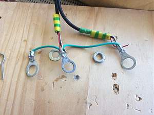

    I made a quick wiring loom that includes 3 ring terminals, so that if I do swap pots I will not have to solder an earth to the body of each pot and that should make changing and experimenting with pots a lot less painful. I have never been happy with my soldering ability and am always concerned about applying too much heat to the body of the pot.
    This is the quick and dirty loom

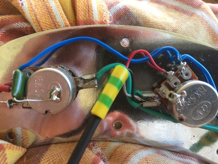

    And this is it all soldered up showing 2 of the 3 pots. So now to replace a pot all I have to do is solder the terminals of each pot and chuck it in the guitar. The ring terminals will earth each pot to the control plate. (The more astute among you may notice that I had wired the tone pot incorrectly. D’oh, I told you I have never been happy with my soldering abilities. Lol)

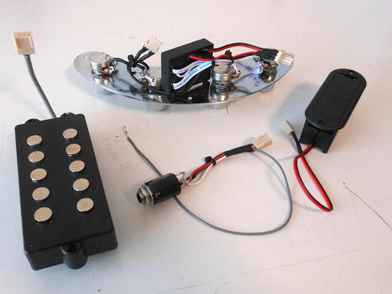

    Nice bass there Rob...
    I think the inclusion of a pre-amp is the best investment to be made to the tone of a kit and being much cheaper than upgrading pickups, perhaps the first option. I purchased a Belcat EQ B2T under NZ$30 including freight, and in my opinion more than makes up for any perceived shortcomings of stock PUPs.
    With 3db of flat boost, and +/- 12db of boost/cut @ 85hz and 7khz, it was a real transformation to my old school (1980’s) passive Ibanez SR600, and consequently I’m installing one in my MMB 5 currently under construction. I'm configuring the humbucker for individual coil/parallel and series options, so in conjunction with the pre-amp it should cover pretty much all tone requirements.
    Not too late to try one perhaps...
    Cheers, Ralph
