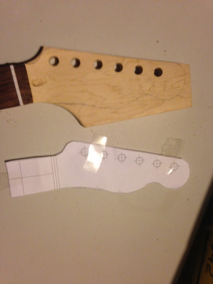

    Headstock work
Name:	headstock pre cut.JPG
    Pic of the headstock and template I used

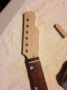

Name:	headstock rough cut.JPG
    Rough cut of the headstock with a jigsaw

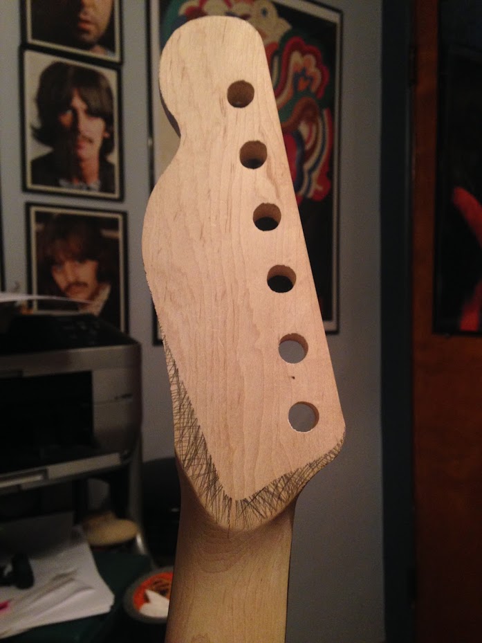

Name:	headstock rear pre shaping.JPG
    Rear of the headstock pre shaping, penciled in areas were removed and was squared off

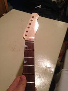

Name:	headstock front 5 coats.JPG
    Front of headstock with 5 coats of truoil

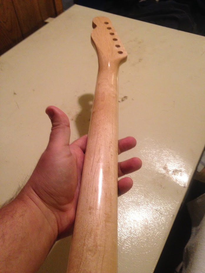

Name:	Neck 5 coats.JPG
    Neck with 5 coats of truoil

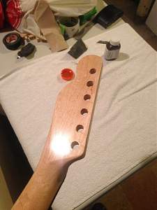

    rear of headstock with 5 coats of truoil
    sanded to 600 grit prior to application of truoil
    and 0000 grit steel wool between coats of truoil
