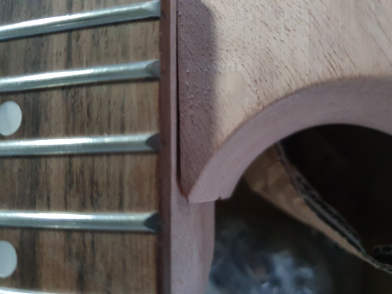

    the first thing i noticed is that there is a small gap between the neck and the body. It looks to be about 0.5mm on either side.
    I'm not sure how much of an issue this is, but looking for advice. some other posts on the site recommend using a thin veneer as a spacer?
    see image below:

    Hey Michael welcome!
    Fellow lefty here,.. can be a pain right?
    The neck of my TL has a similar spacing but it is a bolt on neck. I was advised not to worry, but with a glue in neck I personally would use veneer to create a better bond. Check your bridge position first before you sway the neck one way or the other.
    Good luck!
    Welcome aboard MM! My first kit was an EXA-1 some 7-8 builds back. Look forward to seeing how you go with it.
    +1 to RocknROlfs statement, wrap some masking tape around the bridge studs to get them to sit firmly in their mounting holes, then mount your bridge and check your neck alignment before you move to shim or glue anything.

    Given your location, I'd give it a week or so for the wood of the kit to settle before making any decisions regarding filling gaps etc. The various woods in the kit can expand/contract at different rates with a major change in environment, altitude etc, so you may find things will alter a little over some time.
    Thanks for this info WeirdBits, its makes a lot of sense, i assumed that changes in humidity and altitude would affect the would but didn't know how much. Will keep my eye on it for a week while i sand the rest of the body nice and smooth
    I've just gotten home and noticed some cracks in the body along the glue lines where the pieces are glued together. I can only imagine that it's from the change in humidity ( it is very dry where I am) . Any idea on what to do?
