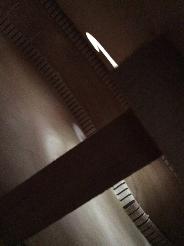

    Quote Originally Posted by AndrewA View Post
    Attachment 16068
    For those thinking of building one of these for acoustic playing, you may want to rethink your plans. The soundboard is supported by a block of wood from back to front, instead of tone bars like most full hollow-body arch tops. This is probably to stop the feedback usually produced in these guitars. Having said that, tapping the top sounds ok. It would probably sound fine if all you want is to practice while the kids sleep in the next room.
    I'd like to avoid pulling apart the body if I can help it. Also, would it be possible to get a GR-1SF with only the F holes and neck pocket routed? I'm not concerned with time frames at this point. I'll need time to come up with the money and talk things over with my other half
    thought you might find this pic interesting. It shows the blocks and bracing inside a real Gretsch
