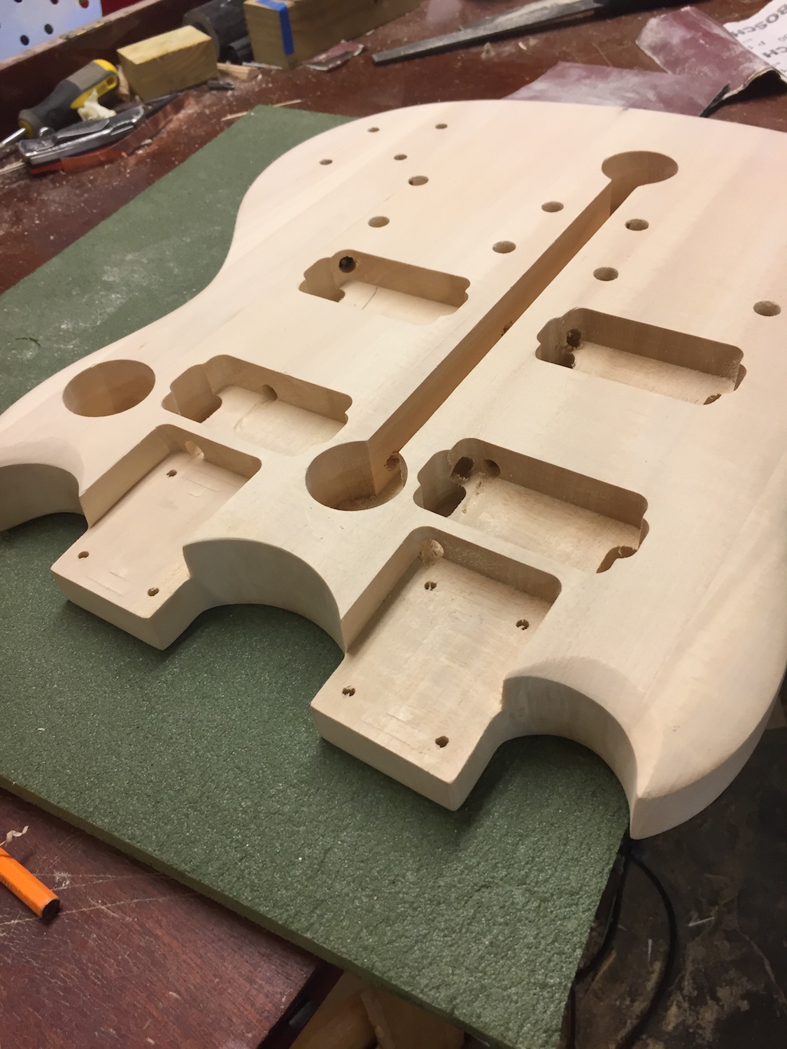

    It has finally arrived! my sgd612 doubleneck.
    After finishing my first build (a 12string tele) i orded a doubleneck, as i always wanted one.
    Out of the box it looks kinda rough, alot rougher than the tele, but i think i can smooth it out quit a bit.
    I'm thinking about finishing it painted all black but that can change along the way and i hope for some ideas from you guys along the way, maybe staining it instead, time will tell
ID:	20538 Click image for larger version.

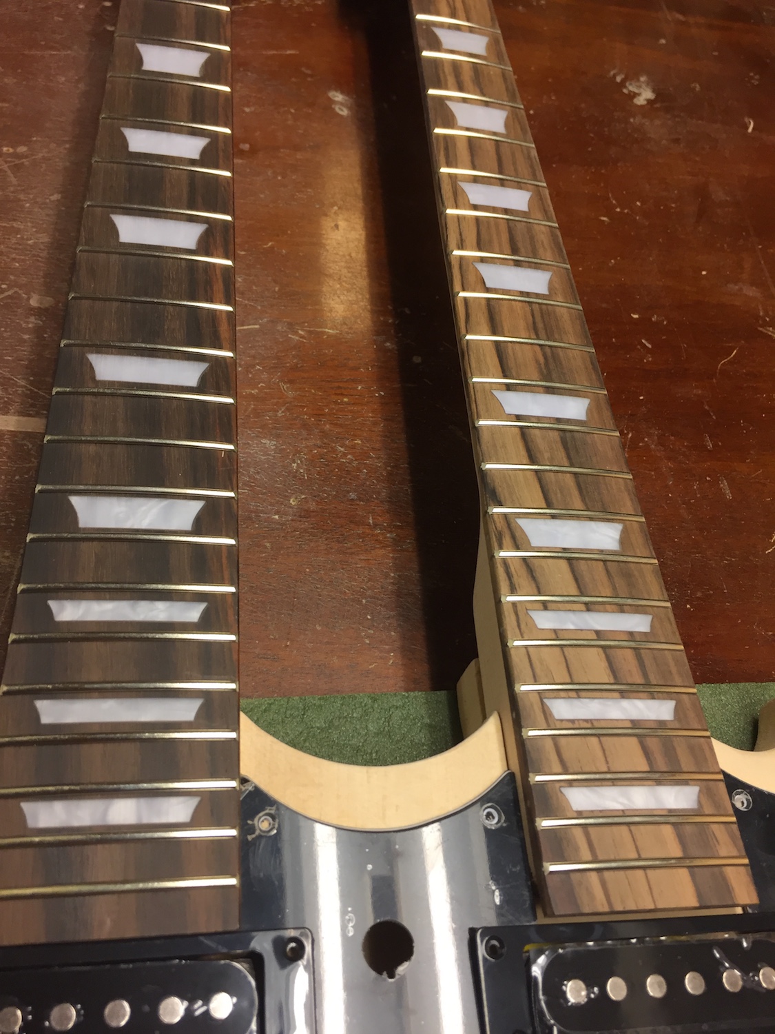

    I do like the grain on the fretboard tho, but the frets needs some work.

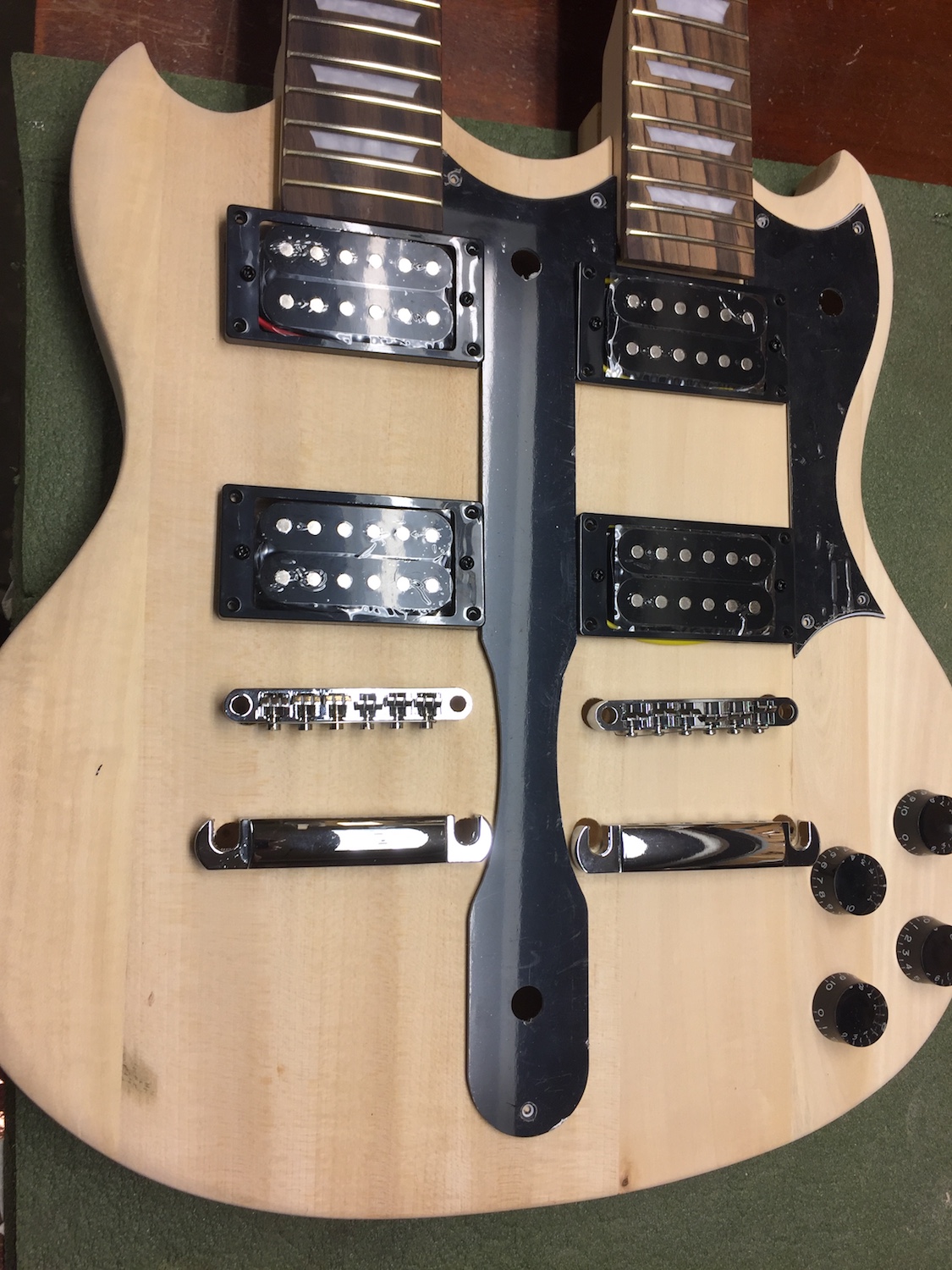

    Oh very nice.....doing the BG 46 kit myself. First step....talk with weirdbits about what you intend to do with electronics. Your kit appears to have three switches.....mine has two.....made it a little harder.

    on closer inspection of the necks i found out that it needs some sanding, its quit a few marks and dings on em.
    what is the best way to go about doing it. Do i need to remove the frets sand it down and refret or can i sand across the grain so that i dont have to do a complete fretwork?
    Soldering iron and wet cloth can help to steam out dents. Razor blade/scraper can scrape with the grain for a nice smooth surface between frets. Icecream sticks or plywood strips of different widths with sandpaper stuck on will allow you to sand with the grain and conform to the fretboard radius. It dependa on how much work is needed and the size of the marks/dents as to which method is best.

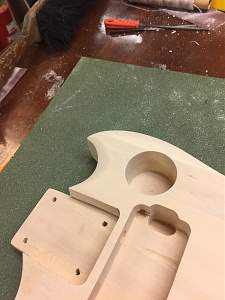

    Here's some pics of todays work, so far. I might work on it a bit more. Its kinda addicted.....

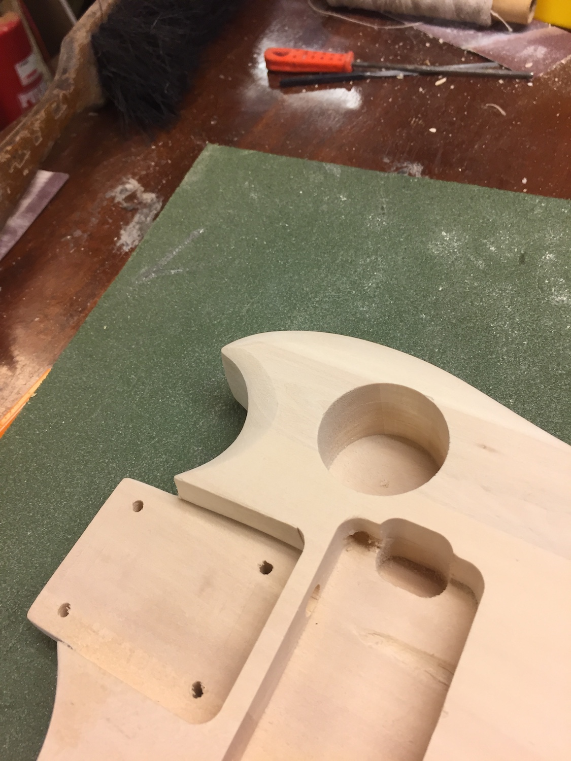

    Ive reshaped the body a bit as i thought that the "fades" at the horns looked a little strange, i made em a bit more "faded" and i also reshaped the cutaway abit on the lower horn to get better access to the higher frets.
    It doesnt show up that obvious on the pic but iv sharpend the edges around the fades
    Here's a pic showing the lower horn.

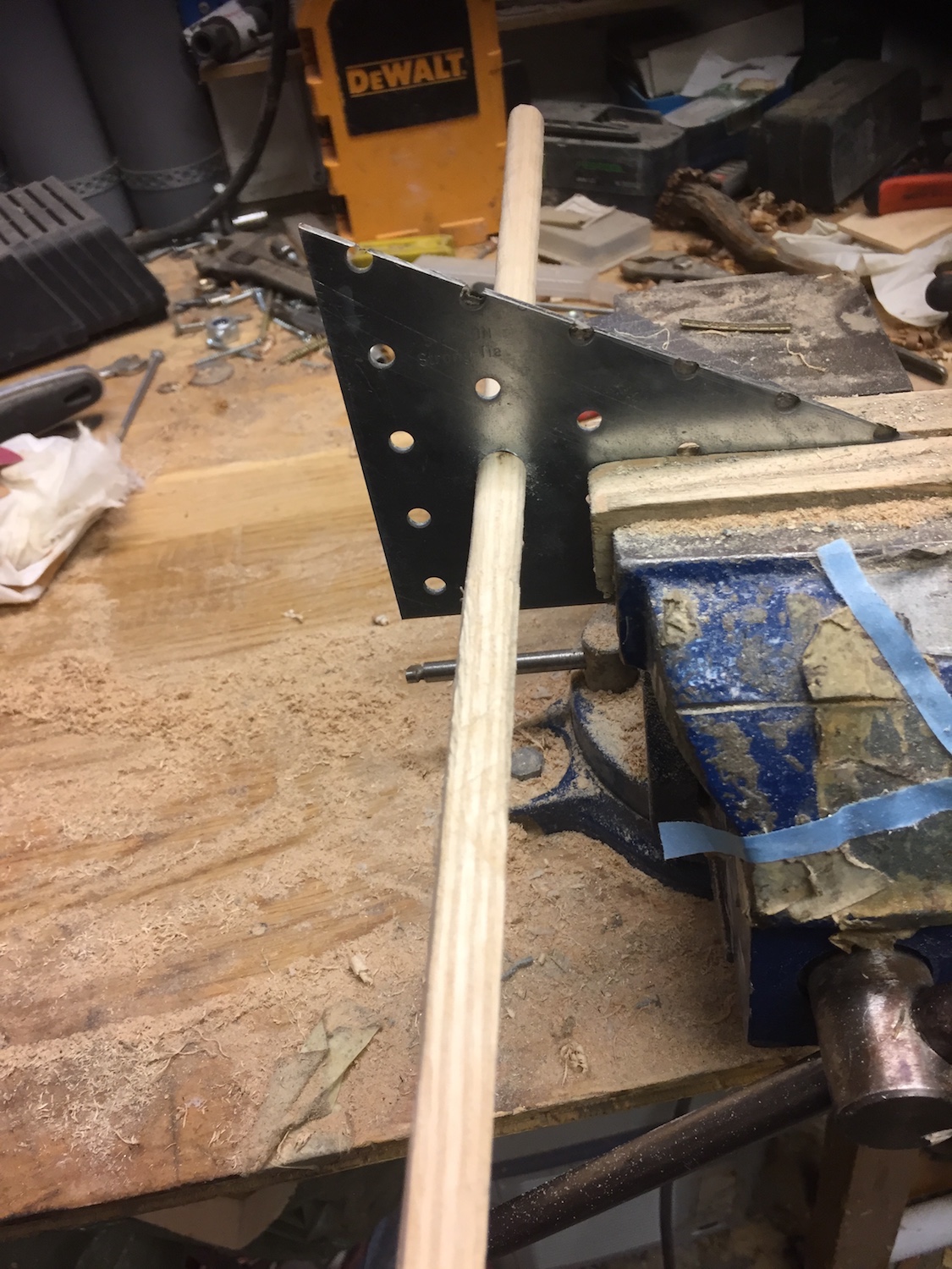

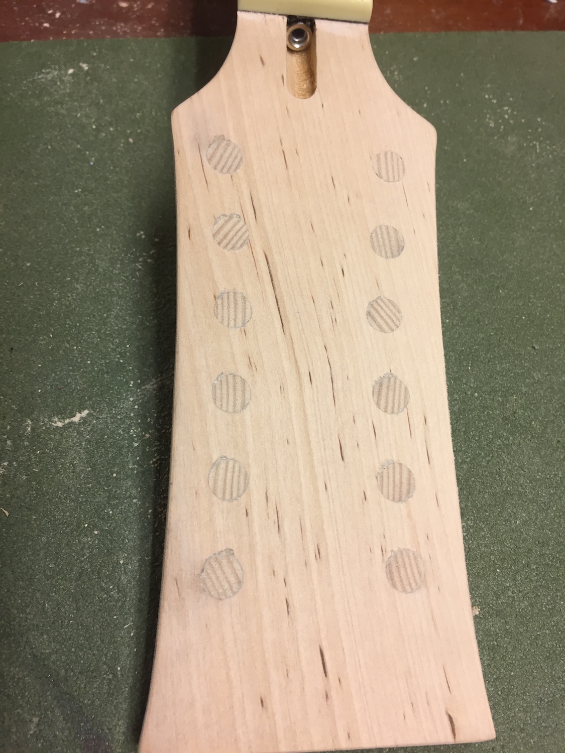

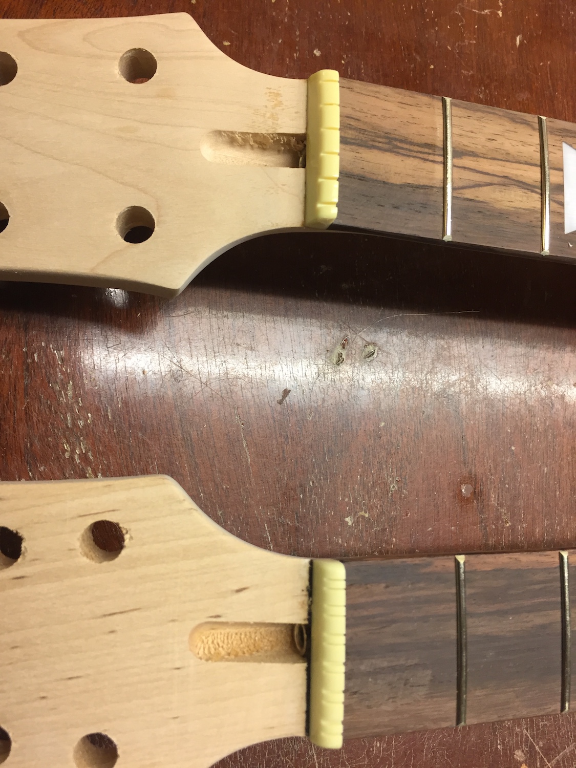

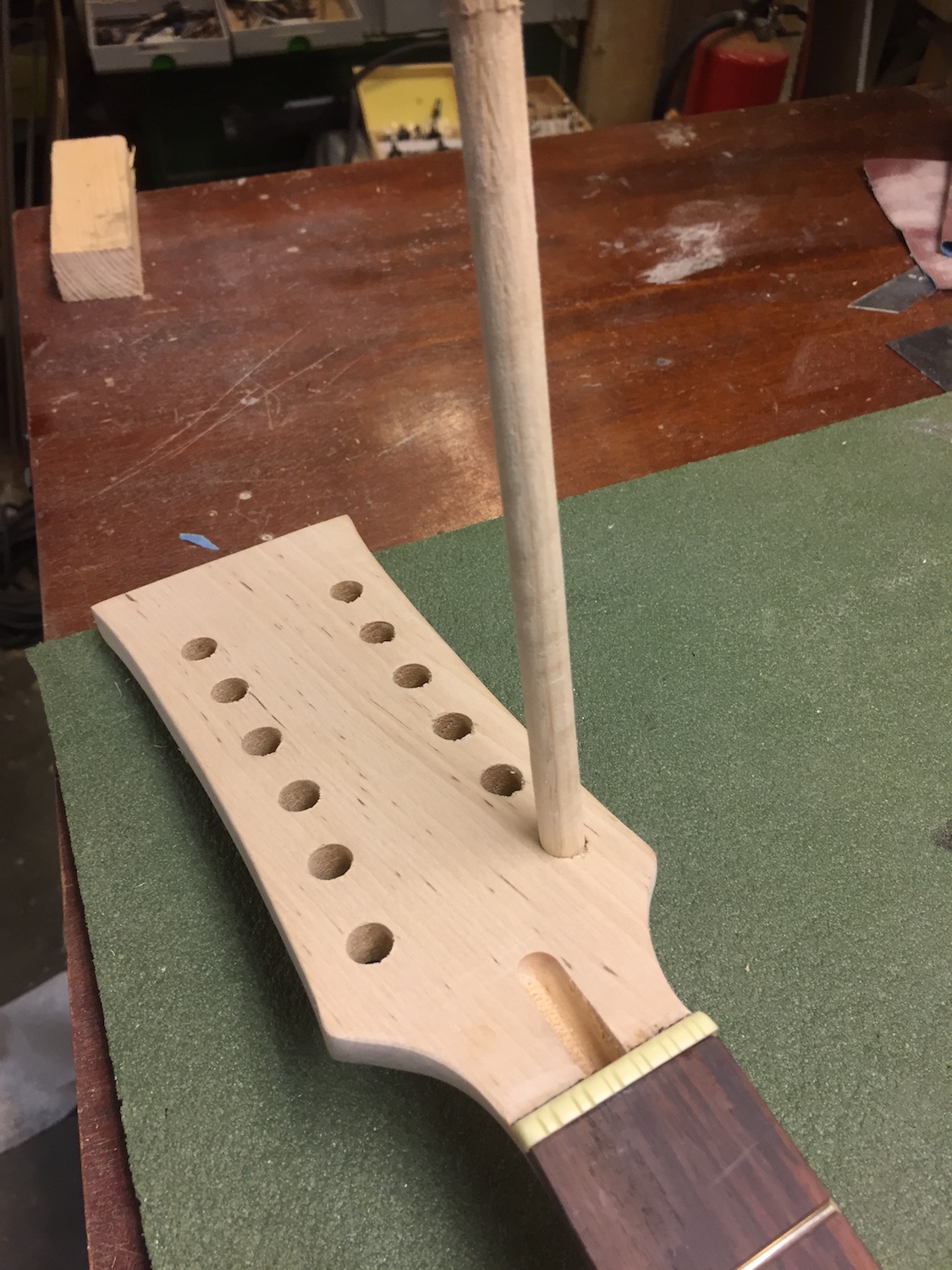

    While i was looking at the headstock of the 12 string neck i realized that the headstock looked enormous as the turnerholes was to far away from eachother, so i thought that i should try to place them i lill bit closer to eachother and therefore be able to make the headstock smaller.
    I started to prep some ash that i had lying around to make some plugs for the existing holes.
    I drilled a hole in some metal i had that matched the diameter of the turnerholes (10,5mm) and then started to push the wood through it
    Then i glued it in place
    i didnt cared much to get the grain matched as im planning on painting the headstock later on.
    Here's the result after some sanding.
