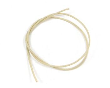

    Hi Brokin, Tonerider have more PUP's to pick from when compared to Entwistle but they do cost a little bit more. Most come with 4 wire, same as Entwistle which allows for coil splitting and other funky wiring options.
    As for upgrading wiring, I think most folks are referring to electronic components such as pots & caps, switches, and also using cloth covered wire as found on the PBG store site. I have used the wire on a couple of builds and tempted to re-wire everything with it as it is such a better grade of wire and so easy to use.
    https://www.pitbullguitars.com/shop/...e-black-500mm/
    https://www.pitbullguitars.com/shop/...e-white-500mm/
